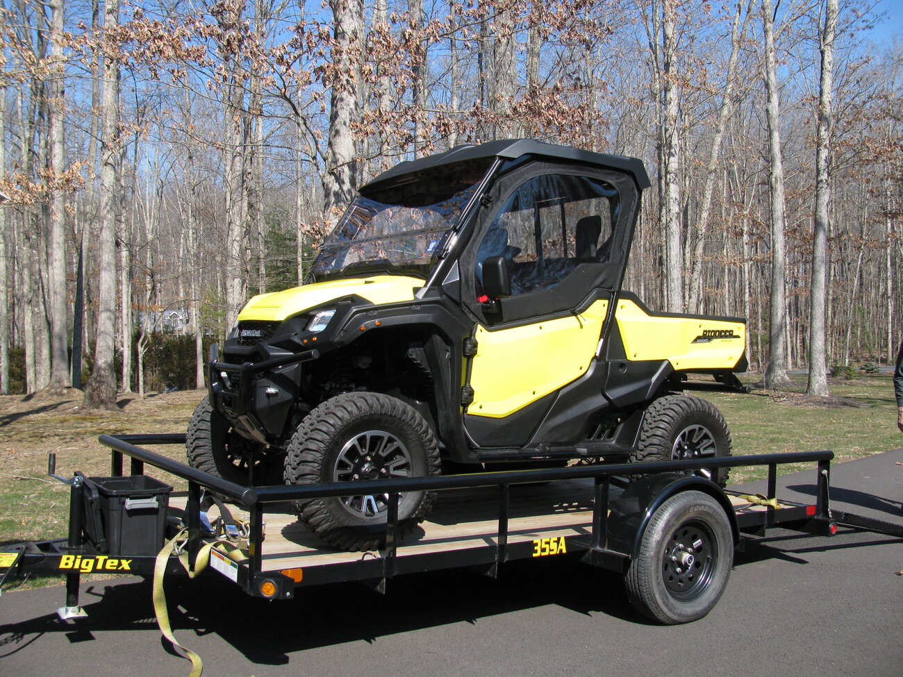

2021 Pioneer 1000-3 base with OEM LE wheels. Tires are 28x10x14
Tensor Regulators with 1" spacers on the rears. Perfect fit, tires do not touch body.

My machine is a 2021 1000-3 deluxe with stock OEM wheels, I assume the wheel offsets are the same as the LE wheels ?? I like the idea of using stock wheels for the cost savings and staying with the 14" wheel since i already have a front wheel and tire for a spare. I would imagine that the sidewall on the rears is a little straighter than the fronts due to a slightly wider wheel ??

OEM LE wheels are the same size as OEM steel wheels as far as I know. I didn't have any reason to measure them. Likewise, I didn't measure and compare front and rear wheel widths. The rears may be slightly wider.

My wheels are aluminum on my deluxe, but yes i'm sure they are identical to your's. Again, i like the idea of running LT tires on stock wheels for the cost savings. Thanks for the pic of your machine ....

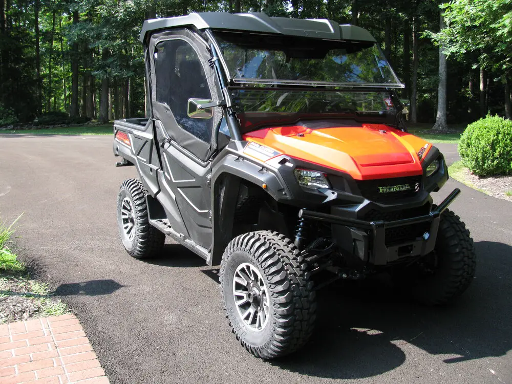

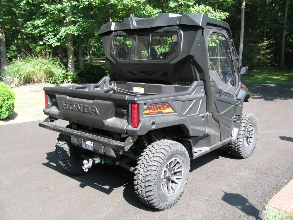

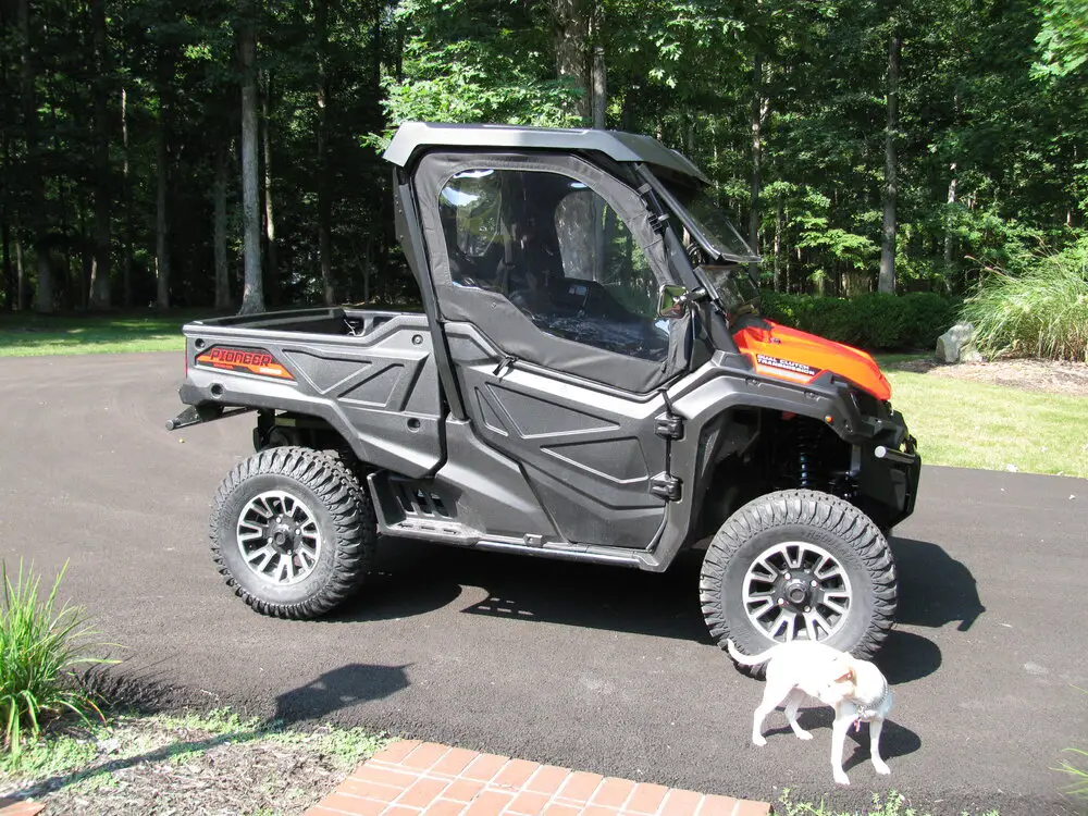

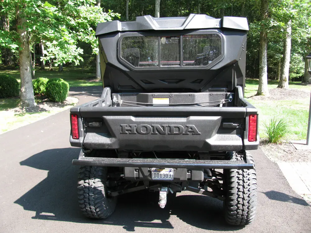

I recently installed a set of four 28 x 10 x 14 Tensor Regulators on Honda LE wheels with 1" spacers at the rear on a 2021 Pioneer 1000-3 base model. Tires do not contact anything but the road surface. I'm completely satisfied with the tires and wheels. Comparing the noise level to the oem tires these Tensors are silent.

Hey there, did you install the rear bumper yourself? Just wondering if the brackets that hold it on are removable, and if you can buy them separately? I have the same bumper it no brackets ( got it off a friend) thanx.
Yes, I installed it myself but it's been almost five years and I don't recall the details. I do remember removing the dump bed hinges during the installation.
If you can locate the Honda accessory rear bumper parts break-down sketch you can probably find the answer you seek.
Edit:
Another thought: I remember removing the dump bed support brackets but don't remember now if it was to replace them or if I reinstalled them after doing something else.
