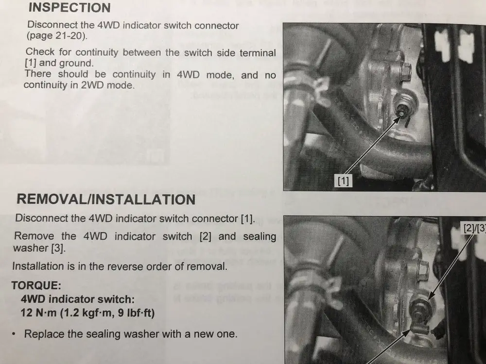

Okay Everyone the pic is my new ride. Really need your ideas on what triggers the 4wd indication on the display. I’ve checked the cable attachment on both ends and everything functions normal. Adjustment appears correct and both 2wd and 4wd function is normal. The manual says that when the handle is in 2wd, the “4wd” indicator should be off. Mine remains illuminated. My thought is the switch/trigger for the light is stuck,however I can’t find it.
Please respond if you all have any ideas.
Thanks

1 0Number 3.

Thank you so much...
So I guess they built mine on Friday at quitting time. The switch was never wired up at all. I found the wire stuffed in one of the holes for the attachment pin in the forward floor pan. Wedged it out, fixed the socket and attached it to the switch. Now it works great! I couldn't have done it without your schematic...Thanks again
