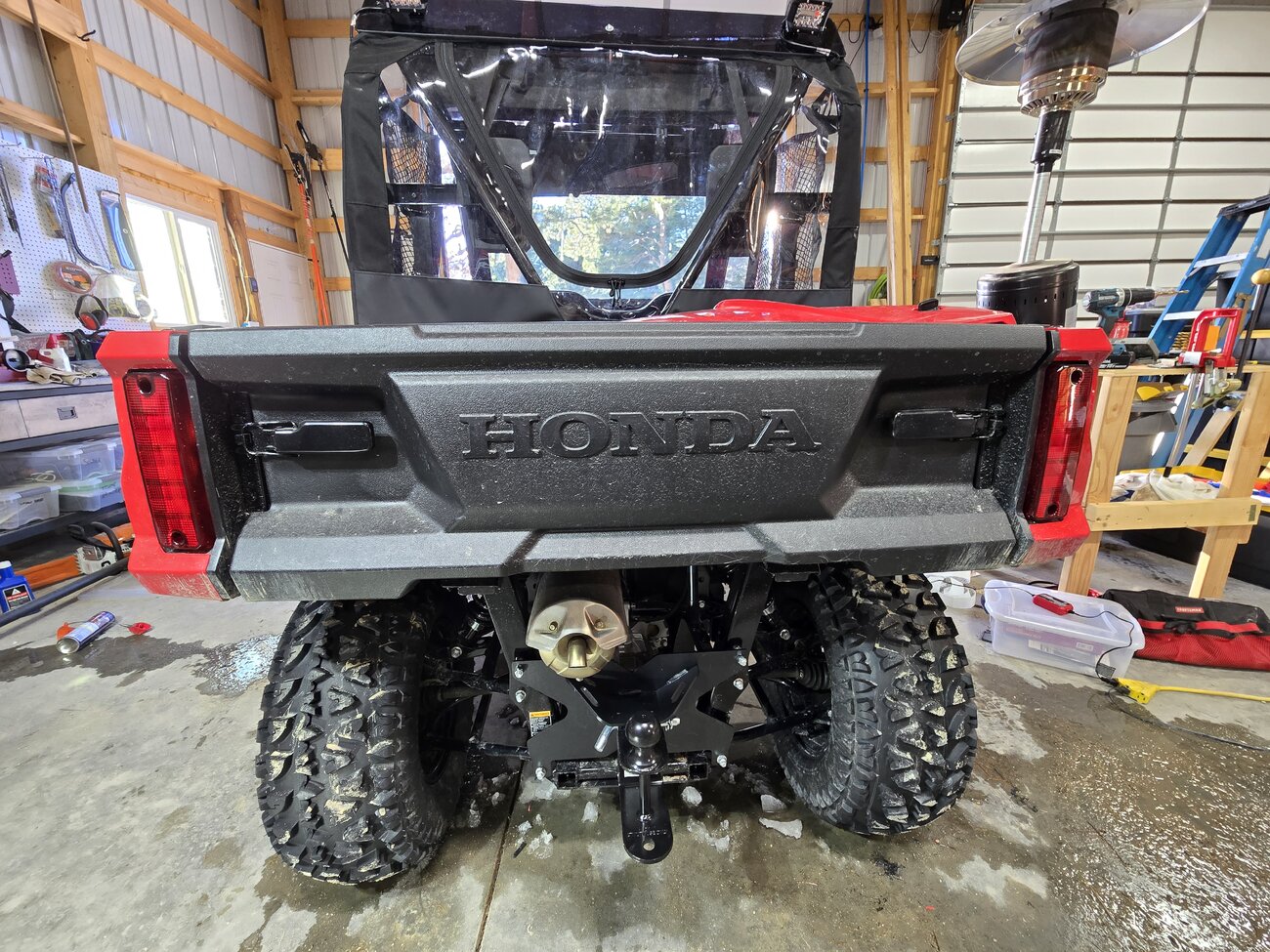

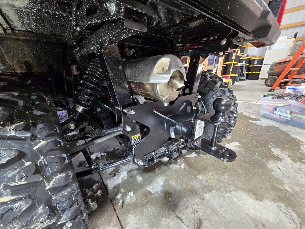

Moose 4504-0332 fits perfectly on my 2025 Pioneer 520 with no adjustments! The Moose 2" Install was awesome. Only wrinkle was the kit did not have the lower spacers needed to properly align the hitch, but stacks of washers do the trick, and I feel justified in keeping my bunches of old hardware around :) Quick and easy mod and I put this on the receiver: https://www.amazon.com/gp/product/B07BMZ3PXD?tag=sxsweb24-20 . Thanks all
