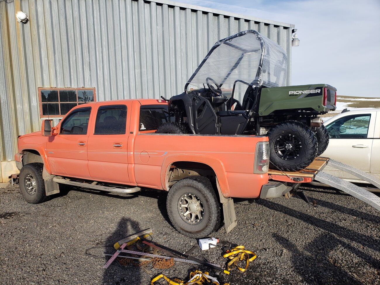

My 520 is running 27x9r12 in the front and 27x11r12 on 5+2 wheels. Measures about 52-53 wide in the front. The wheel wells on my silverado are 50 apart l. When loading it tries to drive over the wells then slips down between when the weight gets heavy enough. Loads easily. I can a piece of plywood that fits around the wheel wells and covers the tailgate when its down. I have a 6'6" box. I have a 6 inch lift and 35s. The ramps i have are curved and hinge in the middle, longer than normal straight ones. Not sure what brand they are but the extra length and slight curve is really nice with that much pick up height.

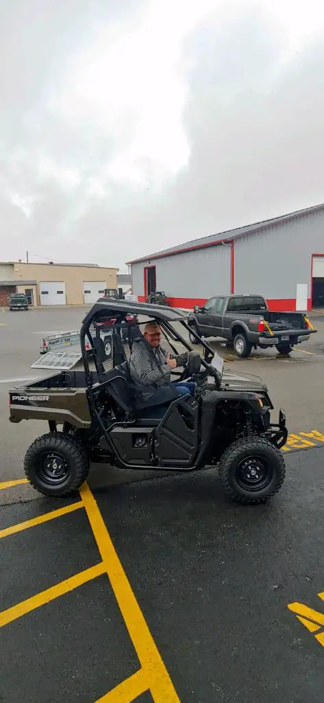

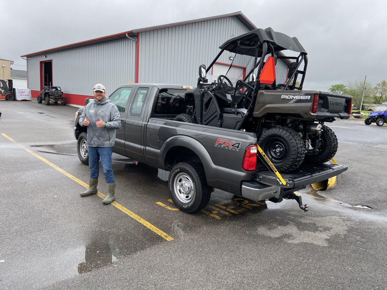

Finally got my unit! Well worth the wait! Thanks again (everyone) for all of the excellent input. Rolled off of the assembly line 4 weeks ago 😁.
View attachment 335809 View attachment 335810
Your tailgate should be ok with those DG tailgate supports and tie downs, wise choice (have some). Are you planning anything for beefing up the front of the truck bed at the P520 front bumper in case of a sudden stop/accident to spread out the forward force (full width 2x 10/12 lumber cross member, heavy tow straps from rear, etc)?

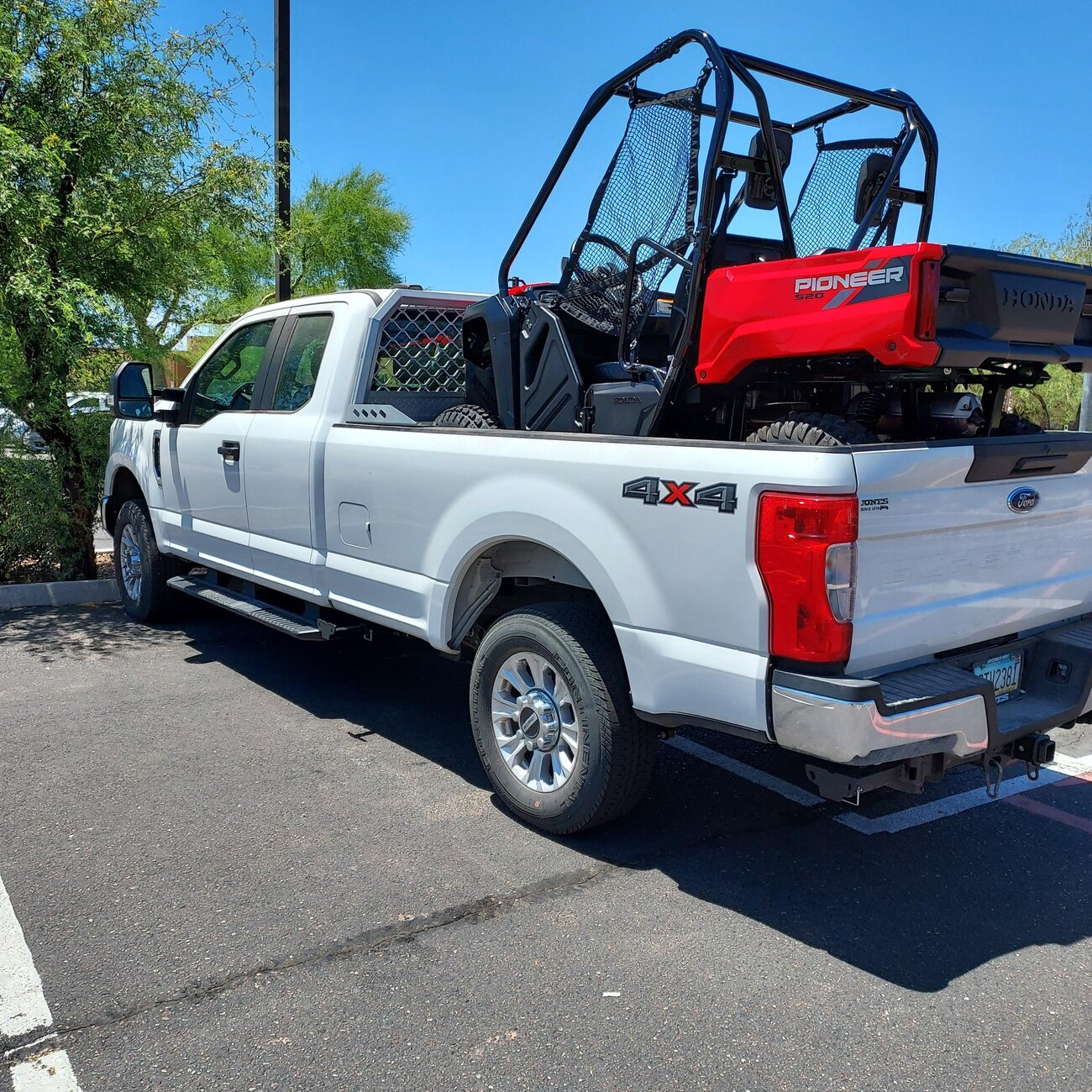

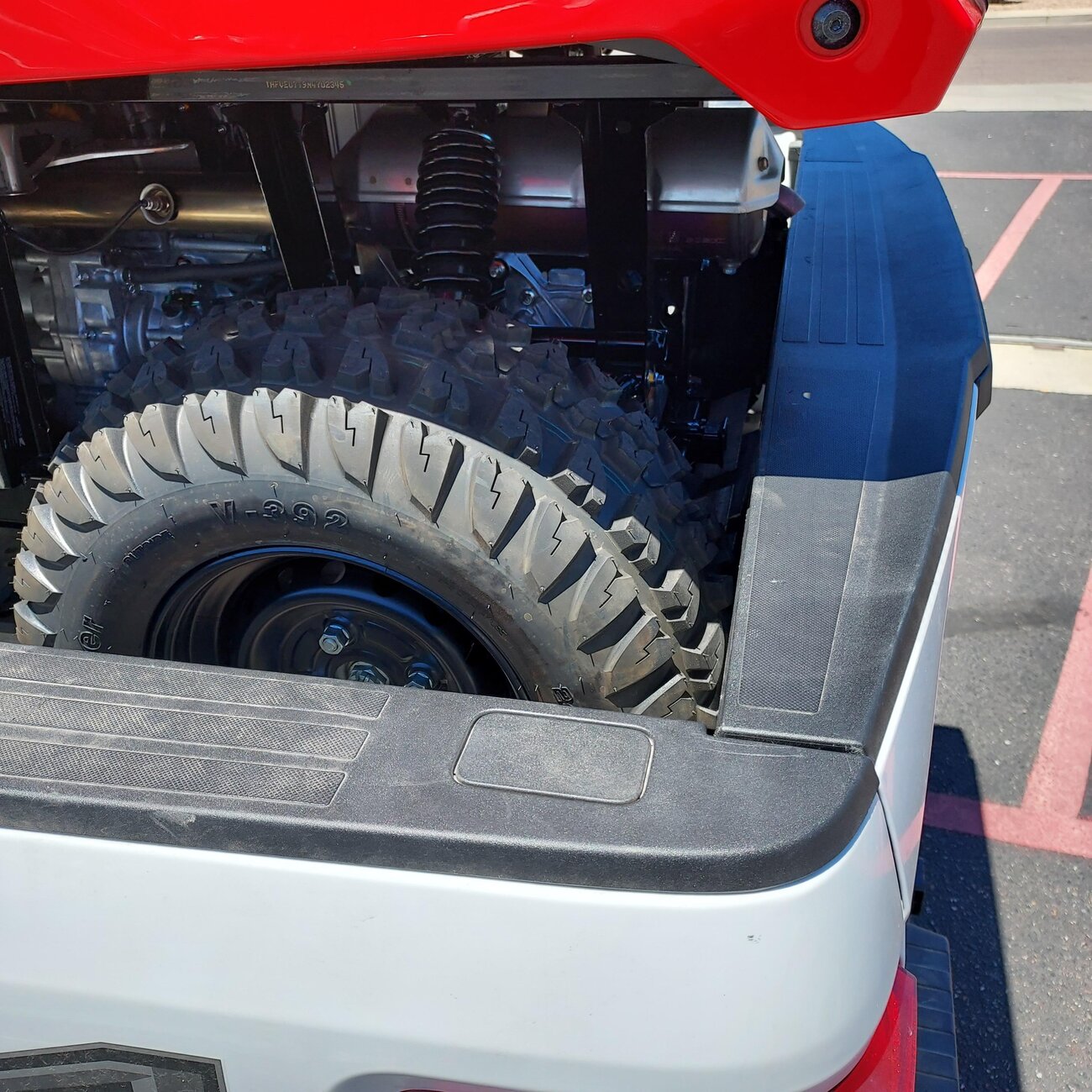

Just bought a 520 for riding our 50 inch trails. The front bumper comes off by taking out 4 bolts. It fits in my 2020 F250. If its tight in other trucks the tires can be set at 3 psi. The factory didn't install the 2 6mm bolts on my Pioneer 520 and also on my Pioneer 500. The frame has the nuts installed so its easy to install the 2 bolts to the back end of the skid plate.
Loaded1
Loaded2
Loaded3

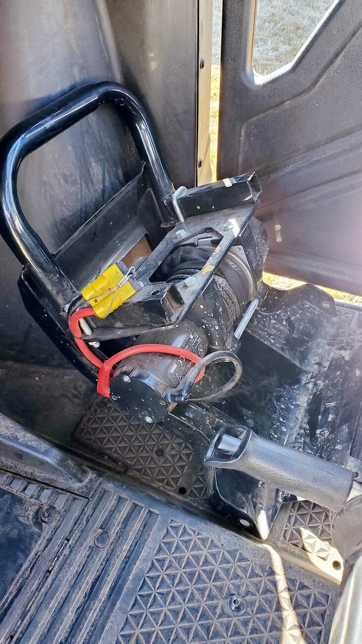

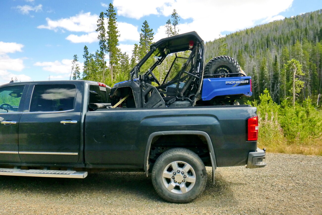

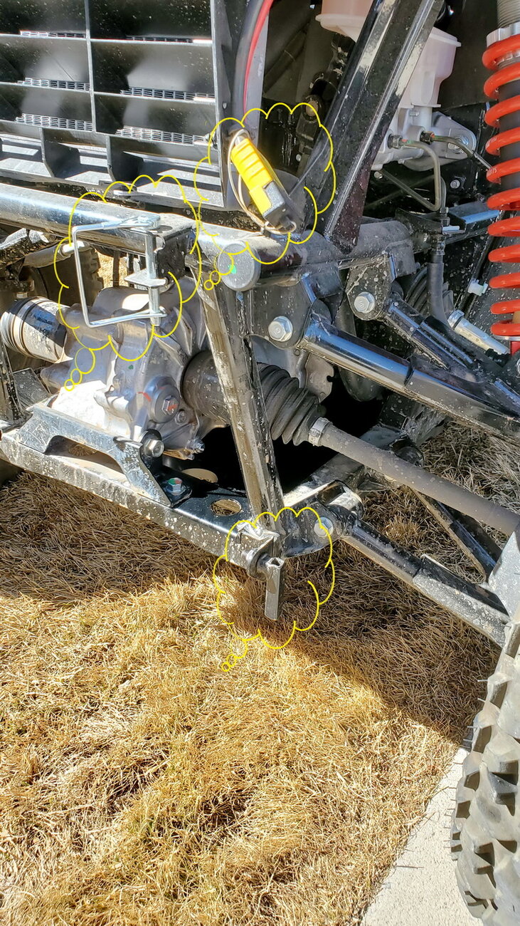

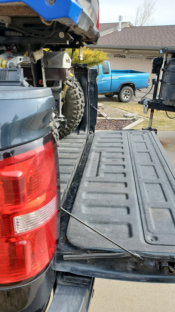

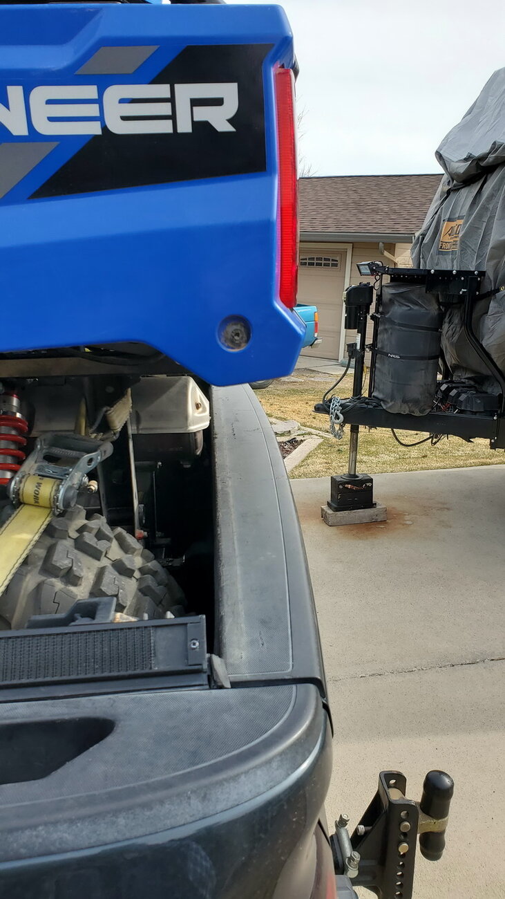

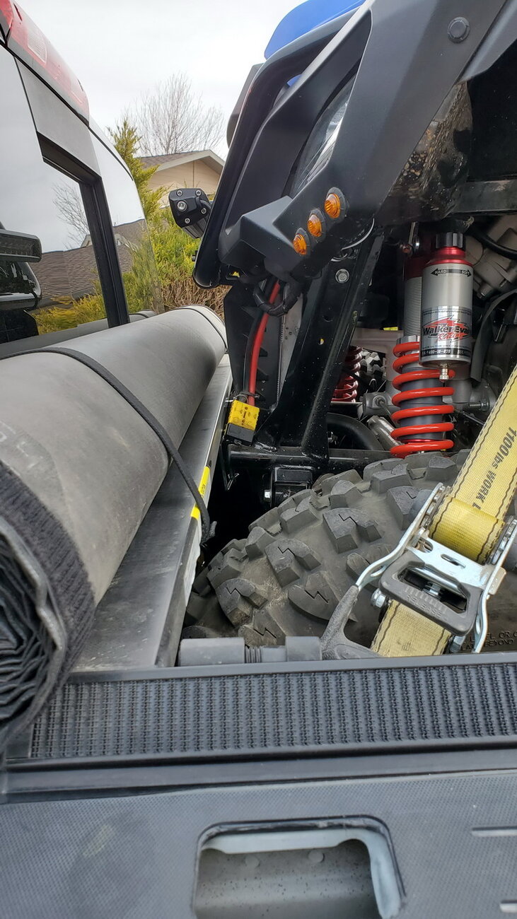

Here is how I haul my 520 in a 2019 GMC 3500HD with an 8 foot box and the tailgate closed so that I can pull my travel trailer. The windshield and roof make a good air deflector over my travel trailer and I get a little better mileage with the Pioneer in the bed. I remove the winch and place it in the cab on the floor of the passenger side. The last photograph shows the pins I use in the upper winch mount and the bolts with handles that I welded for the lower fasteners. I also use a quick disconnect for the power cables and only connect them when needed.
1 Honda 520 in 8 foot GMC box resize 2 Clearance rear GMC 8 foot bed tailgate closed resize 3 Clearance rear GMC 8 foot bed tailgate open resize 4 Clearance front of GMC 8 foot bed resize 5 Winch stowed on passengers side and quick connect cable resize 6 Quick connect cable pin and lower bolt lever edit resize

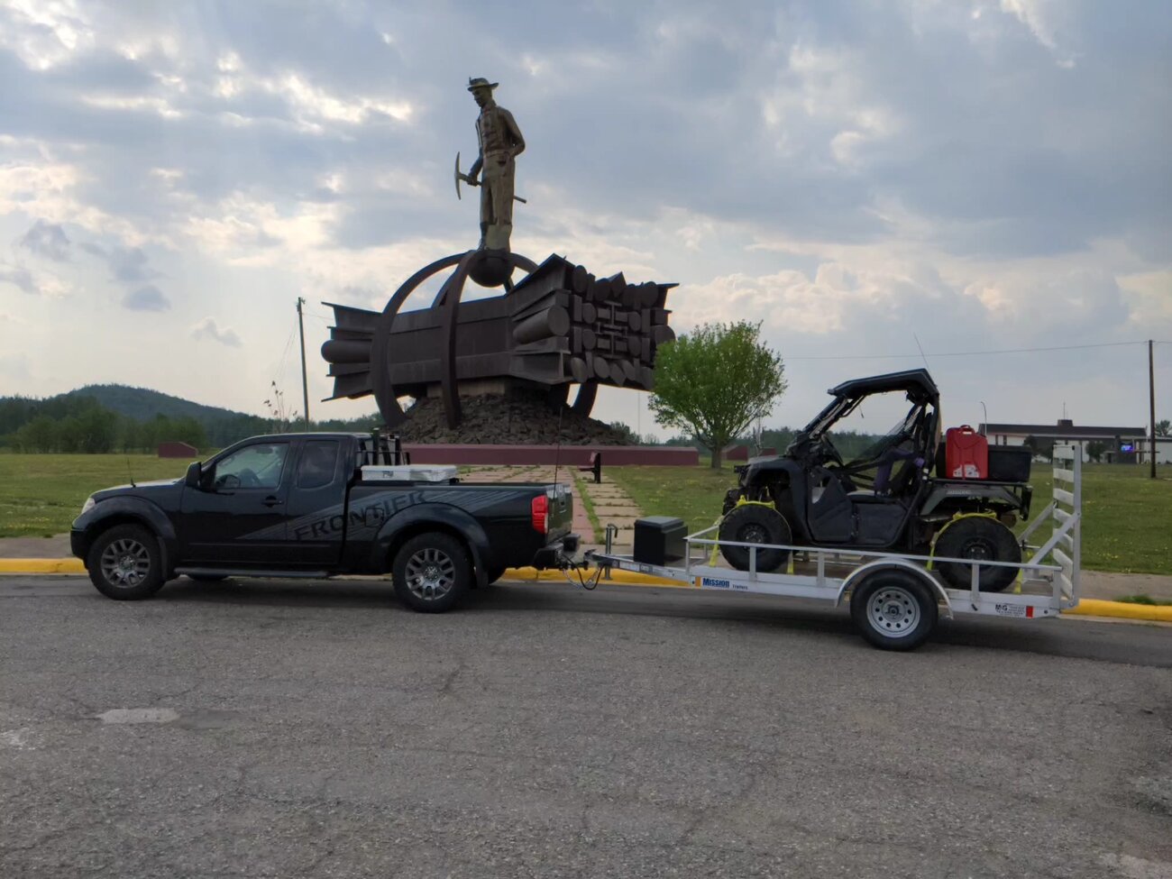

Lol, no worries man.
Year-old post, but just to add a couple points in my defense: It was at the payload limits of the vehicle. I had multiple 5k rated (1600lb break strength) straps on various points of the bed, tie-towns, and vehicle frame itself.
It was as safe as I could make it, the bed itself would have to come loose from the truck for it to go anywhere. Only did it because I had no space or $$ for a proper trailer.
Made 2 round trips, totaling about 600 miles. The rear end sagged just enough to where I would be probably blinding oncoming traffic if I had to drive at night, and it was a massive pain in the rear-end to hook and unhook everything.
The hitch extender came in 2 pcs (rated at over 1000lbs, and it was heavy), 2x10 framework, 8 straps etc. It sucked.
Thankfully we got another stimulus check in, plus I had already started saving for a trailer so was able to make a massive upgrade.
Since then, I've commented several times (here and other forums) against using a mid-size truck to haul in because of those issues.
Please don't apologize for calling out safety issues and concerns like this, and feel free to give a thumbs-up for my current hauling system:
Hey that's @ iron world. Nice setup.
