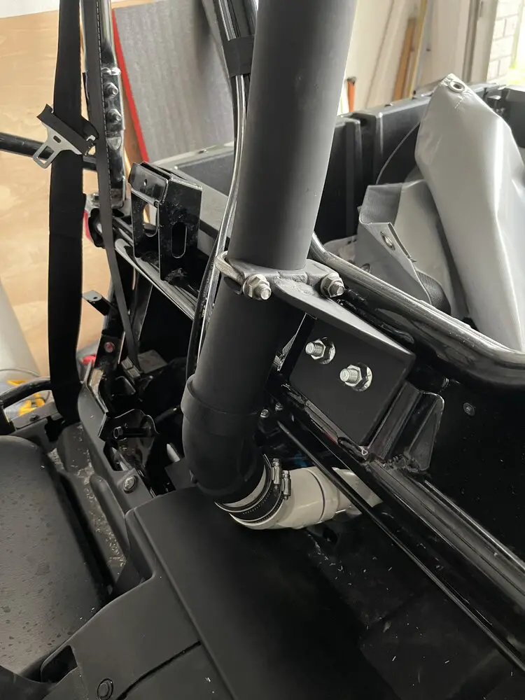

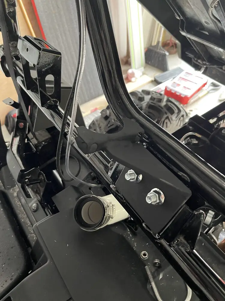

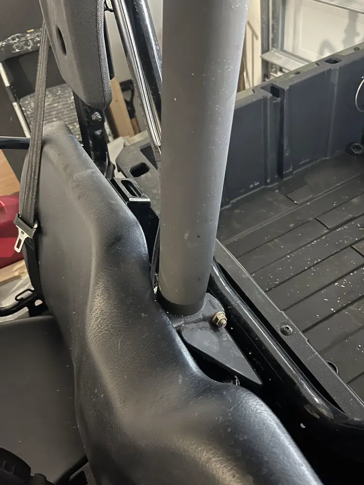

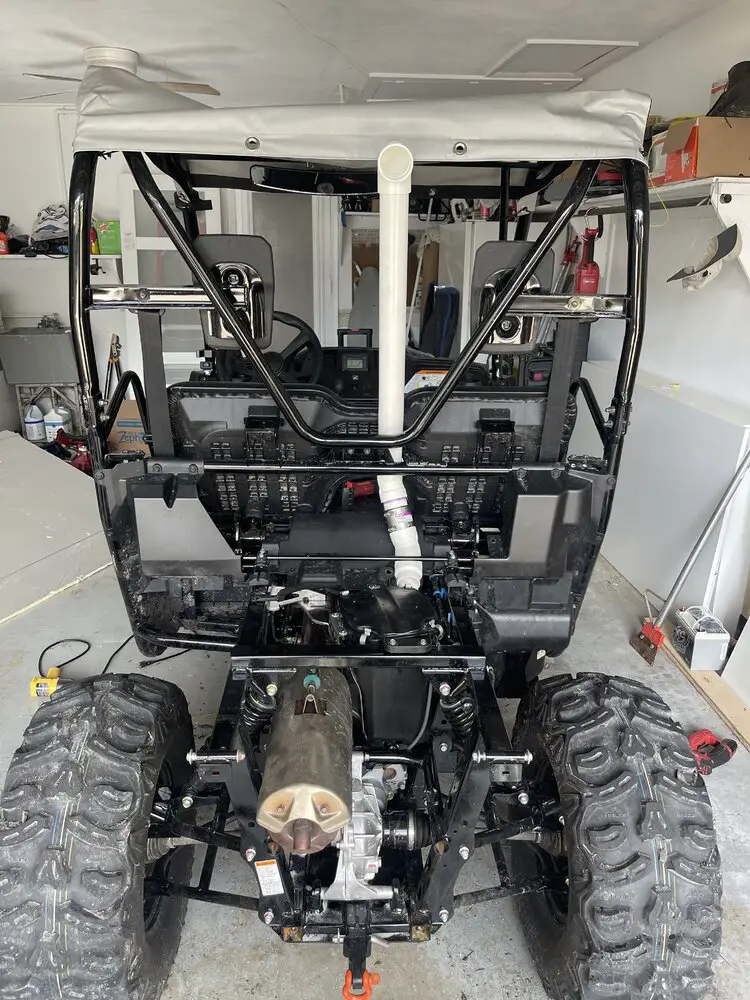

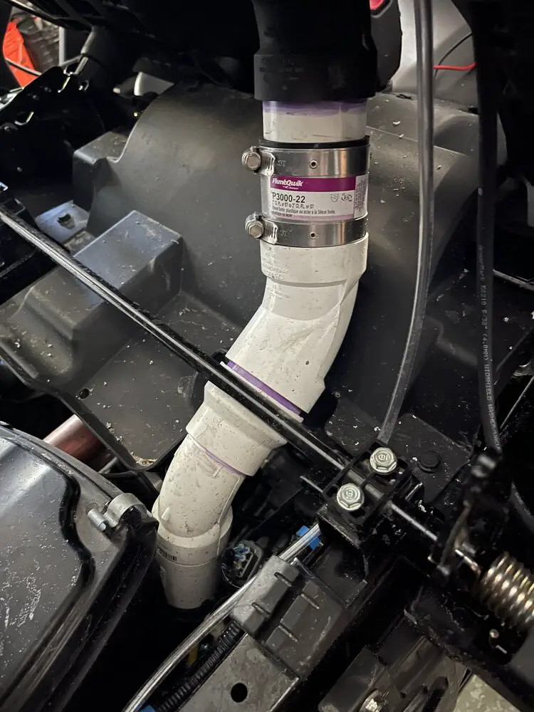

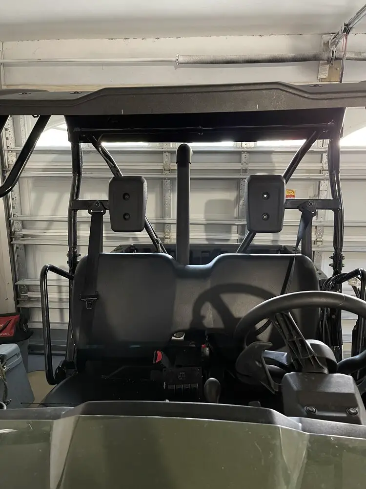

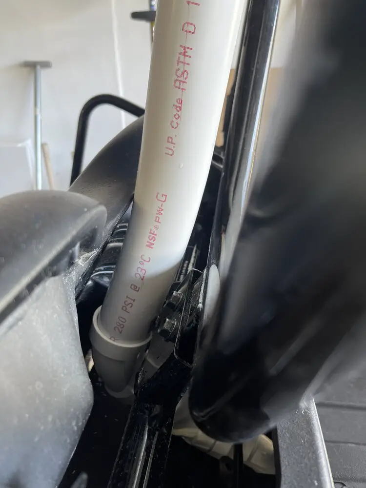

Ok bros just an update...looks like the bed has to be cut and I'm not sure I'm committed to that yet. Gonna let it sit in the garage and ponder on it for a while cause I can't return it. Really wish I would have known that before, but I guess it's a kick in the nuts for me and some knowledge for someone else thinking about it.
So yes I too had that dilemma. Dealer told me the day of purchase, that snorkeling will void warranty.
Location of commercially available snorkel is such that cutting and or drilling is required. That makes it a no go for me. I needed something that can be returned to stock with no sign of previous mod. Turns out the only place to route is the center of seat. Heat gun to make the final angle of riser pleasing to the eye is required. Attached with a muffler clamp welded to a piece of 3” angle.
Pics below. Something to consider if warranty is a concern.
View attachment 278152 View attachment 278153 View attachment 278154 View attachment 278155 View attachment 278156 View attachment 278157 View attachment 278158
Thanks for the idea and taking the time to respond and post the pics - I might try to see if I can make that work with the pieces in the kit. I really am not wanting to cut the bed for sure
