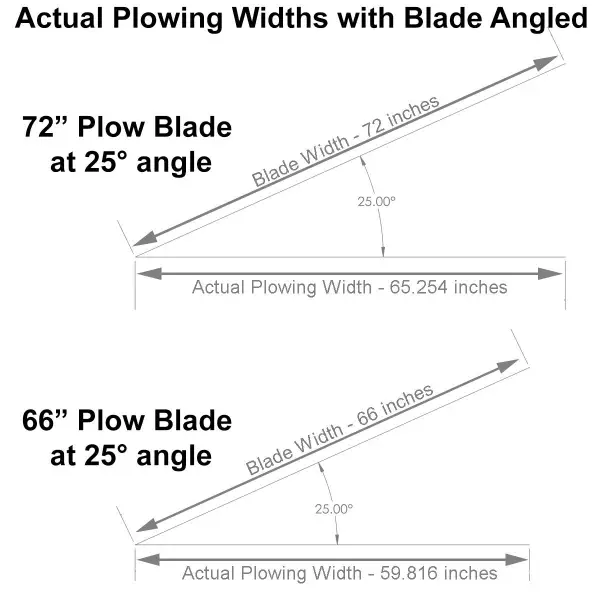

I'm looking to take advantage of the sale on honda sxs club store and get my Denali plow blade. I don't have the biggest driveway and garage space is always a premium. Has anyone tried the 66" blade size on a P1K5 and if so what are your thoughts? If it causes issues then ill just have to find a place to store the 72" but wanted to get any thoughts first. Thanks!
18,227
65,193
I do recomend the 72. But the 66 is fine on a stock width machine.
While I say 66. At full tilt it has a 59 wide push path.
Stock pioneer 1000 is 63 wide.
So you will have 2 inches each side of tire scrub when full tilt.
Or just don't go full 25 degs.
And honestly. Might not be a big deal. Really. It would only be one side as the opposite side would already been pushed. Assuming.
That's a good point. Assuming I'm wind rowing, after the first pass it only scrubs on one side. And being in the midwest snow is usually a few inches, not feet.

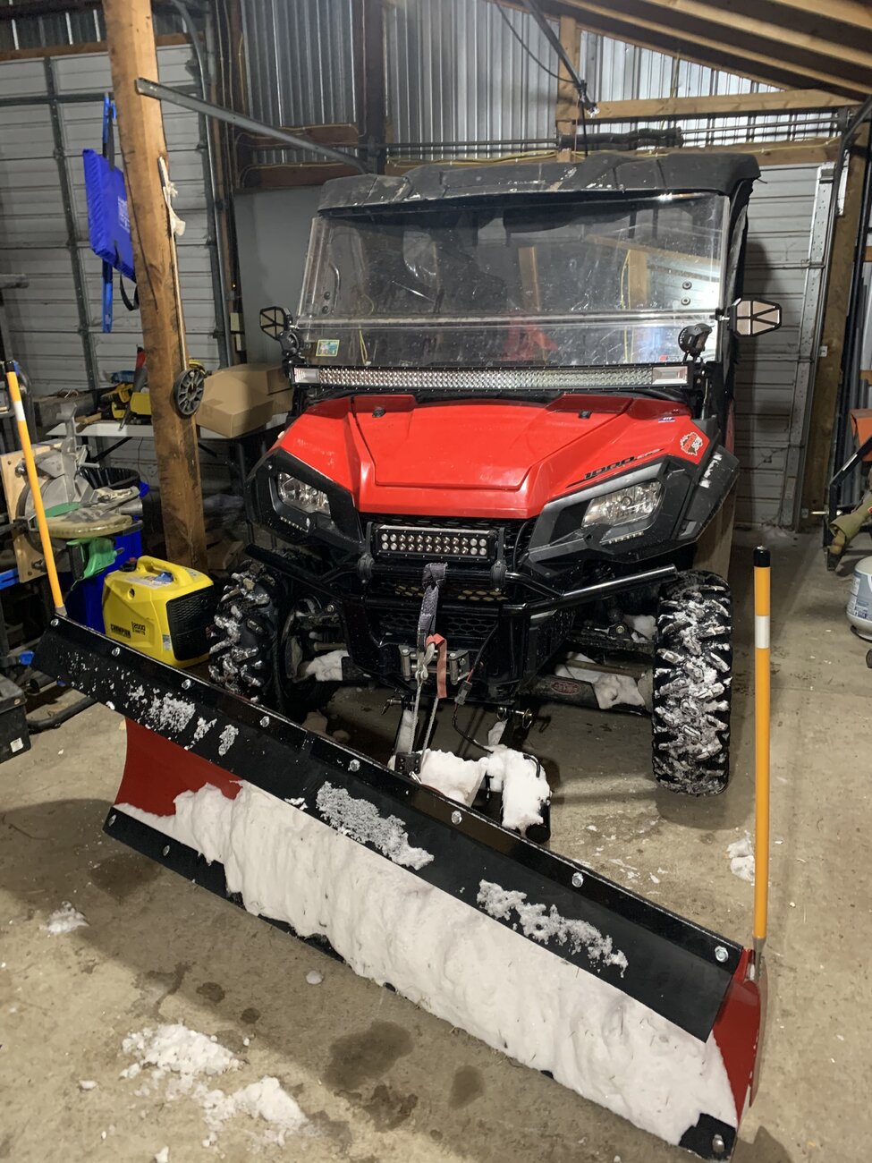

I attached a 66" and it just didn't seem wide enough - especially, as above, when angled.
I built a dolly to move it around and to help line up the pins.
In the summer I flip it up on the dolly and move it out of the way.
View
