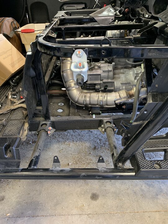

I needed more storage room and wanted to install a second battery in my 2018 Pioneer 700-4. I removed the seat tray and driver's side cover to expose the area under the seat.

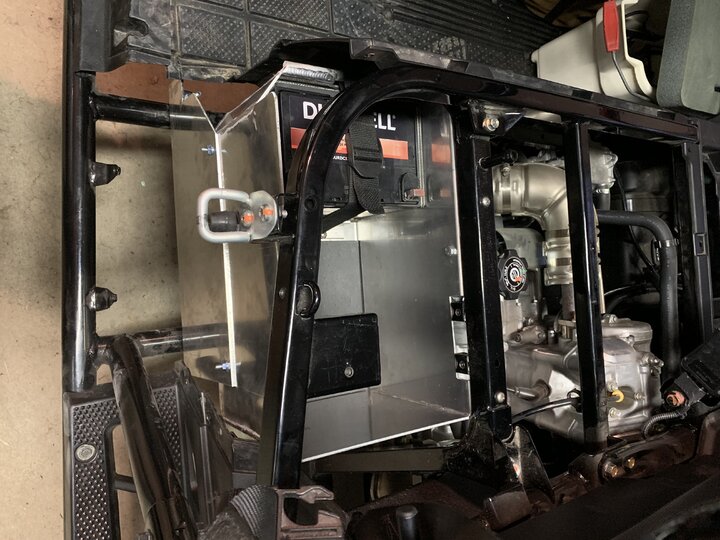

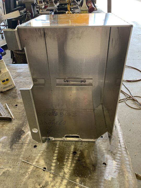

I constructed an aluminum box to fit within the area. The box measured 9" x 9" x 16" with a 1" lip on the inboard side. A notch had to be cut on the inboard side and lip to clear the factory Oil Fill tube mounts.

A short piece of 1" aluminum angle was mounted inside of the box to secure the bottom of the battery from sliding. I salvaged an old boat battery strap to hold the battery upright. In addition, the left front corner of the box was cut at a 45* angle to match the curvature of the seat. This angle was adjusted to meet the width of the battery. The lip on the top of the box was bolted under the seat brace on the inboard side with 2 bolts. To secure the box to the lower frame, another piece of aluminum was bent into an "L" shape 7" tall with a 2" base. The box was then leveled and secured on the outer side using the 7" x 2" L bracket and 2 more bolts. Two "U" bolts secure the "L" bracket to the frame.

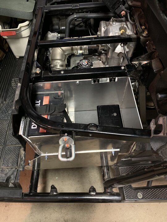

I flipped the Oil Fill tube to the other side of it's original mount to gain more room. I installed a heat reflective cover on the rubber oil fill tube to protect it from excessive engine heat. There is still an ample air gap between the box and the engine/exhaust. I insulated the outside of the box, by the exhaust, with insulated self stick matting to reduce engine heat. So far, excessive heat build up hasn't been a problem.

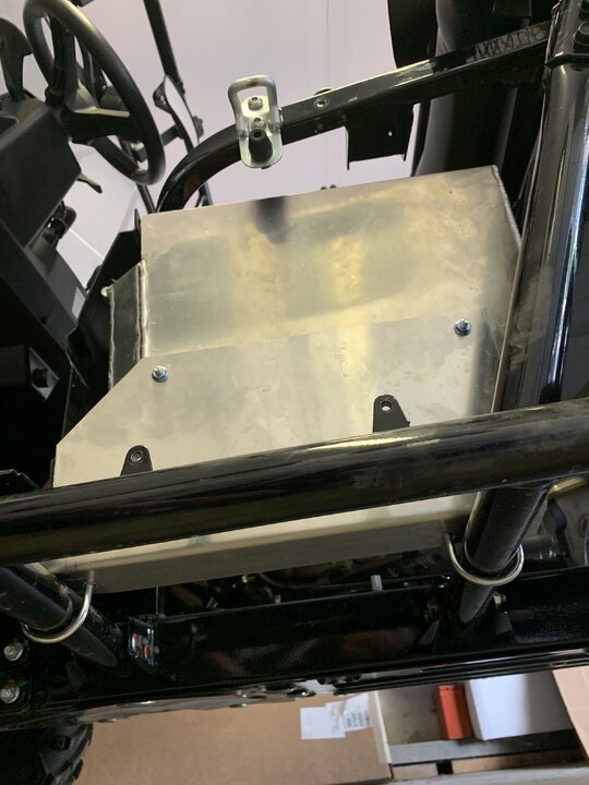

In addition, I surrounded the battery with rubber belting to prevent electrical problems and any damage. I'll post the electrical hookup in a future post.

I used a flexible piece of Kydex type material for the divider between the battery and the storage area. It allows easier access to the battery, but still protects it. I also used the same material for a lid/cover. I did not install a drain in the box. I do like that idea .
