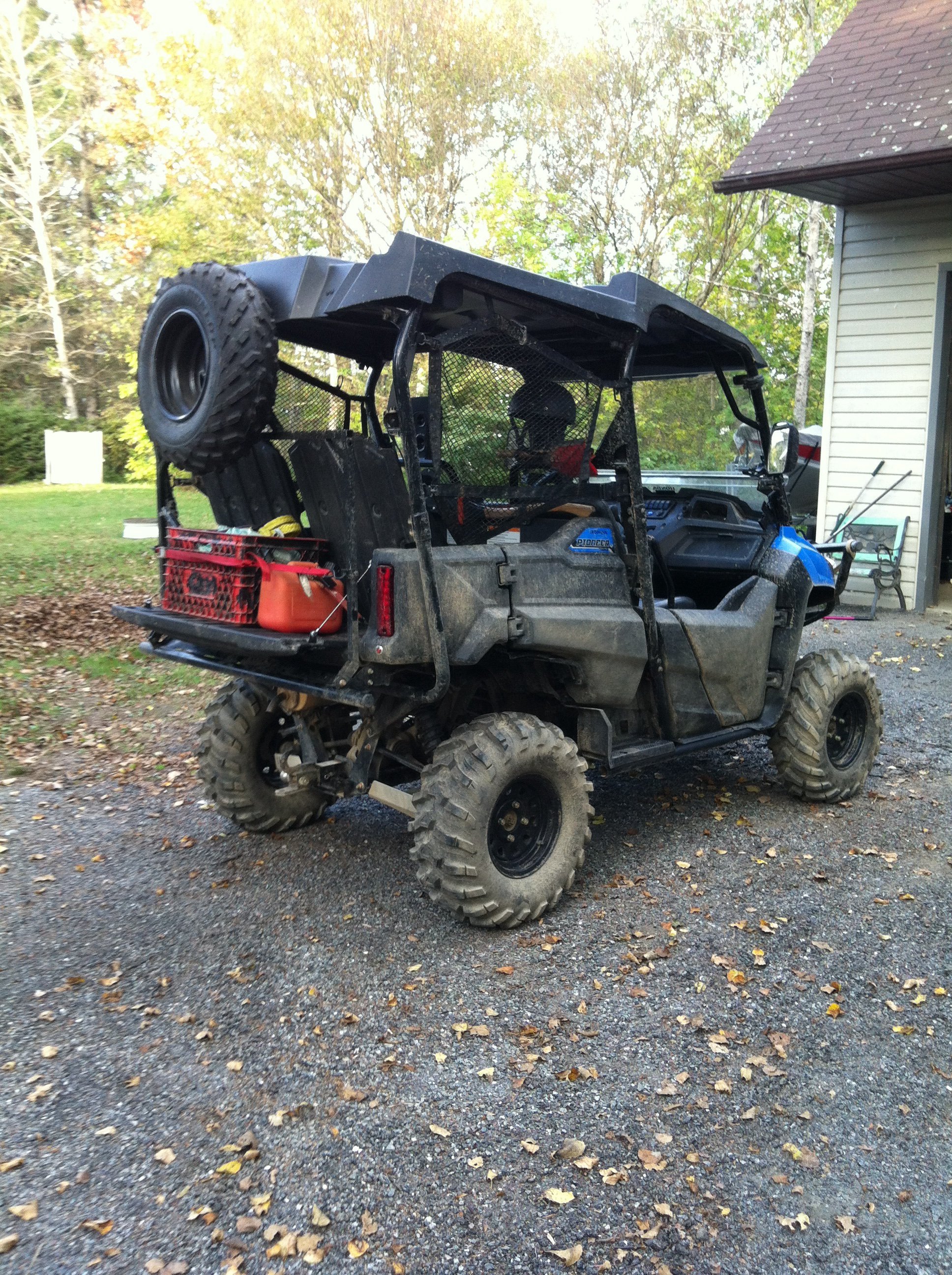

Good lookn rig how did you mount the spare
thanks ,made it from scarp pices I had around , its mounted to the bumper and its pined to a clamp at the top ,it folds down and un pins to come off the utv , the tire is held on with a bolt and safety clip ,a pice of pipe the same size as the center hub holds the weight
