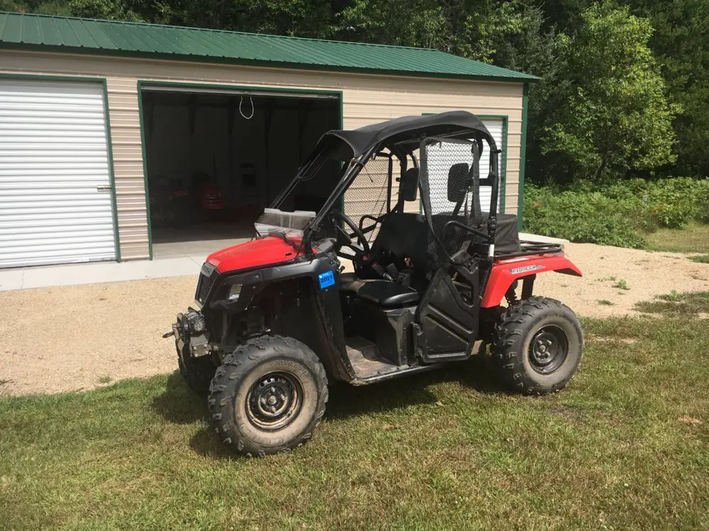

I found what worked best for me was a 1/2 windshield, Bimini top and no back window... cut my dust way down, when I had a solid front window on as I do in the winter, it sucks the dust in and a back window made it worse
I roll like this in the summer
Correction... when the wife comes I ride the pioneer that way, otherwise I’ll ride this!
