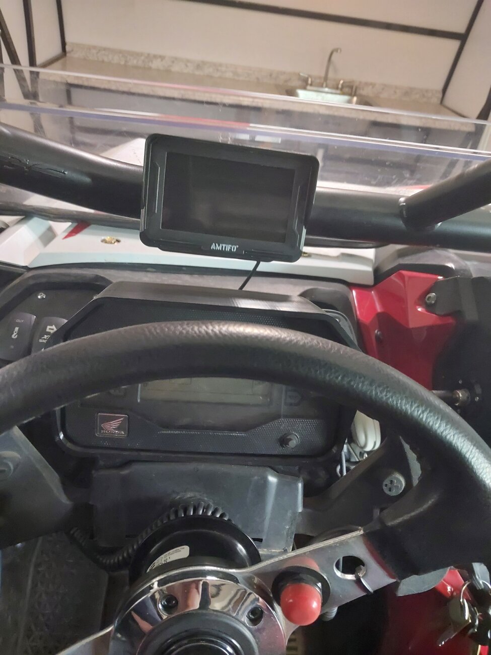

I installed a AMTIFO 4.3" Amazo. Backup camera on my 2021 R and it works great. Wired it to the reverse harness along with the LED backup lights. I used it for the first time 2 days ago at the CrossBar Ranch. SO helpful when backing up in tight quarters. And only 39.95 to boot.

What did you use for a harness?

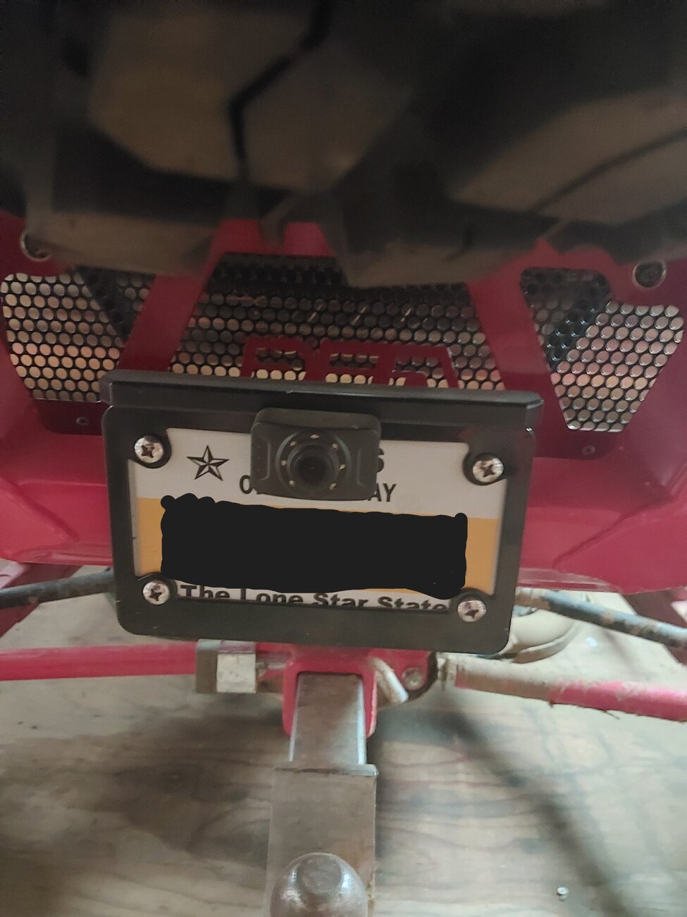

This one, the club store shows sold out but there should be others available. The one I have gives you a reverse activated ground not power. I had to use it to ground a relay that supplied the power to the back up lights on the chase bar and to activate the back up camera. I used a Axia Alloys clamp to mount it to the dashboard bar on the roll cage.

@ScottJ24 What's your feeling about having the camera that low? It seems like you would get a much better angle for backing up vs the roof mount but do you need to clean it off every time you want to back up?
It works just fine for me. With the spare tire mounted it limits the vision with just mirrors. Also this old neck doesn't turn as far as it used to so there's that.
