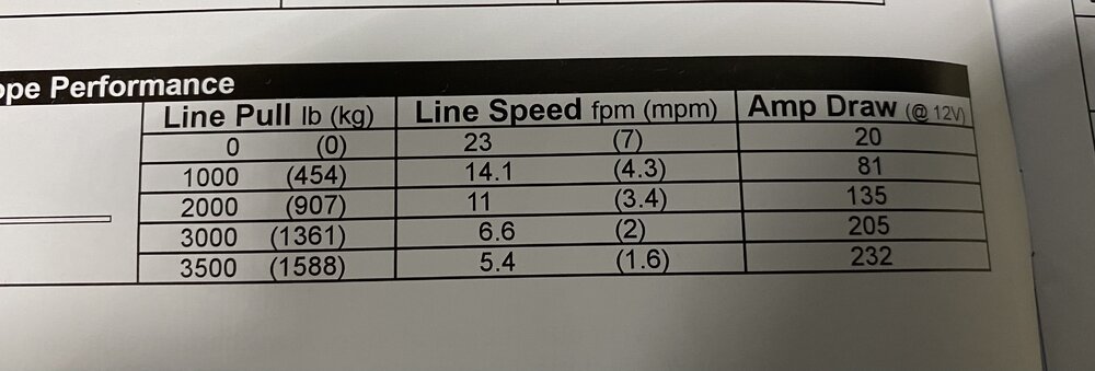

Here’s what I could find in the manual showing the amps. So what size breaker would I need 200? View attachment 282124
I'd suggest a higher amp circuit breaker than 200 for the draw you've shown. You don't want to keep kicking the breaker if it's not at maximum draw. If something starts shorting out or getting too hot it'll still trip with a 250.
