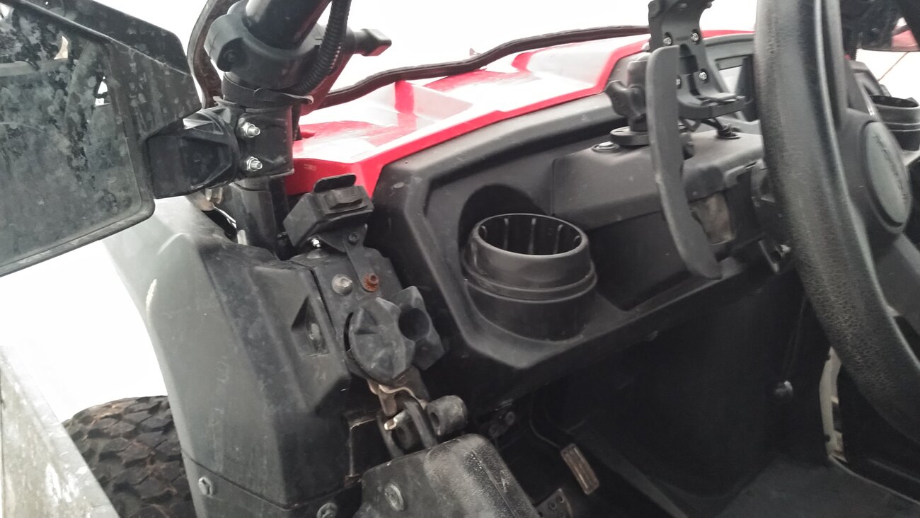

DaddyDubbs Well-Known Member Lifetime Member Nov 19, 2016 13,794 128,832 113 Lee County Alabama, from Southern Michigan Ownership 500 Aug 4, 2022 #9 Mounted mine below cup holder to access inside or out of cab. Remote plug is just to the right of switch. Reactions: KYhillbilly, trigger and Yomama101
