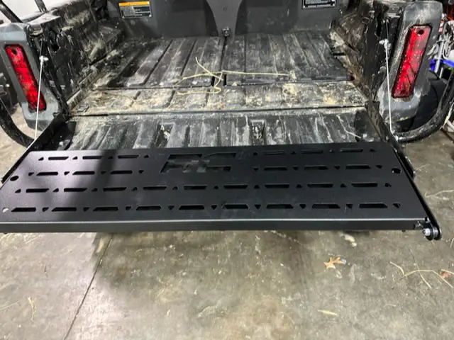

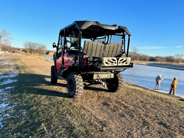

Just purchased and installed the Kemimoto bed extender. And while it folds down you still cant shut the tailgate and have the seats up. During install you have to remove the tailgate briefly. The instructions suck but if you remove the inner rear panel on the driver side you can slide the rear out enough to remove the tailgate. PIA to install but works and looks great. Mine is a 2022

Just purchased and installed the Kemimoto bed extender. And while it folds down you still cant shut the tailgate and have the seats up. During install you have to remove the tailgate briefly. The instructions suck but if you remove the inner rear panel on the driver side you can slide the rear out enough to remove the tailgate. PIA to install but works and looks great. Mine is a 2022 View attachment 367741View attachment 367742
Thanks for the pics and info!

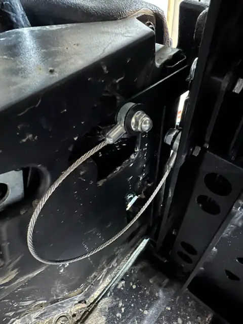

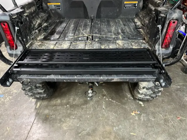

Finally got around to installing the Rough Country bed extender. Overall I think I’ll be happy with it. The directions were a bit vague in some areas and the hardware call outs were not 100% correct but I got it figured out.

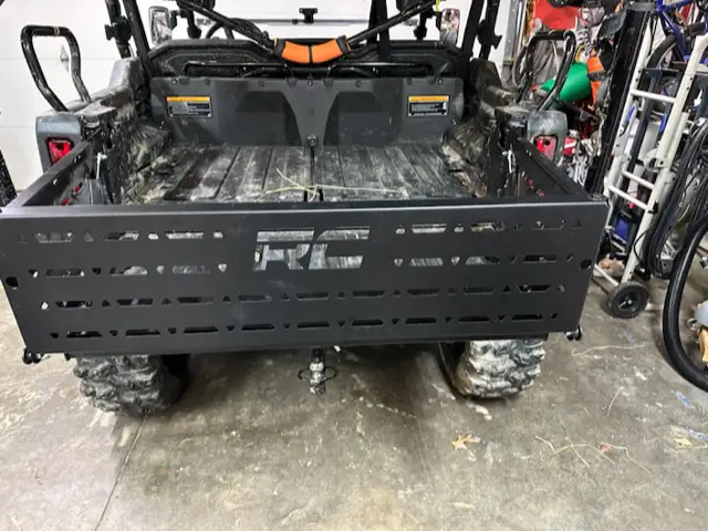

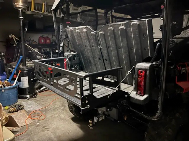

Works well folded & unfolded with the rear seats up and down. There will likely be some rattles as mentioned before, but only with the tailgate closed. mainly due to the the cable extender design.
The cables themselves don’t hold any weight with the extender side rails locked in place. The sides lock into the factory cable bolts which makes the cable extension bracket/bar a little floppy with the tailgate closed
View attachment 368082 View attachment 368083
Thank you!
View attachment 368077 View attachment 368078 View attachment 368079 View attachment 368080 View attachment 368081
Thanks for the detailed photos and review. I think this will fit my needs well with a nice compact design so I have pulled the trigger and ordered one!

Install tips, you only need to remove the plastic from the bed on the drivers side, the first brackets attached to the tail gate have some wiggle room, make sure the tail gate closes, if not loosen them a bit and adjust to clear the bed. Also, the flange nuts go to the bolts for the clamp brackets (first 8x25 bolts used). And lastly, the tailgate cable uses the stock hardware and the new bolt, washers, etc go on the very bottom where it attaches to the new bracket.
