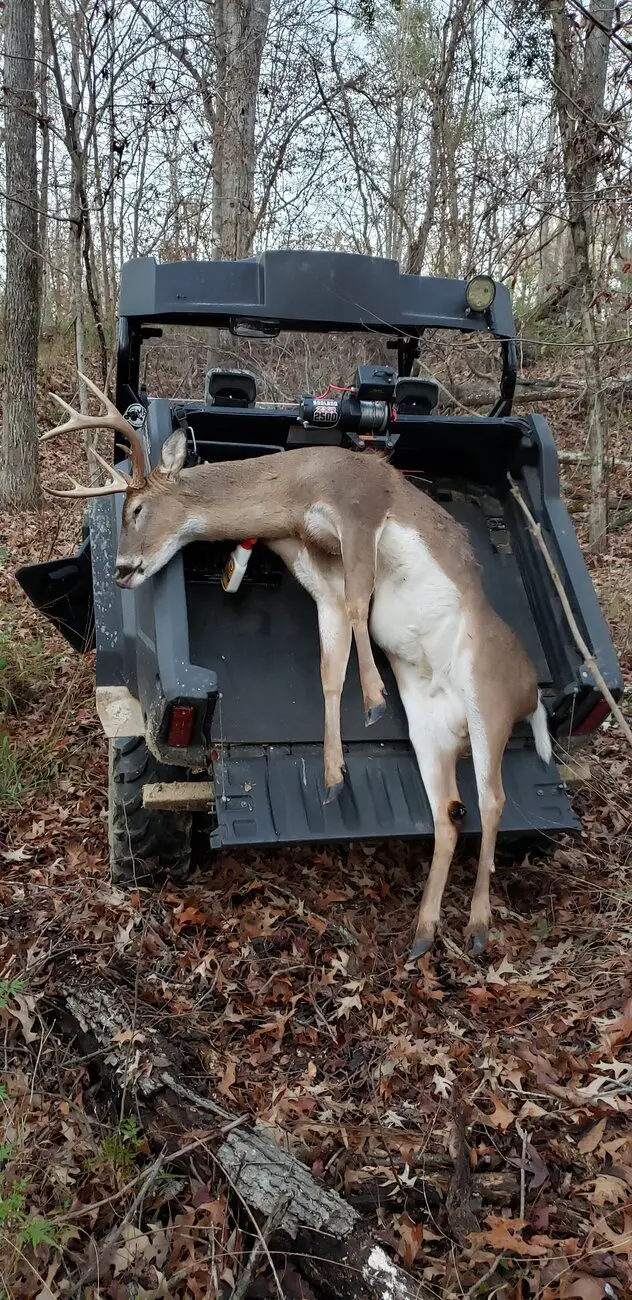

I got to test out the winch i mounted to help load game (deer, hogs etc). Worked really well. Anybody else mounted a winch on the bed or on the cage of their 700?

I have been wondering when someone would try this on the plastic bed. How did you attach the winch?
I mounted a piece of flat bar with a 90° bend on the top to the inside of the middle square tube support by drilling through the top and middle screw location. Bed frame is all square tube so its pretty strong to use to load game and such. Not to be used to winch the buggy by no means. I just couldn't see paying $500 for a mount...
