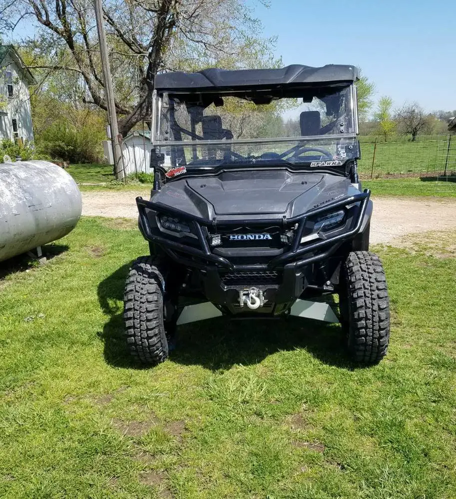

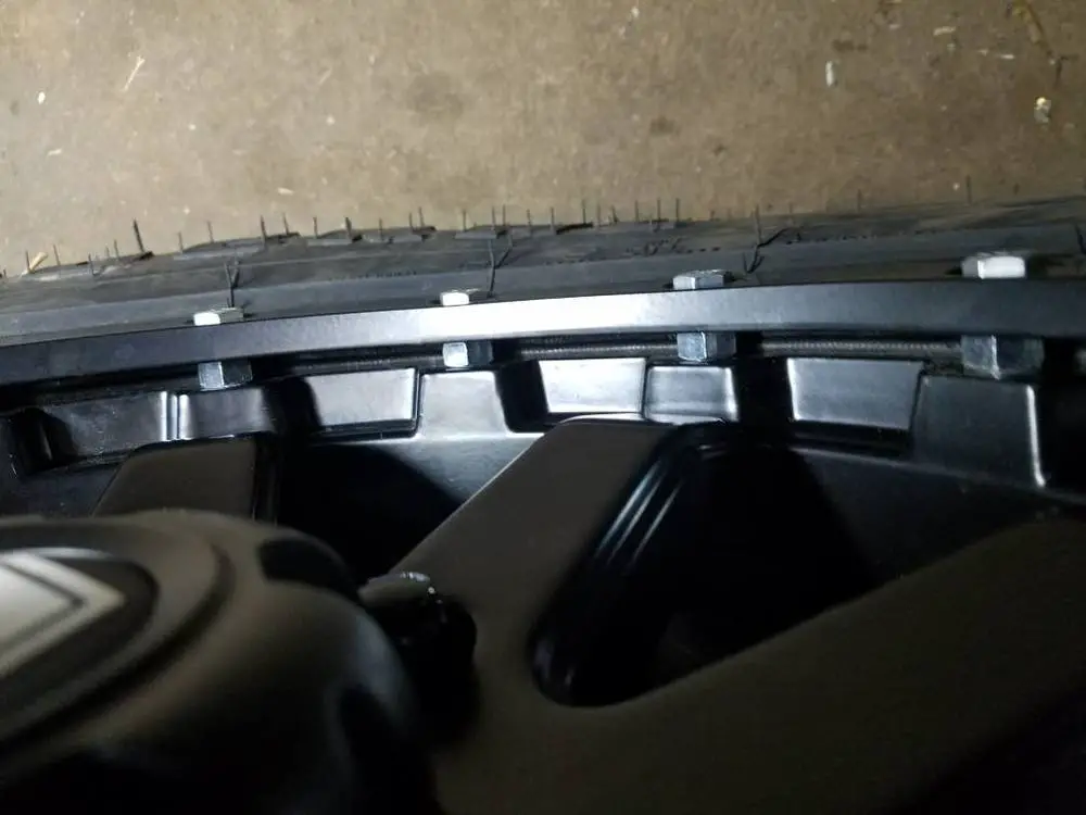

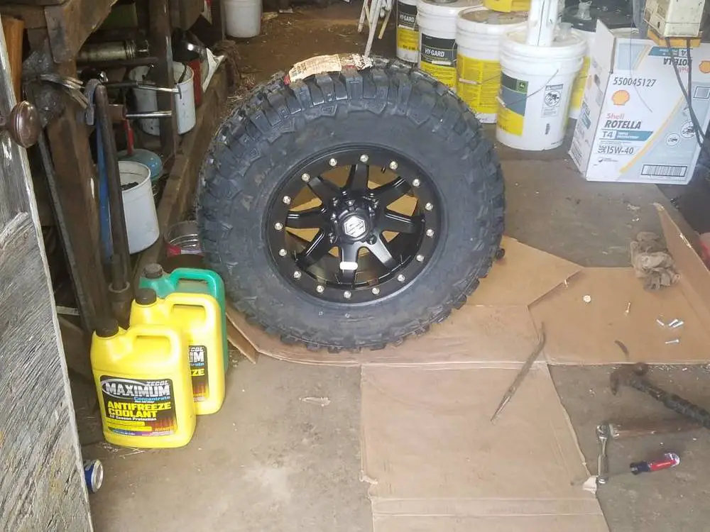

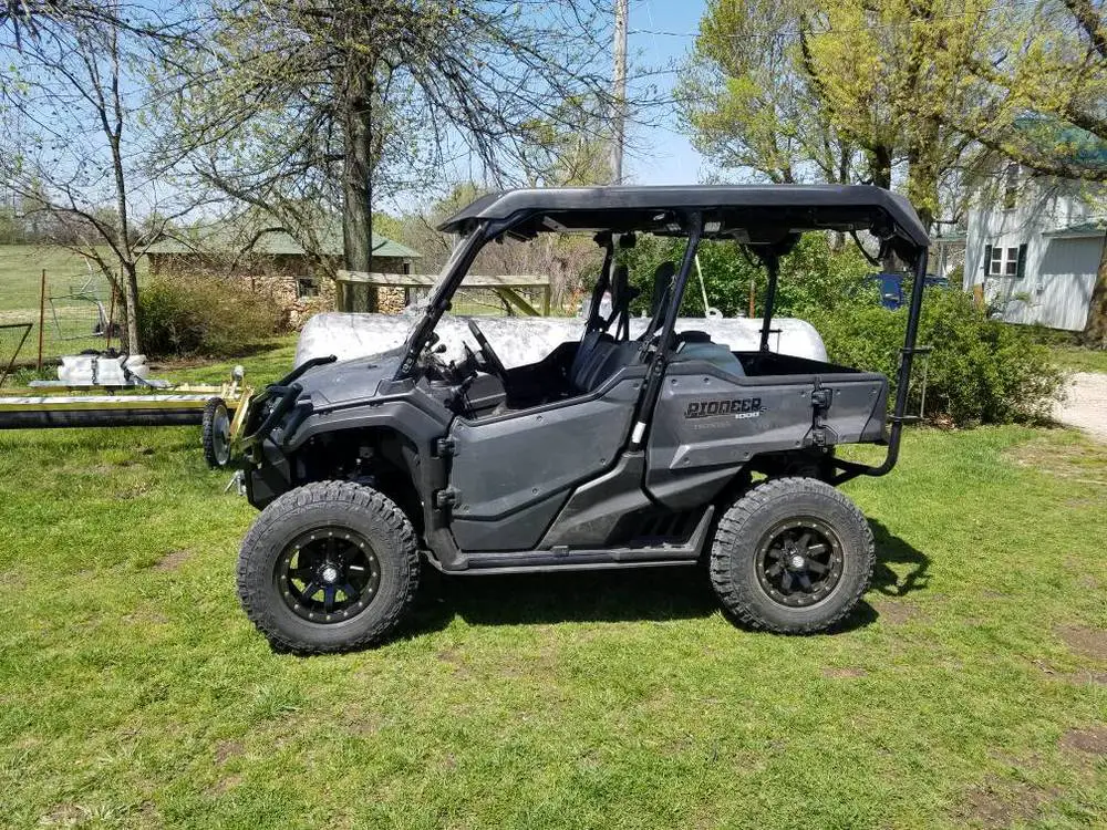

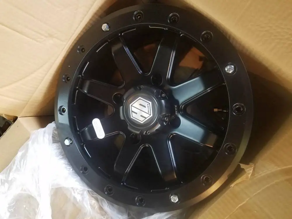

I put sti hd9 on mine they have lifetime warranty 5/16 bolts .394 thick ring seem to be pretty heavy duty same bolt pattern as can-am x3 so was on national back or for 3 weeks , been out once on them . My only issue is I put truck tires on them so beads are thicker and I had to put spacers in between ring and wheel .Going to make full ring spacer some time .$540 for set 6d8acb83db7087686b21522049728c46219a1bac5d2f6d11c1c336b24964a93d05dc3c364c55339055c1913b02cf9d0267b06f697b110b443fb1687bb3005beb49c2b5114487d5cb5d884d4f6e62b6c3

Bought at Pure off-road. Com

I was looking at the STI HD9’s they have some that look pretty good. I like those ones you have.

They took some good hits today

I have the same wheels, they have worked good for me so far. You can also purchase different color rings for the wheels if you want to for around $25-30. I have some battle scars on them already but so far all are on the rings which could be replaced if I wanted down the road.
Like any other beadlock there is a little matiance involved
