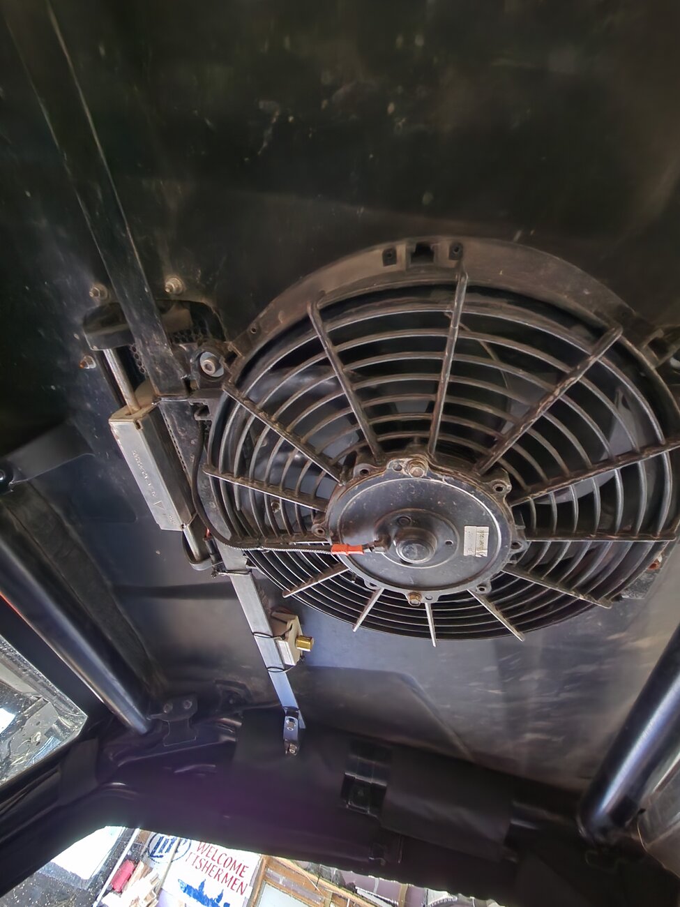

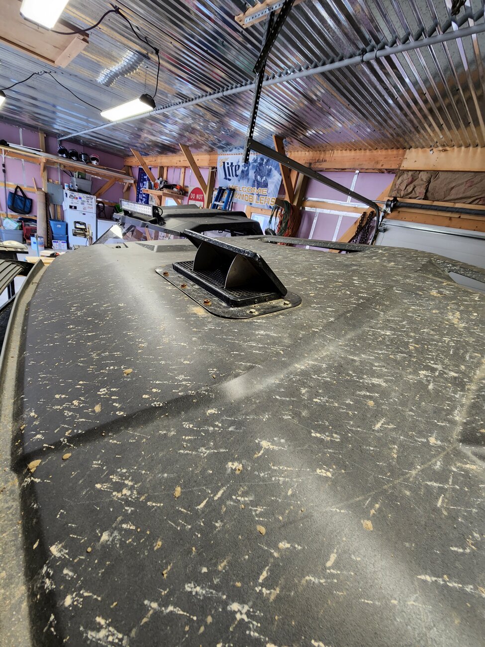

checking back in to see if you have any pics, I am curious to see what you did? @906UP
Thanks
Here you go
20220422 18431320220422 184331
The white box w knob controls off/on and speed, I also added a roof vent that we open in the summer so the fan can draw clean air from outside, not perfect but it helps

That is some serious redneck engineering. A ceiling fan in the sxs……..
Im probably going to copy that. :)

Now that I think about it, most of our forklifts have fans on the a pillars and they run almost all summer.
