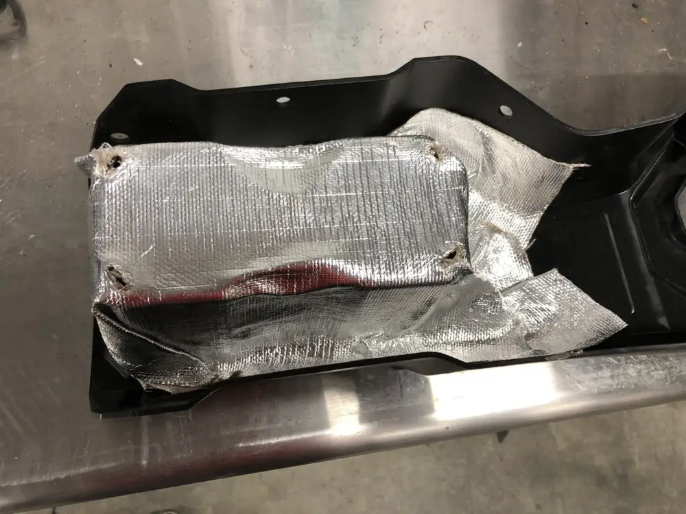

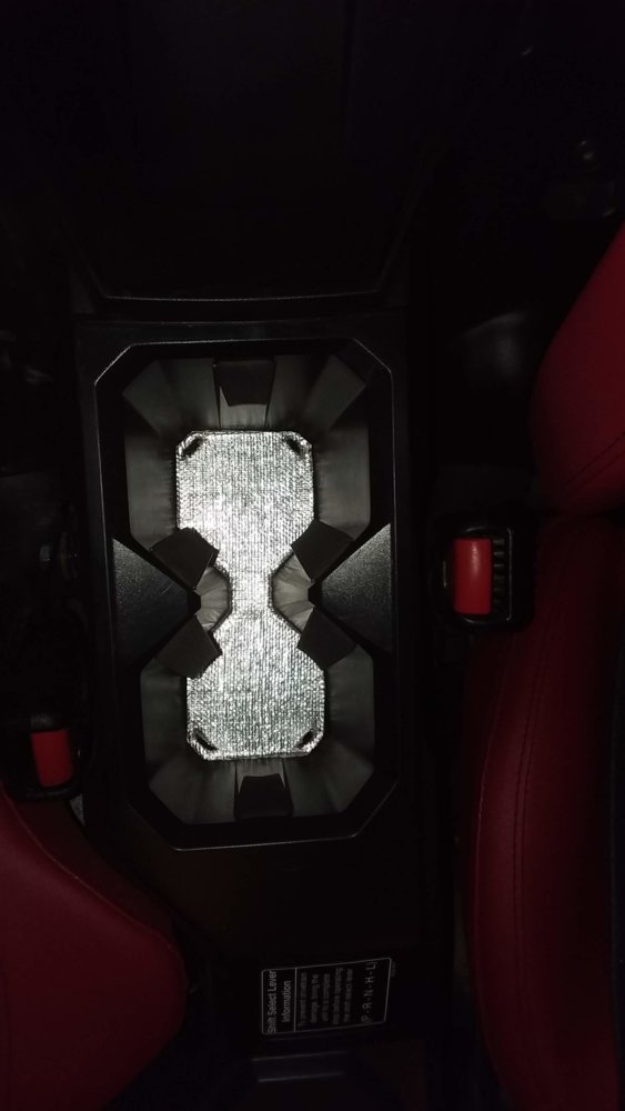

I did a last-minute mod to the center console cup holders before this weekend's trip. After riding backroads I noticed the cupholders get HOT and wanted to keep my drinks cooler, if possible, so I added this Thermo-Tec adhesive aluminized heat barrier.
https://www.amazon.com/Thermo-Tec-13575-Adhesive-Aluminized-Barrier/dp/B00029KC2K?tag=sxsweb24-20
It used about half of the 12"x24" sheet and I tried using the remainder of it up around the shifter area, but there's not much to stick it to so I figured it would be short-lived and removed it.
Will report back after this long weekend trip and tell you how it does.

I’m back from Brimstone and put on 130 trail miles this weekend. This is definitely a mod that’s worth the money. I use a Yeti koozie for cans as well as a Yeti tumbler for other drinks and had no issues with hot drinks.
Just make sure to add some drain holes if you choose to do it.
