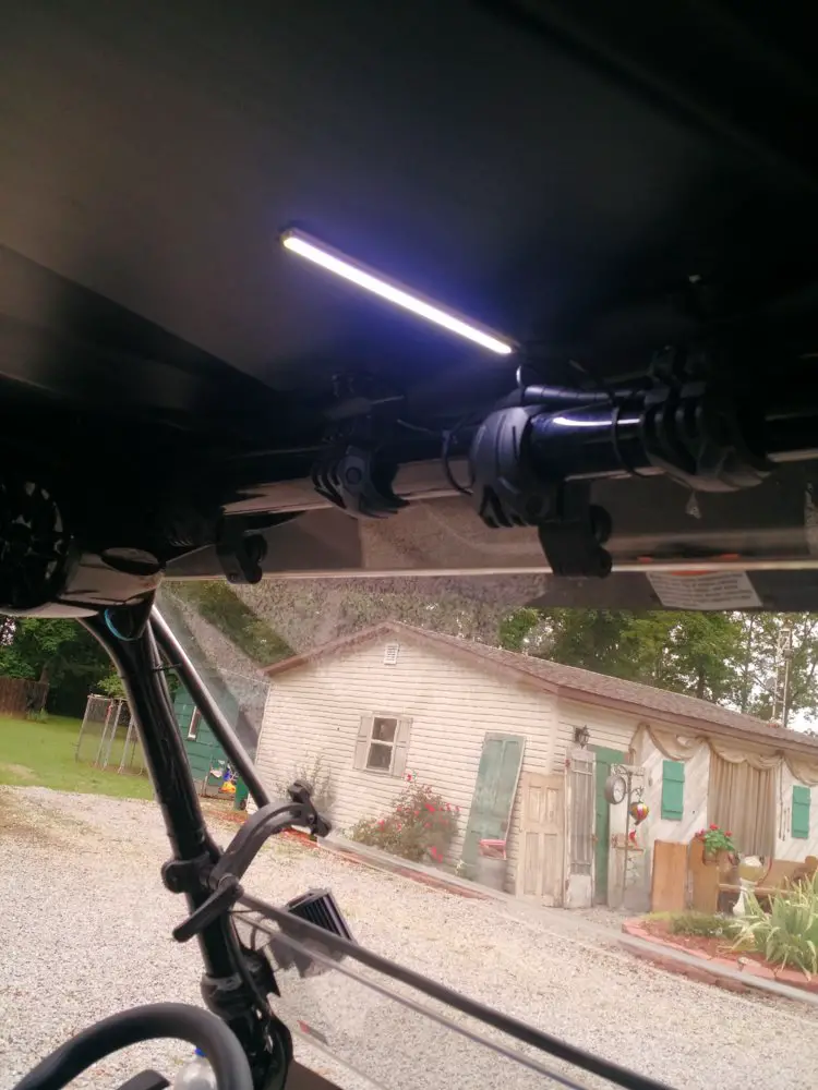

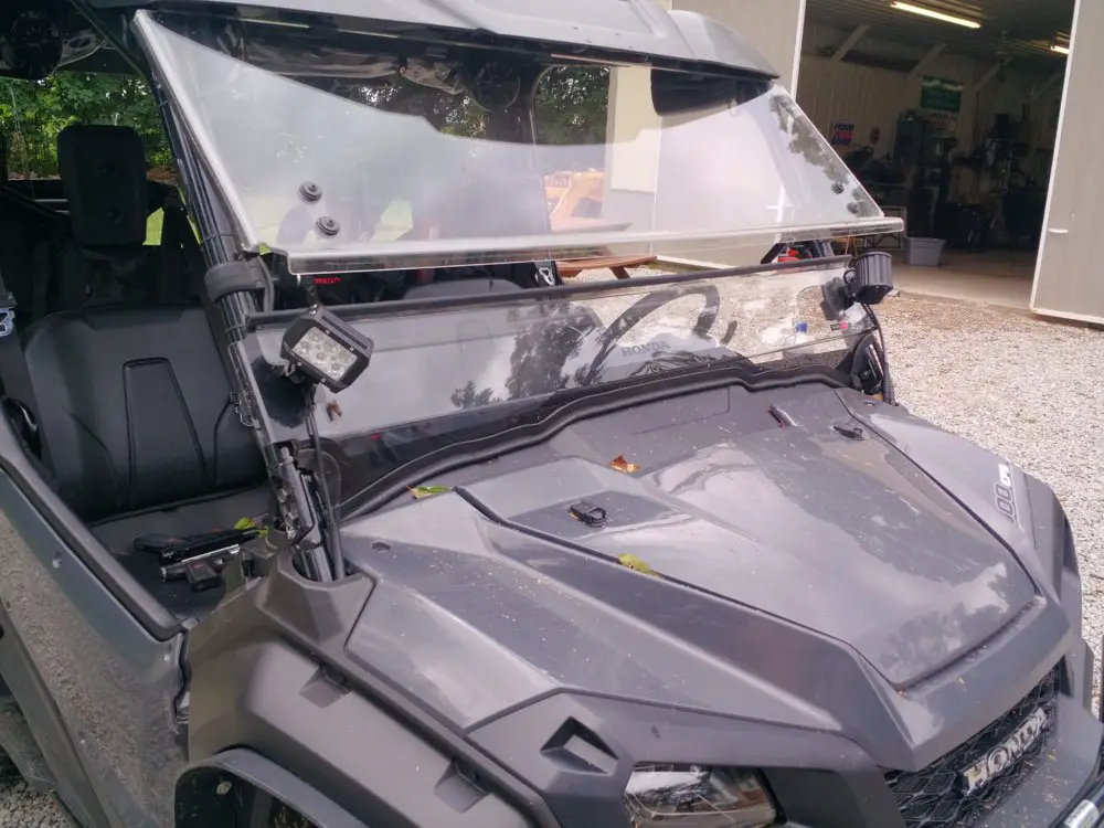

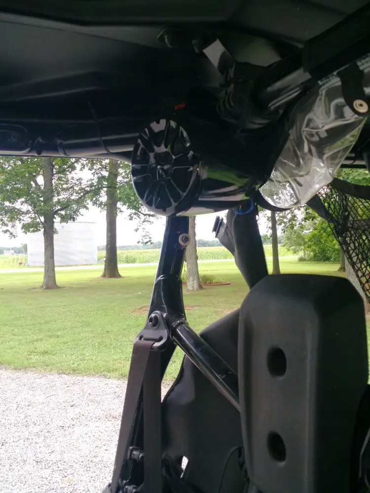

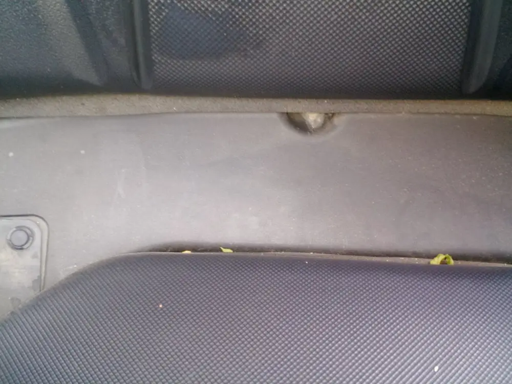

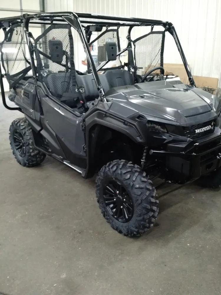

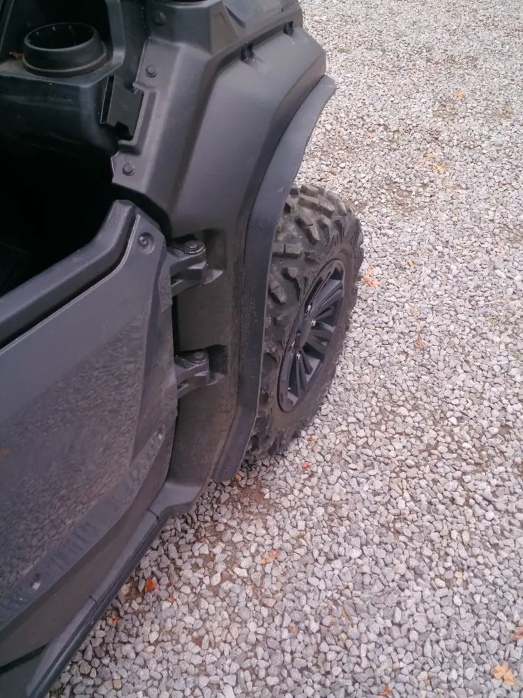

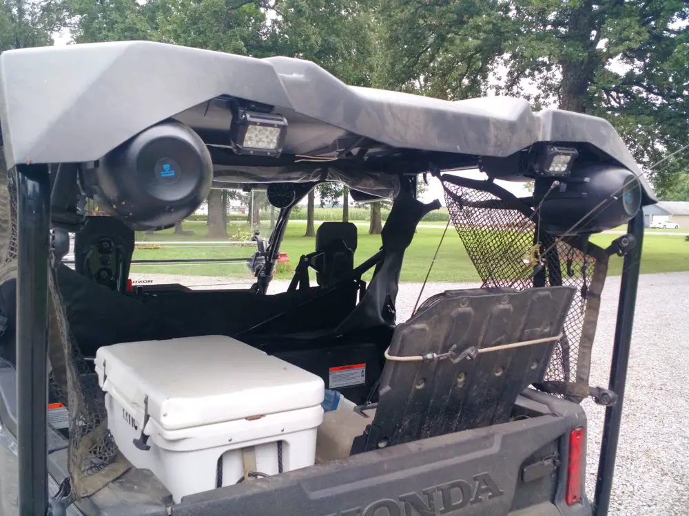

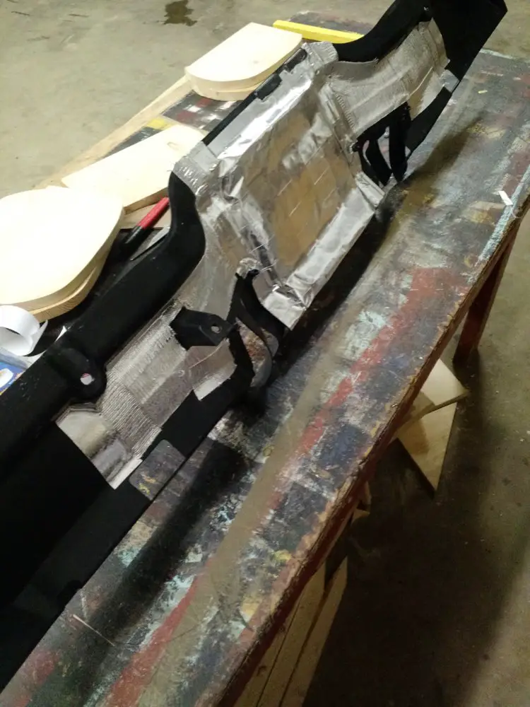

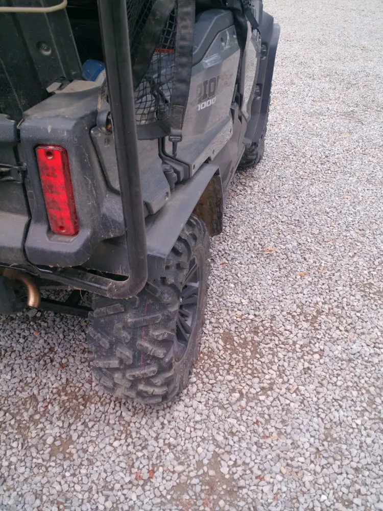

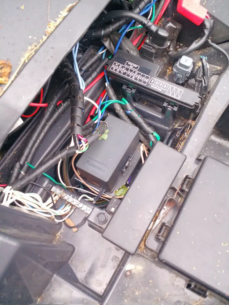

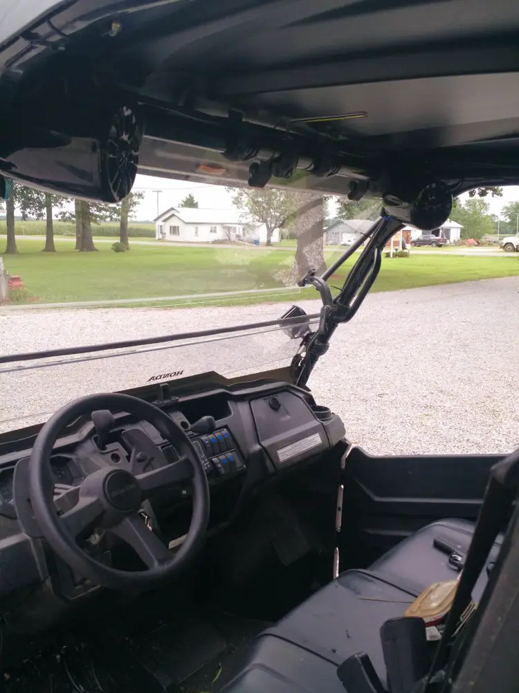

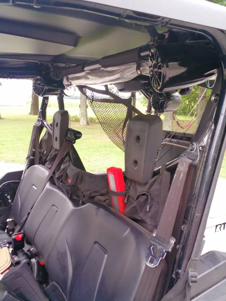

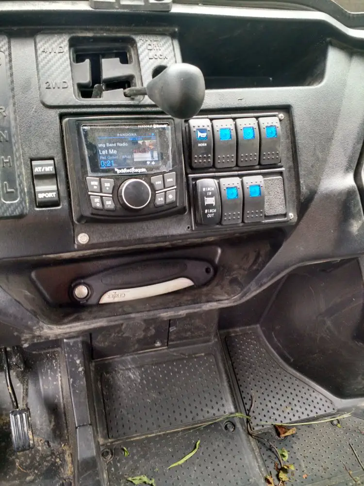

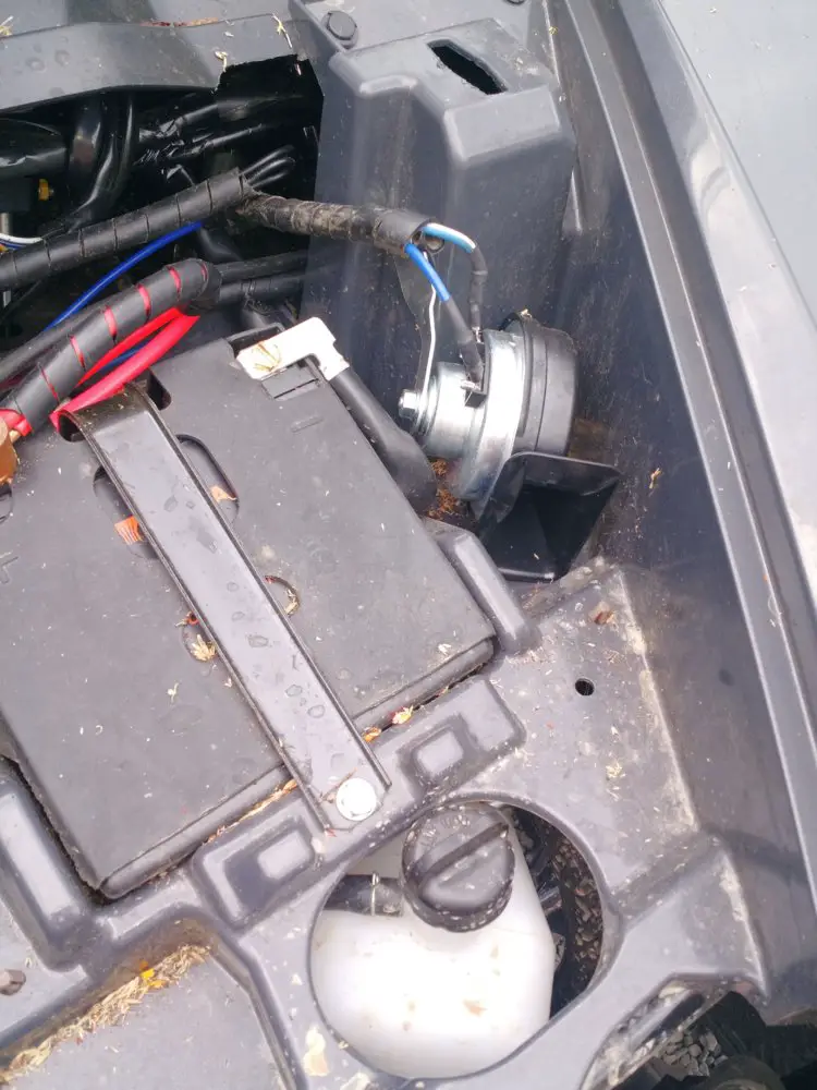

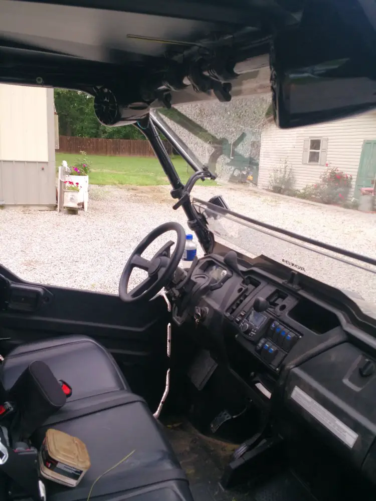

I've been watching this site for awhile now ,figured I join and share some things I've did to my buggy.
So far I've attended to the seat heat problem by adding reflective foil insulation tape to plastic panel,installed reflective bubble insulation under seat,thick weatherstripping wear seat and backrest meat middle panel finally cured that problem. Built custom fender flares. Added led backup lights. Added front led pods angled at 45 degree from headlights. Led dome lights. 4 Boss 4in wakeboard speaker's, 2 Rockville 6.5 wakeboard speakers. Rossford fosgate pmx2 stereo , rocker switches. Horn. Cooper busman waterproof relay fuse holder

Nice looking ride and a great start! Bet that system sounds really good. And excellent choice for a riding partner. You'll hardly ever catch me without my Mark 3 when I'm riding alone. Deadly accurate.
I'm really happy with radio would recommend it to anybody love how the album art comes up on screen every option a radio should have and a big thing for me is I hate volume buttons and this has a volume knob , almost went with the infinity radio that alot of guys use on here but wanted something different...the 4 inch speaker pods look so clean and are not in your way at all . Actually thinking about getting two more and changing the back ones out cause the 6.5s just look so big .
