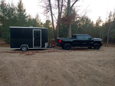

These are the switches I’m using blinkers lights and eventually cutoff. I went with a 12’x7’x7’ enclosed trailer also for my new pioneer 1000-5 a couple of weeks ago.
