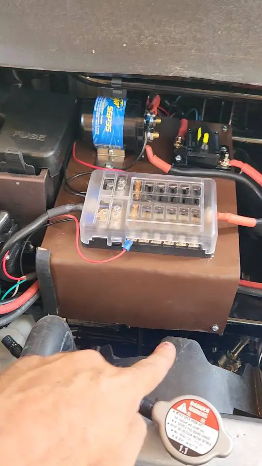

More progress made. I spent all day yesterday adding parts and fabbing brackets. I spent the bulk of the day making and mounting my auxillary battery and bracket under the drivers seat. If I actually had my shop finished it would have been a bing bang job and done. Needless to say I got it all figured out with a hacksaw, some u-bolts, and quick clamps. It ain't purdy but it will do until I can get the key measurements I want and design a plate mount in sketch-up to run a part off the CNC torch at work.

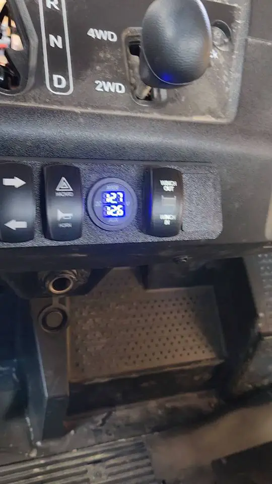

I also went and installed the Key-On power harness from the club store. That was easy as could be. I got that hooked up and then built a custom under hood mounting bracket for the accessories fuse box, relay, etc. Again, had my shop been setup That bracket would have taken me 10 minutes. As it stands I had to bend it using a claw hammer and the corners of my flatbed truck. Then used some self tapping screws and a 90 degree adapter on the ole impact driver to mount it. Painted it brown for giggles. I did not mount any electrical nor have a I run any wires to include the winch. Most of the reason being I wasn't satisfied with the lengths of wire given with the winch. It makes sense considering the winch isn't model/brand specific in anyway. I also didn't have any wire out for running from the AUX Batt to the fuse box. So I've ordered up some wire and hardware to make custom 6 gauge wires for all the main lines. I think this will help reduce a nest of extra wire and fit components where I want them not where they just happen to land because wire length.

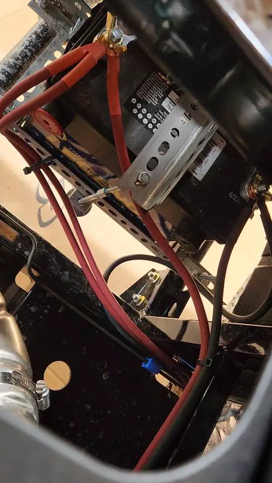

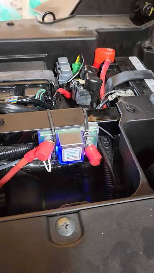

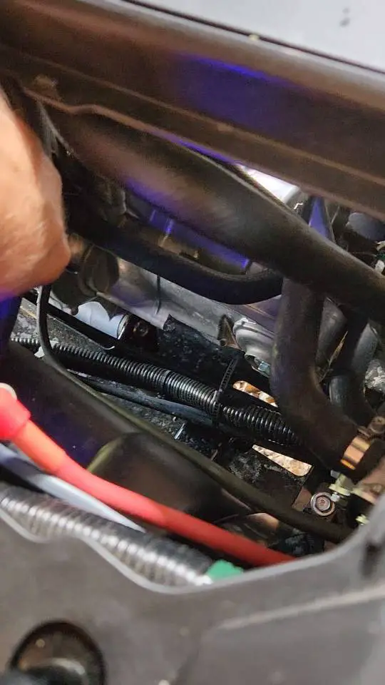

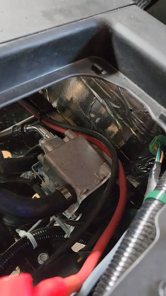

Oye! Got the winch and dual batteries wired. Ended up making quite a few big wires so it would look nice. Zip ties everywhere to keep it neat. Everything tested fine. Tomorrow I'm taking the oldest on an overnight fishing trip so we will give it a good shakedown.

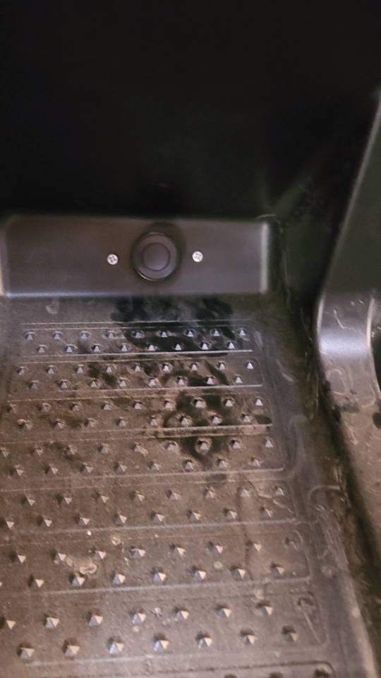

2) Installed two 7" Radiator fans from Amazon MOSTPLUS Black Universal Electric R...i_J473NHX0H8W4RGXJ4KP4_0?_encoding=UTF8&psc=1at my feet under the seat. Set them up to pull engine heat into the cab during the winter and blow cold under the seat in the summer. Did a relay and switch setup. I'm pleased as punch with this. Just enough extra heat that we stay pretty comfy in our hunting gear without sweating up. I think one fan would have been enough but i already did the deed. I have a few ideas to improve winter performance overall but I call it a win. I have no doubts that when I reverse the fans in the summer it will greatly reduce my swass when combined with the seat shield.
