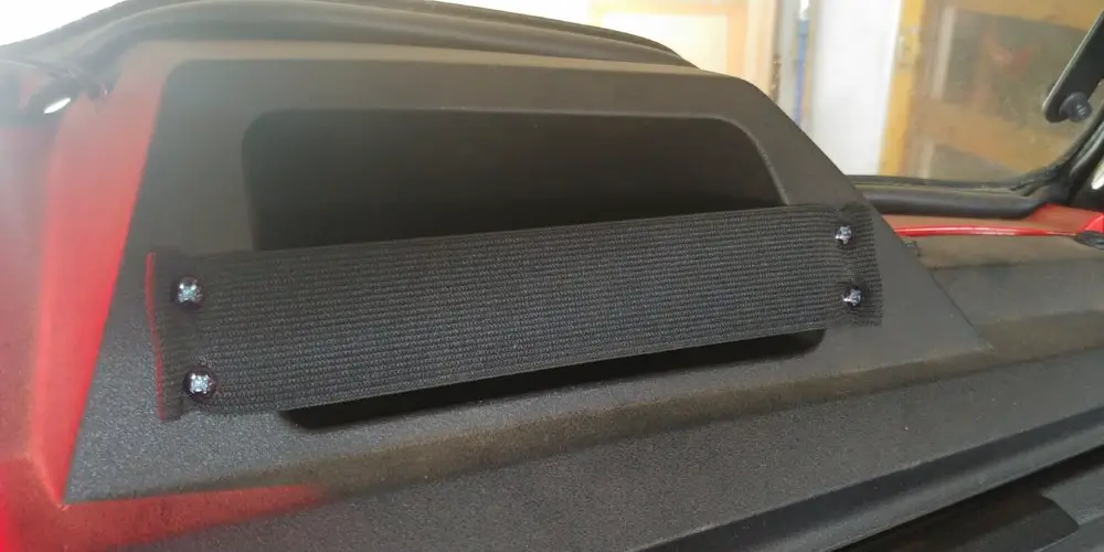

-Screwed in some elastic to cover cubby hole, makes a decent phone holder;

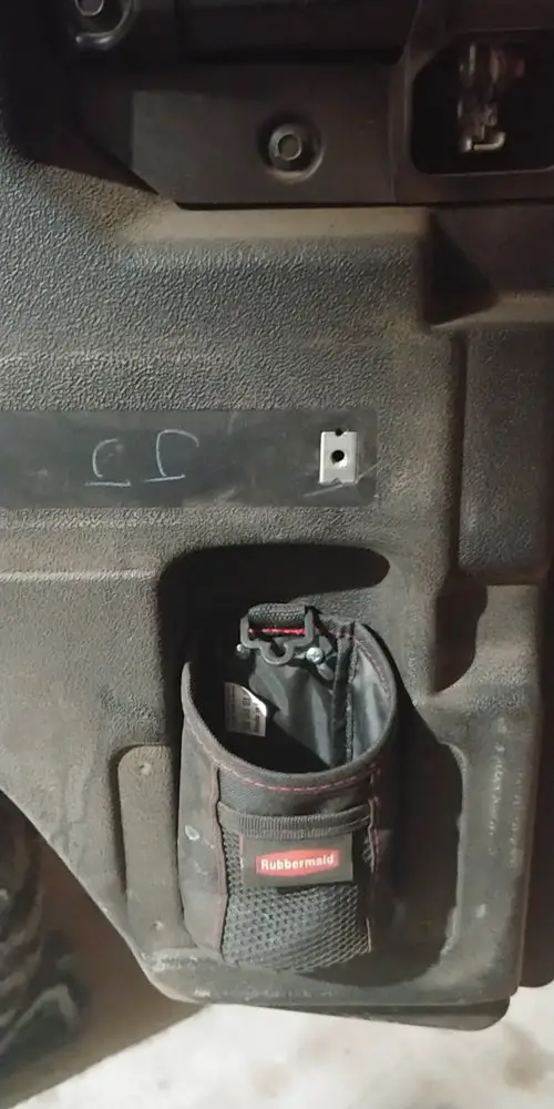

-Added a few Walmart phone holders on the driver side door and under each head rest for back passengers;
