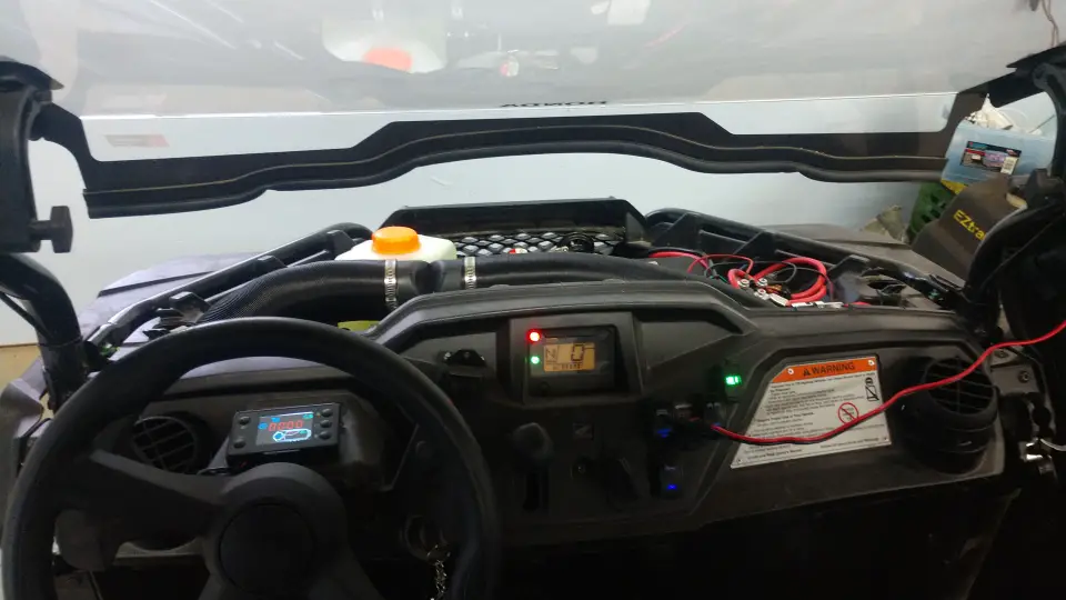

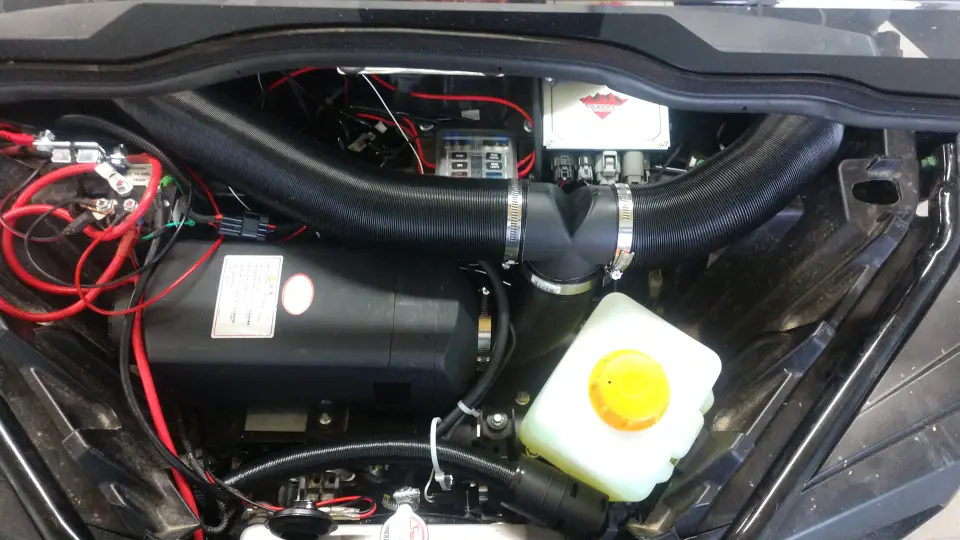

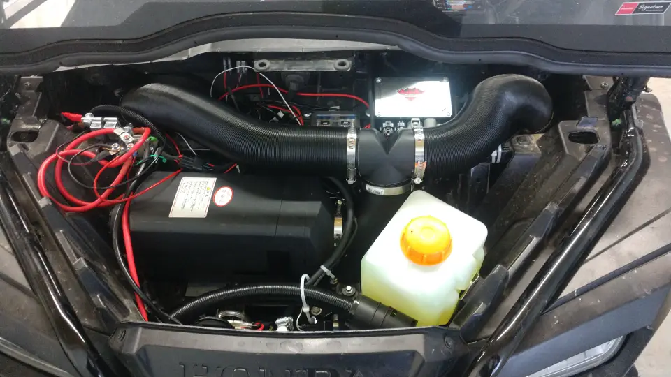

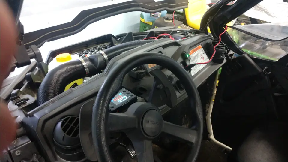

What’s the total cost?
Estimate:
-Heater set -150$
- extra 75 mm pipe -10$
-two extra 65 mm diffusers, since original comes in 75 mm - 10-15$
- extra Y 75 mm splitter -5$ - not needed if you are more creative and not lazy like me that day I sacrifice original to make rings for 65 mm diffusers
- 3 L tank (might be wrong about volume, but it less a bit then 1 gallon milk jar) - 20$
- fuel line tubing from Napa parts 10$
- scrap aluminum plate - 0$
- extra 3" O clamps - 10$
Estimate total - 220$, way cheaper then any coolant base heater and WWwwaaaay simpler to install :))
And heat output instant, super hot if u want and can be used on the go or stationery.

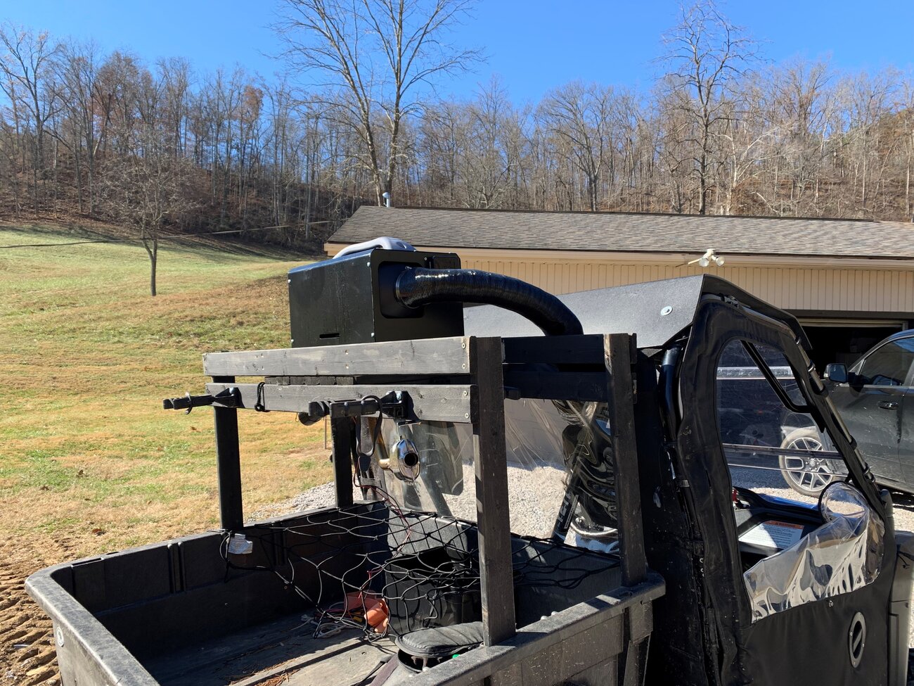

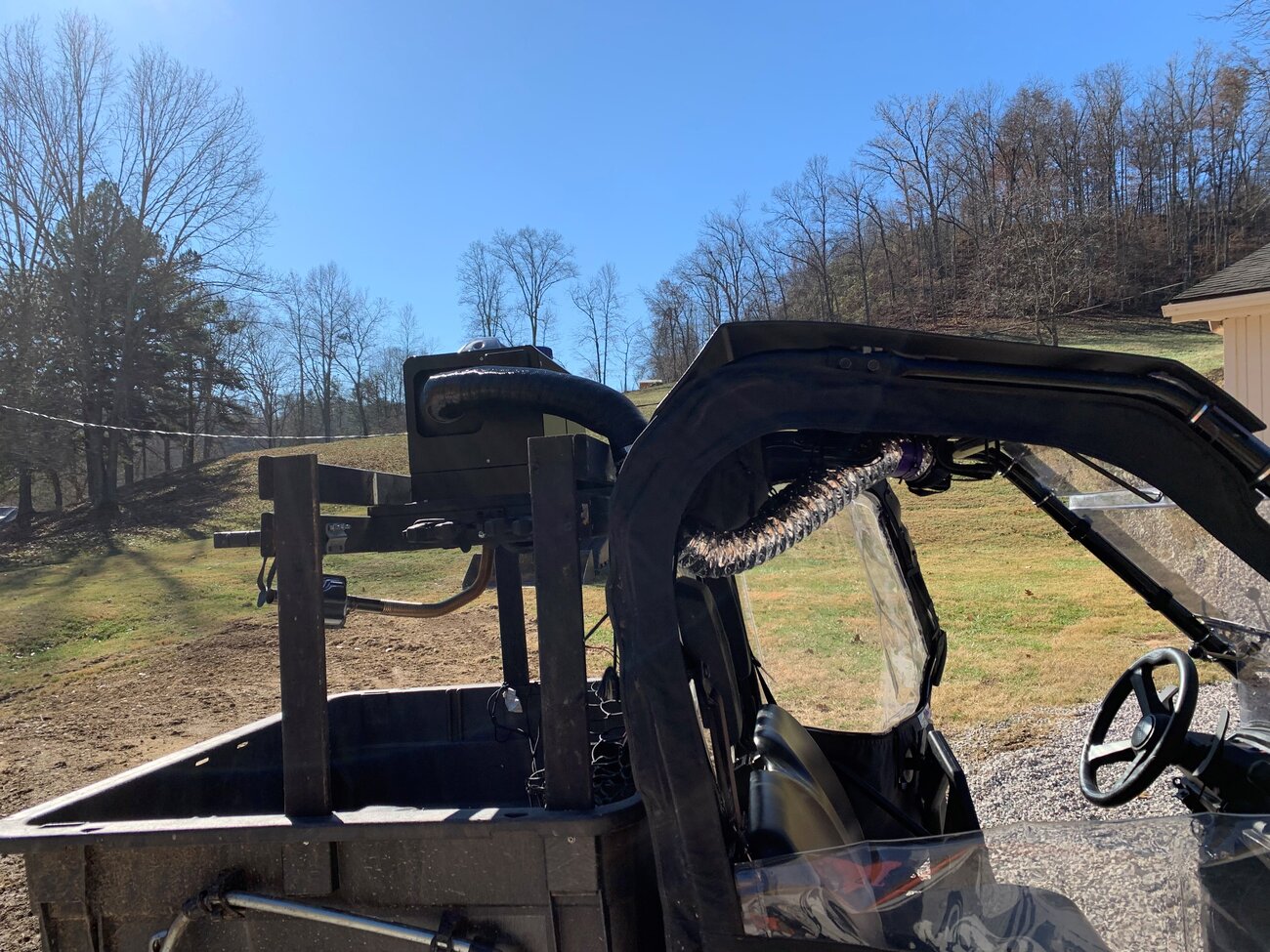

I have portable unit hidden in the case on my cargo rack, we turn it on and drive with it on any terrain and any speed. As long as you have fuel in tank it runs. It was made for trucks and trailers , they are also installed but Webasto brand on SHERP, Google this machine.
Bring your P500 to my garage , will help u to install it
Sent from my Moto Z (2) using Tapatalk

Does this heater work in the P500 durning driven operations....I mean riding trail's at speeds at speeds from 1mph to 38mph...anyone?
I use mine 100% of the time in the winter no matter if I am plowing the driveway or running 30 mph to the lake ice fishing. The best thing I have added for comfort. It is nice to get into the p500 on the lake after ice fishing and it is 70 in there! Keeps the windshield clear also.

How noisy are these heaters?
Very quiet, I put one on mine mounted on my sporting clays rack and i love it. I have since improved the set up a little with a T and a duct ran down and under seat for foot warming and re ran the top run to get it closer to window for defrosting. Waiting for a flapper valve to come in to be able to force it all to one or the other. Will post pics once i get it all done.
