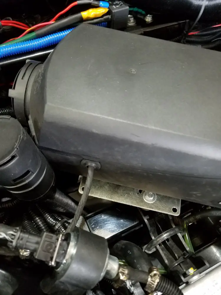

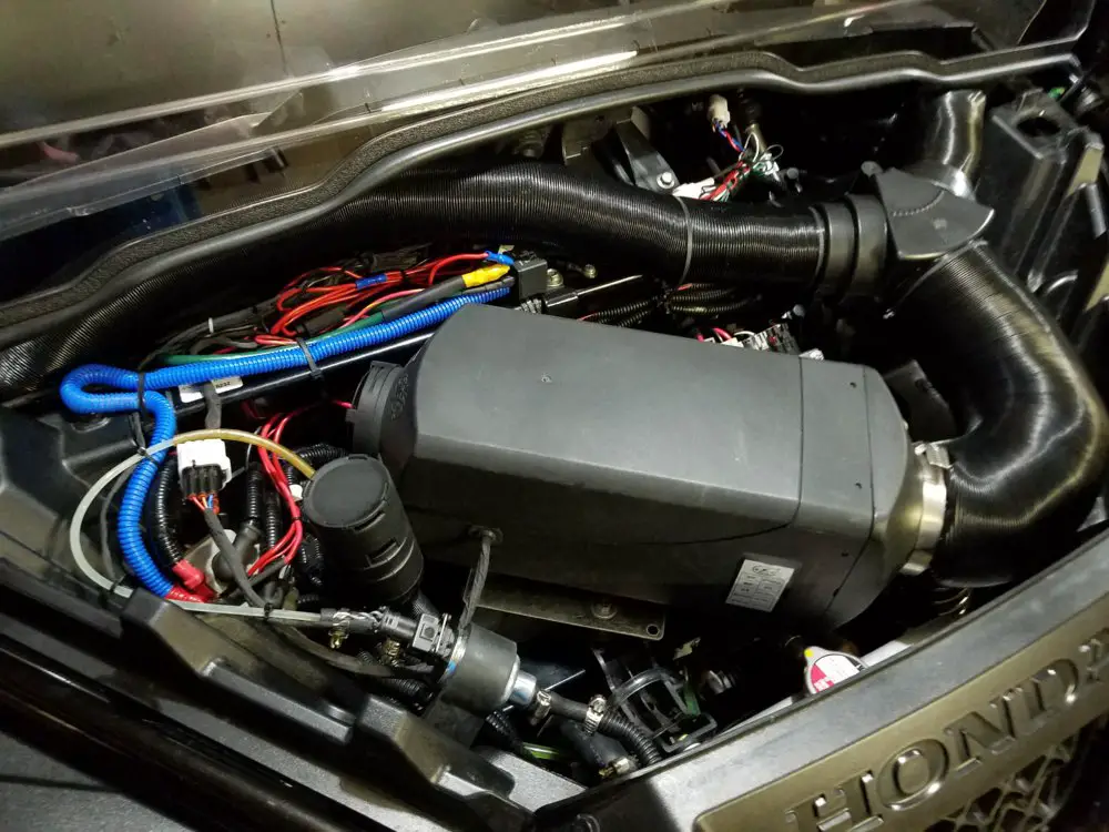

I used the mounting plate that came with the heater. I drilled a couple of holes in it and used a longer bolt and 2 nuts for the front to go thru the radiator bracket. In the back I made a drop bracket that came off the square support at the rear.
