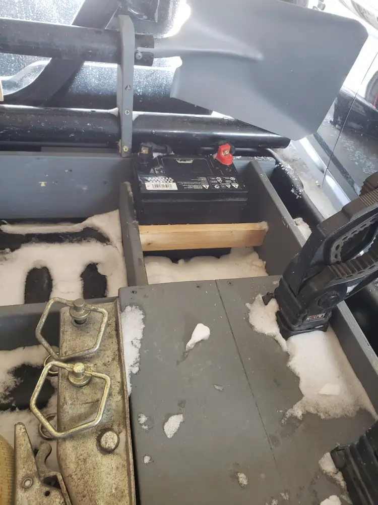

The battery is on my back storage tray. I used a U1 battery. I put a 15 amp weatherproof fuse on it and used a 16 gauge 3 wire outdoor extension cord to run along the roll bar to the front storage area where I have the heater. I used all 3 wires as the battery cable to a Bosh type relay so that the heater runs on the back battery when the p5 is not running. As soon as you start the engine both batteries are charged. I ran the negative cable from the back battery to the main ground bolt on the frame by the battery box. Unless the key is on the rear battery is isolated. If you have any more questions just ask.

The battery is on my back storage tray. I used a U1 battery. I put a 15 amp weatherproof fuse on it and used a 16 gauge 3 wire outdoor extension cord to run along the roll bar to the front storage area where I have the heater. I used all 3 wires as the battery cable to a Bosh type relay so that the heater runs on the back battery when the p5 is not running. As soon as you start the engine both batteries are charged. I ran the negative cable from the back battery to the main ground bolt on the frame by the battery box. Unless the key is on the rear battery is isolated. If you have any more questions just ask. View attachment 109155

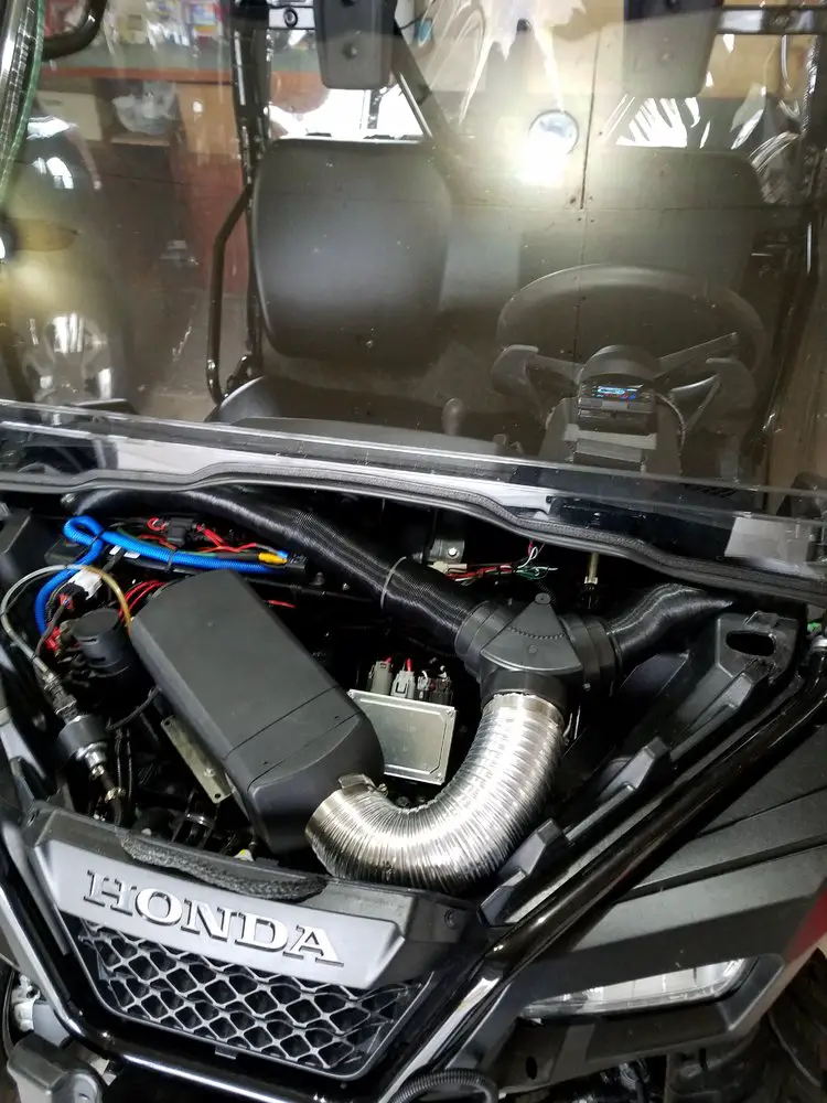

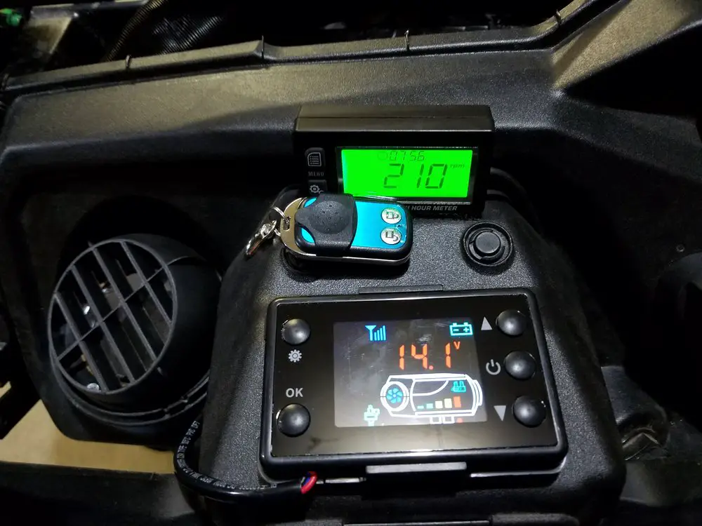

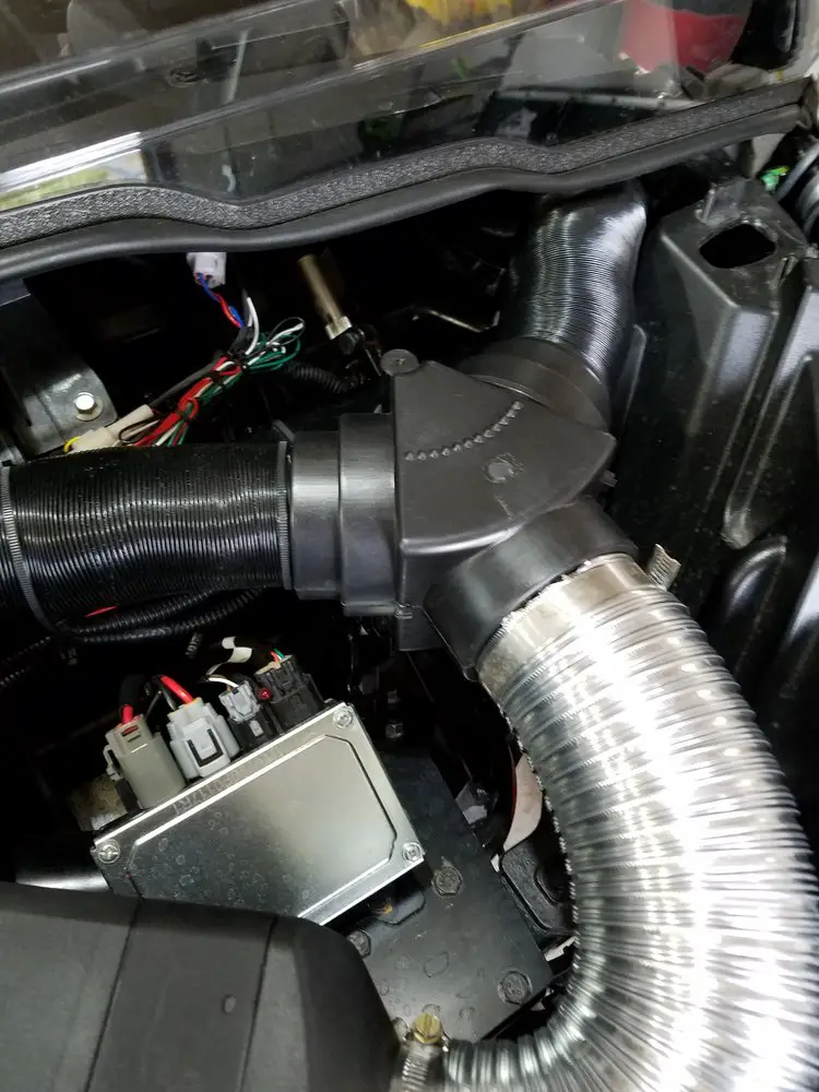

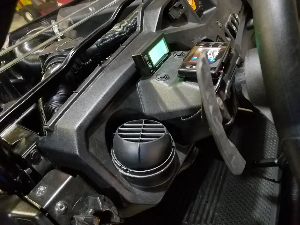

Could you please, show how u mounted your heater? Did u fabricate a plate?
Sent from my Moto Z (2) using Tapatalk
I used the mounting plate that came with the heater. I drilled a couple of holes in it and used a longer bolt and 2 nuts for the front to go thru the radiator bracket. In the back I made a drop bracket that came off the square support at the rear.
