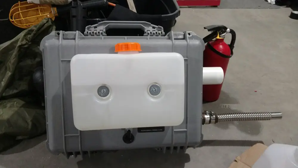

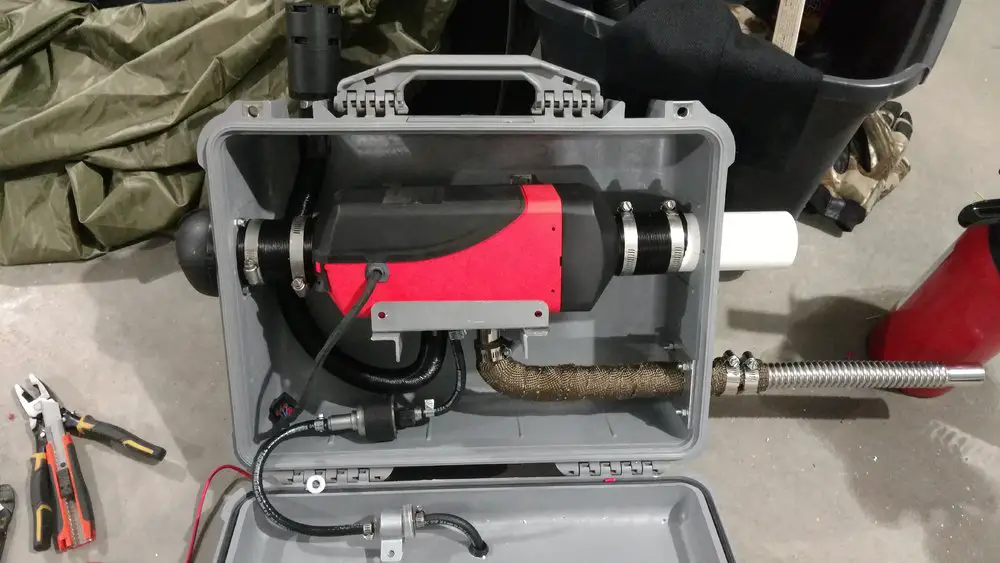

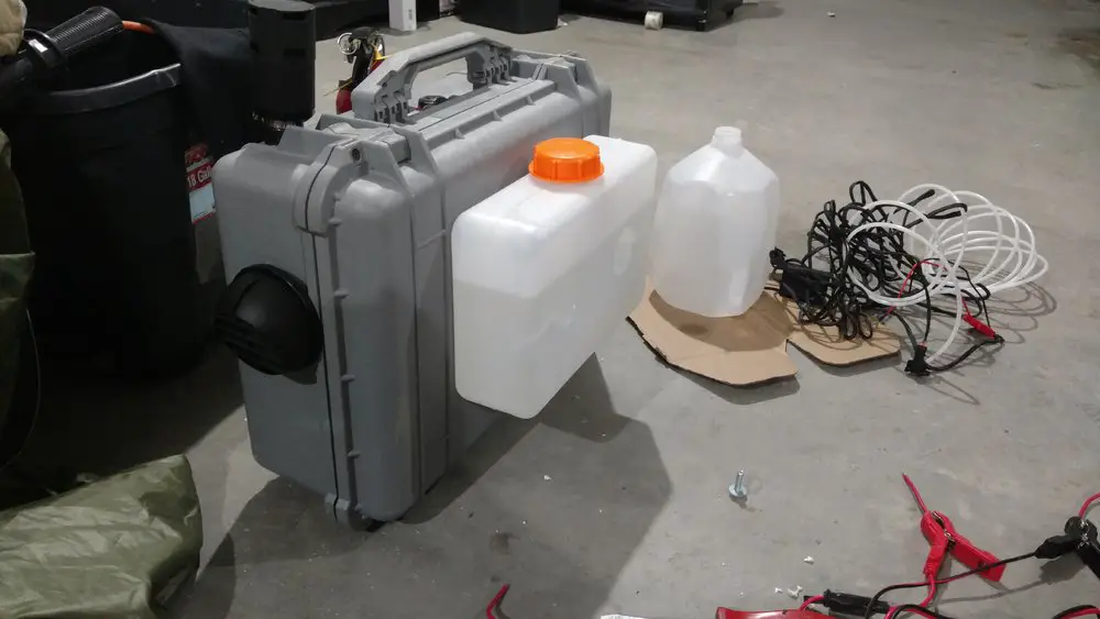

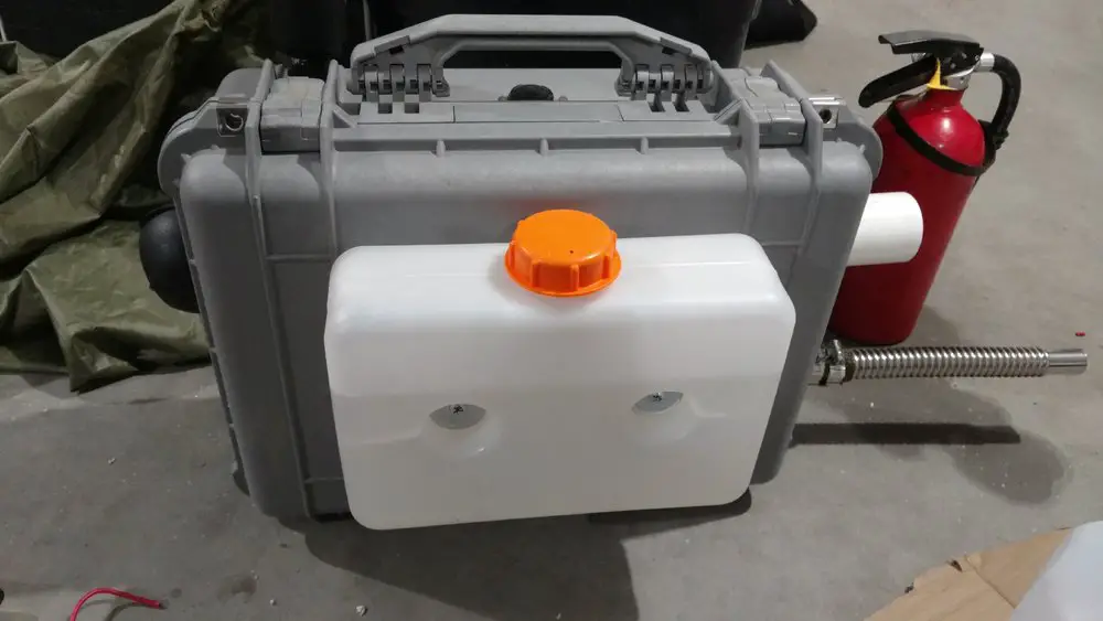

What a bummer!!! Put together this beauty heater :), the pump was broken , hrrrrrrr. got a lemon pump
emailed back ebay seller, waiting ..........
View attachment 65593 View attachment 65594 View attachment 65595 View attachment 65596 View attachment 65597 View attachment 65598
