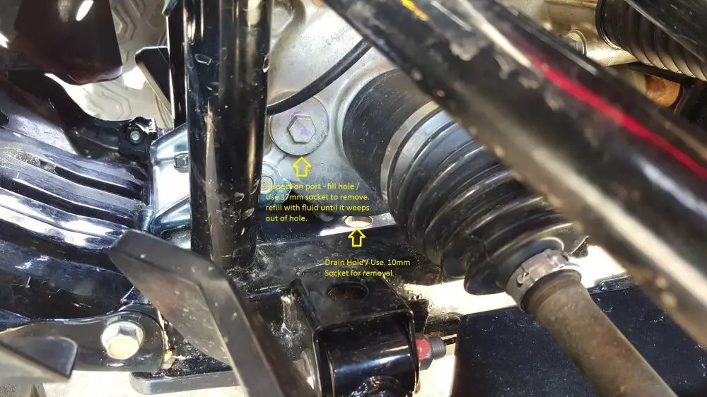

Step 1: Locate and remove the inspection / fill cap for the Front Differential on the front divers side of the machine between the front tire and bumper.
Step 2: Locate the front differential drain plug through the skid plate access hole. place drain pan underneath drain plug and remove drain plug using 10mm socket.
Step 3: Once all oil has drained re-install the drain plug into the front differential.

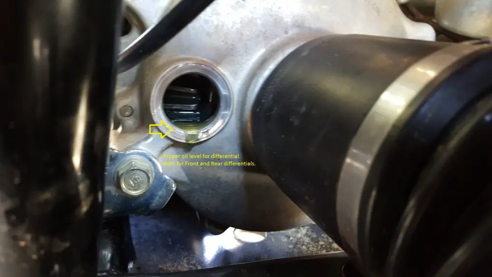

Step 4: Fill the front differential with approx. 12 US oz. of 80-90 weight hypoid gear oil meeting manufacturers specifications. When full the oil should just weep from the inspection hole as shown below:
Step 5: Replace the front differential inspection / fill hole cap using the 17mm socket and extension by finger to ensure you do not cross thread the cap, they are fragile and can be broken if careless force is used. Finish tightening using the ratchet by grasping the head and twisting your wrist with minimal leverage, DO NOT OVERTIGHTEN the caps they can snap apart.

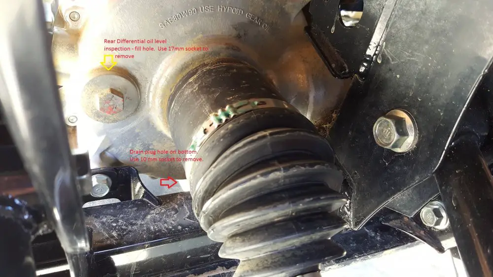

Step 6: Locate and remove the inspection / fill cap for the Rear Differential from behind / above the passenger side rear tire.
Step 7: Locate the rear differential drain plug through the skid plate access hole. place drain pan underneath drain plug and remove drain plug using 10mm socket.
Step 8: Once all oil has drained re-install the drain plug into the rear differential.
Step 9: Fill the rear differential with approx. 16 US oz. of 80-90 weight hypoid gear oil meeting manufacturers specifications. When full the oil should just weep from the inspection hole as shown below:
Note: I ended up adding nearly 19 oz. of oil to rear differential get it to weep out of the fill hole. I ended up using all 32 oz. for both front and rear differentials and they were not over filled.
