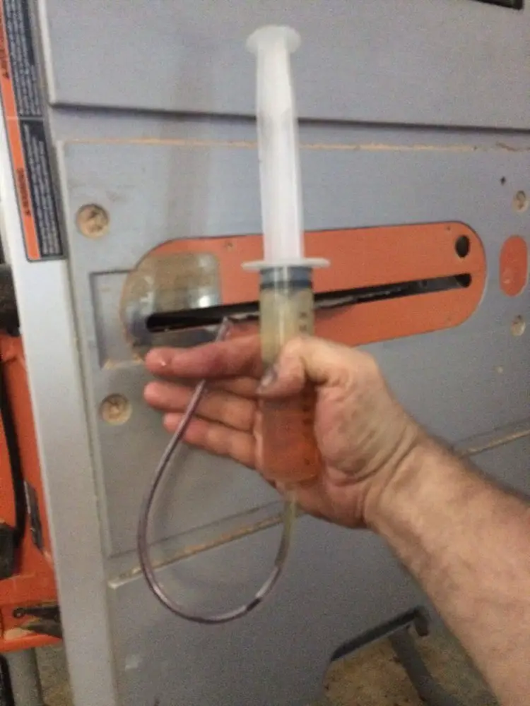

We fill diffs with these.
Download 5
200cc Fluid Syringe, can be bought numerous places and Amazon.

I decided to put some Lucas stabilizer in and this setup made it easy to suck out a couple ounces of and refill. Didn't loose a drop.
Just a 100cc syringe and some poly tube.
I use the exact same thing, it's also used to suck the gas out of my pressure washer before winter storage.

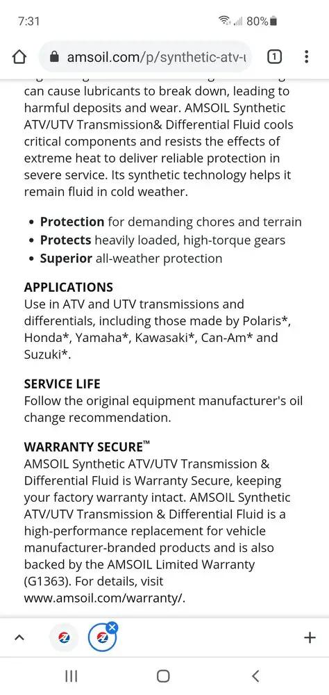

Not sure about the weight but it says GL-5 on that bag and the Talon manual specs GL-5.
AMSOIL Synthetic ATV/UTV Transmission & Differential Fluid has the physical properties of a 75W-90 gear lube. This product is an API GL-5 quality gear lube for use in differentials and transmissions. It is recommended for use in Honda, Kawasaki, John Deer, Kubota, Suzuki, Arctic Cat, Yamaha, and any other ATV or UTV calling for a GL-5 type differential and transmission fluid. It is also recommended for use in Polaris ATVs and UTVs that call for AGL or Angle Drive.
