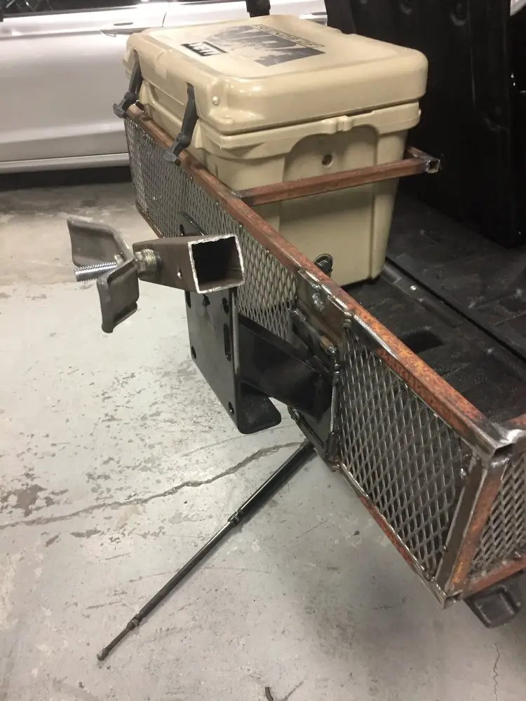

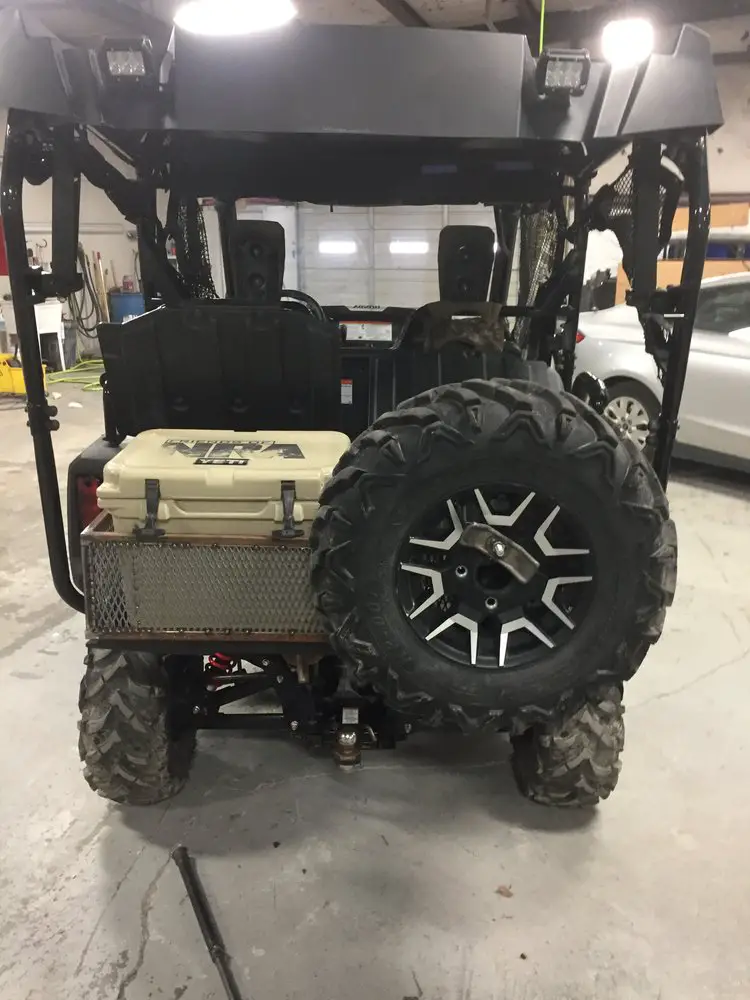

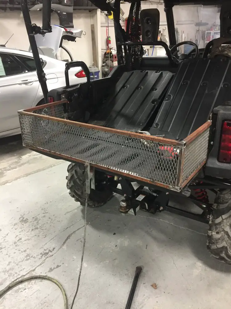

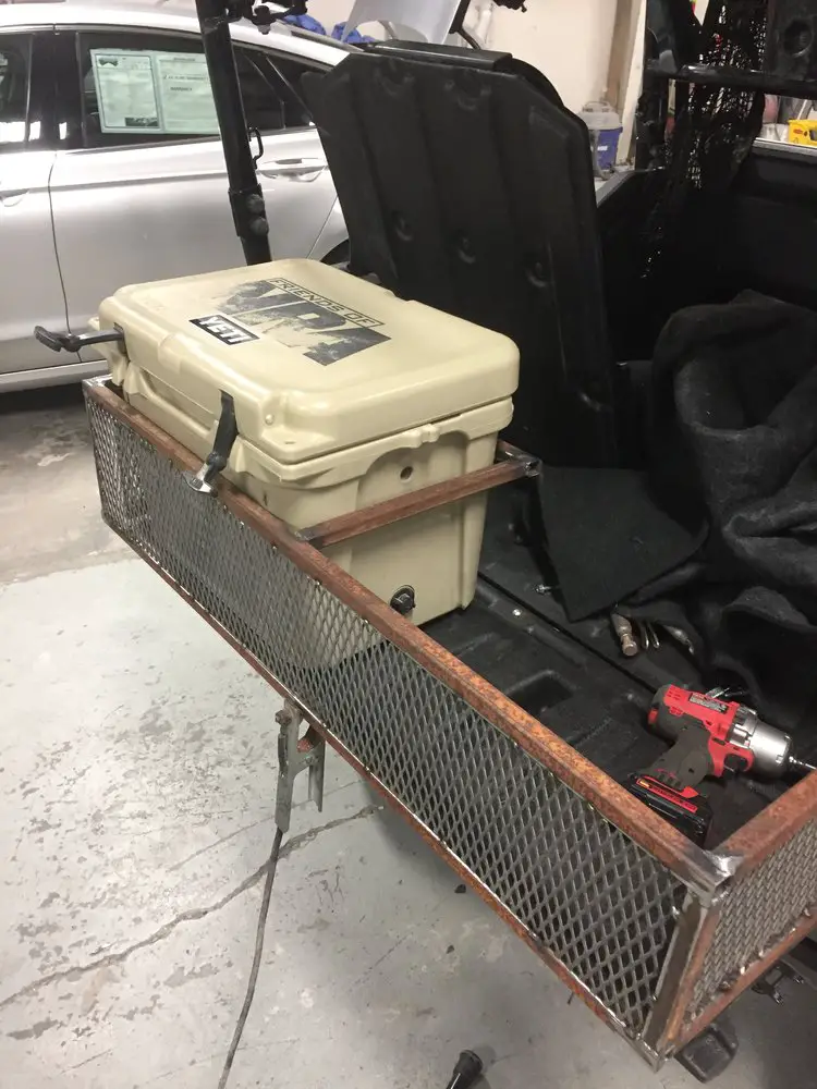

Decided to make my own bed extender. I have a pelican case i got to keep stuff in, but its too wide to fit in a factory bed extender so this is what i came up with. Attaches behind the seat to the anchor points in the floor with zip ties. Ran out of time before figuring
IMG 65421
IMG 65371
IMG 65411
IMG 65351
out how to attach the other side. still gotta glue and paint.

How did you secure it?
Sent from my XT1585 using Tapatalk
I made brackets that I reused the bolts where the cable goes in and there is a hole half way down that if you have the Honda bed extender uses that I used a long bolt and nut and then made a bracket that goes on the tailgate handle that bolts to the bottom of rack that holds up the tailgate , and took off the cables because they keep the gate at a angle and I wanted it flat, if you want I can take better pic of that and post if you want them
