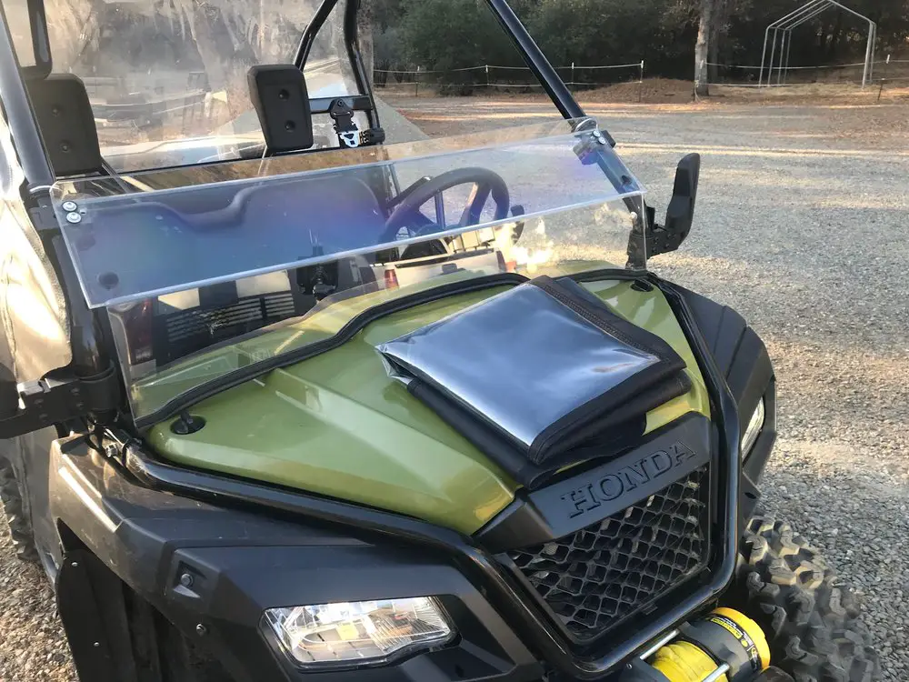

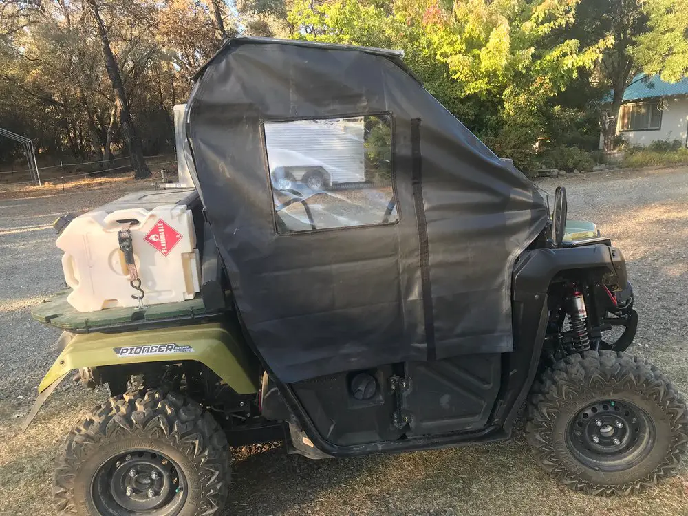

After reading all the posts on the P500 door issues, decided to make a go at making my own. I wanted doors that I can easily and quickly put on and remove if the weather turns bad while in the field. I have a ways to go to get a finished product I like, but I've got it started. The door will be attached using heavy duty Velcro, the door will be a zipper. I'll use 4 buckle and straps to make sure it doesn't depart on the go. And when I don't need the door I'll be able to remove it quickly, fold it up and put in my cargo box. I bought the material, Velcro, zippers and clear plastic at Walmart for about $60.00. I'll be giving it the old field test during the next month while hunting in Idaho and Colorado.
View attachment 90888 View attachment 90889 After reading all the posts on the P500 door issues, decided to make a go at making my own. I wanted doors that I can easily and quickly put on and remove if the weather turns bad while in the field. I have a ways to go to get a finished product I like, but I've got it started. The door will be attached using heavy duty Velcro, the door will be a zipper. I'll use 4 buckle and straps to make sure it doesn't depart on the go. And when I don't need the door I'll be able to remove it quickly, fold it up and put in my cargo box. I bought the material, Velcro, zippers and clear plastic at Walmart for about $60.00. I'll be giving it the old field test during the next month while hunting in Idaho and Colorado.
Interesting, it looks like there was sewing involved. Did you have any help from mama on that?? Nice idea!!! :)

Looks pretty good, should keep ya warm in the winter
