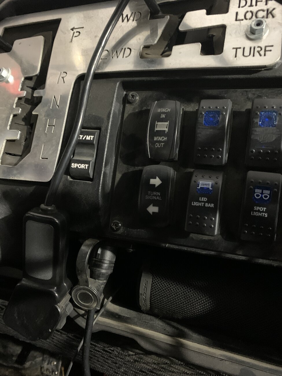

Spent this morning adding a second battery to my machine. I used the True isolator and followed their wiring. I was under the impression that my accessories/winch would get power from the second battery without having the key in. I have the warn winch and oem switch plate harness. Any ideas on where to troubleshoot as it would be nice to run the soundbar without the key.

you need to post pics of machine, this site likes pictures is what I learned
do they work with key on and don't work with key off?
need print, sketch, pics of wiring, etc - where is 12v positive sourced from for your accessories?

I'll take photos tomorrow. Looking at some diagrams, I see the key-on circut wire. I followed the winch remote wires back into the cab, and there was a separate wire branching off, but I couldn't see where it went. Will update you tomorrow.

If its OEM Honda winch, it went to the back of the Accessory socket.
I recommend leaving the winch on key-on.
If you want your fuse to be key-off you need to find that wire and move it to a switch.

FWIW I have my winch remote wired direct, but the dash winch switch is key on.
I did this way so that if I had electrical or other crazy problems that wouldn’t pull the relay , I could still get it winched on the trailer or for times I don’t want to have the key on just to make some simple winch pulls in the shop or something.

Here is how mine is setup. I use the remote to run the winch in the winter for plowing. This way I can shift and operate the up/down of the plow at same time. My left hand runs the suicide knob on the wheel. No wasted time and I can move snow like mad.
I have two trigger wires. The remote trigger is connected directly to the auxiliary battery (same for winch) and the dash switch is powered when my relay pulls in when the key is on. It’s dead when the key is off.
in the summer I use the dash switch, and hook up remote only when needed. In winter I leave the remote hooked up but my kids are older and I plow snow a lot. Simply disconnect remote if your worried about it.
best of both ways.

That's exactly what l did but l put a hidden switch to kill power to the relay inside the glovebox. Again, kids will be kids. And l like all of my digits.

This seems ideal. Didn't think about pulling the remote in the summer months. Kids don't touch the machine in the winter and I plow a lot as well. Maybe I'll add switch for key-on and move the remote directly wired. Any wiring diagrams handy that make this easier to process?
