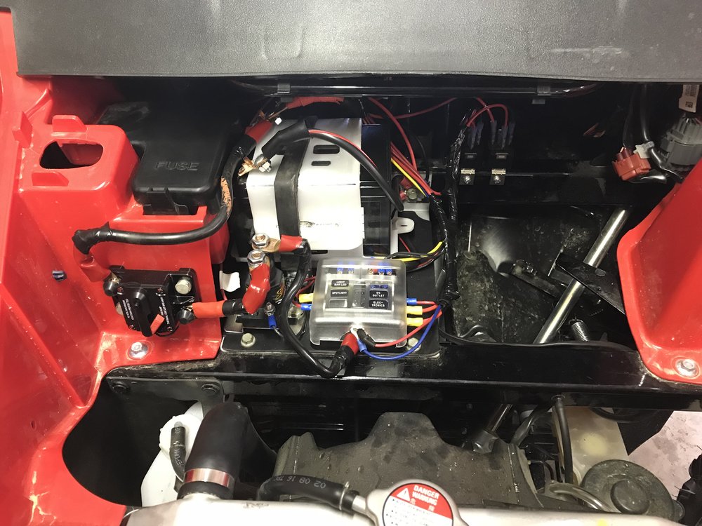

Are the kits any good? Or do you by everything seperate?
Yes.
Here are the most common ones- trueam
There are other methods.
But these TrueAm allow both batteries to charge while protecting the main from drain.

received. Type of batteries are used as secondary ( deep cycle or normal starting batteries?)

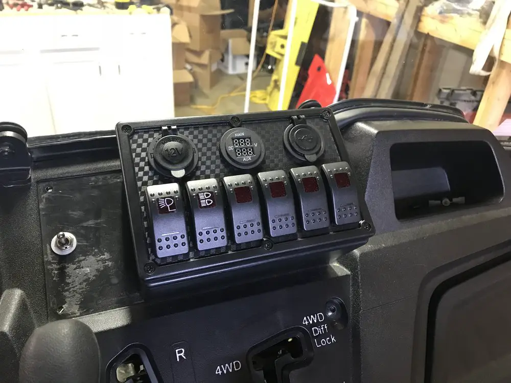

What did you use to raise the switch panel off the dash? I have. 2018 P700-4 and know I need to have a spacer or something similar. Any ideas would be greatly appreciated.
Pioneerguy700

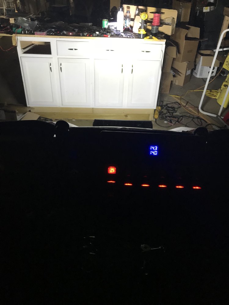

I have a bunch of plastic and aluminum “project” boxes from RadioShack. So I just used the one that was closest to the size of my switchpanel. Eventually I’m going to cut the top of the box down a little on an angle cause my shifter lever just catches the corner of the box. But for now it’s fine. I cut a hole in the lid of the box to fit my switch panel. I didn’t want a big hole in my dash plus all the dirt and mud ect getting on the back of my switch panel. That’s why I went with this style of setup. There’s only a 3/4 hole in my dash where I have the wires running thru for the switches.
Thanks for the info. I appreciate it. I was thinking of doing the same thing and get a pre wire panel with switches and meter.
Absolutely, the pre wired switch panels are the way to go. Not sure if they all are but I got a marine/boat one that’s waterproof. I also swapped out the single voltmeter that it came with for a dual voltmeter.
