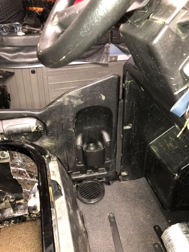

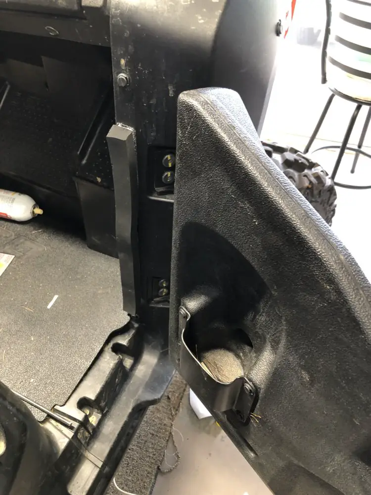

I bought some 3/4” x 1” waterproof sealing adhesive weather strip.
I have only done the front doors so far on my 700-4 as pics below.
It works great.
SOLID NO RATTLE DOORS NOW.
They are firm to close but feel like quality car doors🤣🤣
I backed up the self adhesive with some spray 3M glue.
