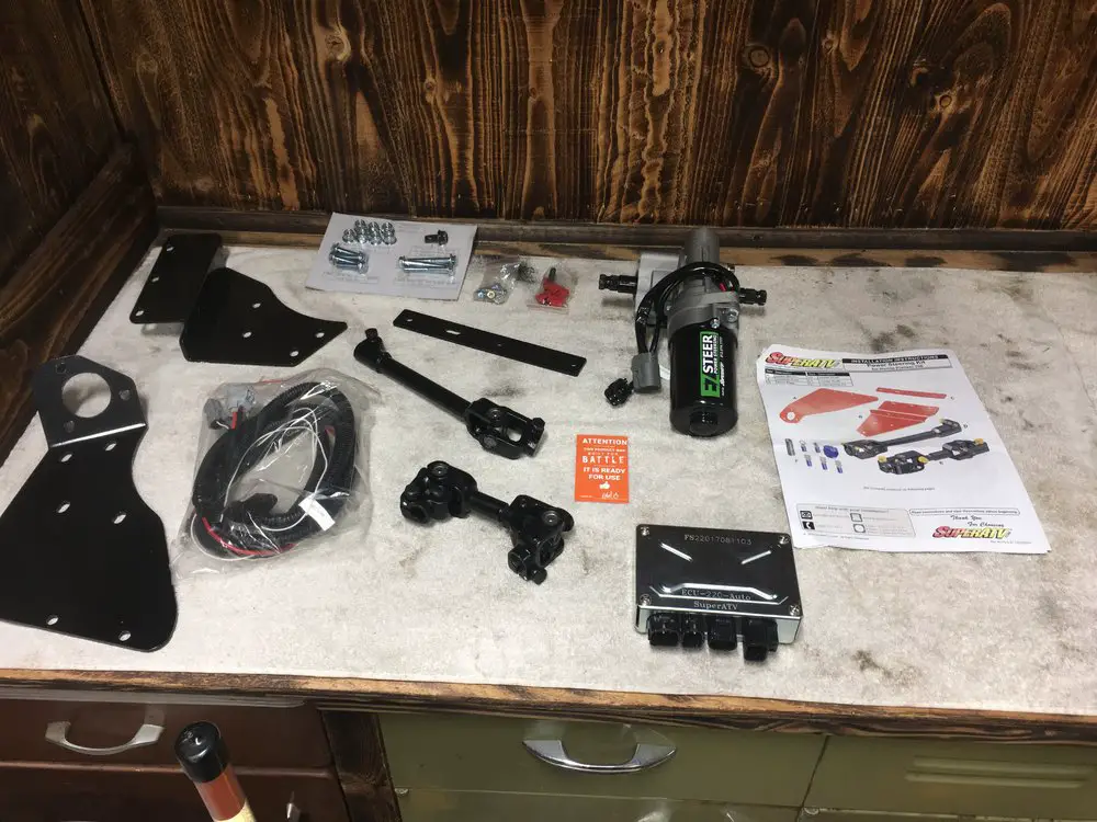

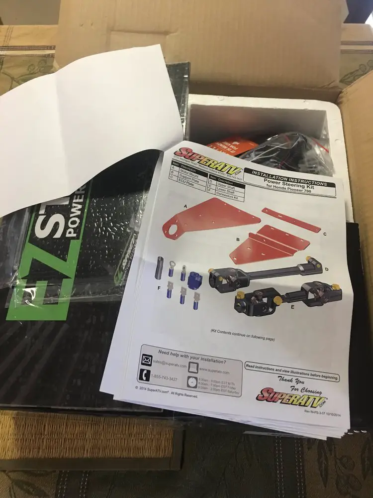

I ordered this Thursday night at 7pm.
Super ATV that was fast
Them guys don't mess around.....

IMG 3545
let me know how the install goes please. I got Friday as well waiting to warm up outside before I start it.
Ok I'm going to get on it tomorrow. Everyone is right. The directions and all the pieces make it look like quite the task..
