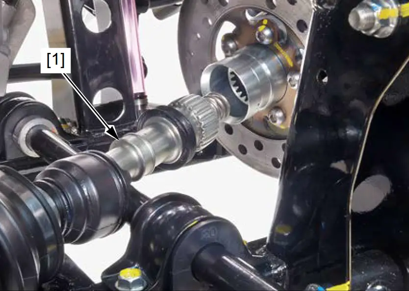

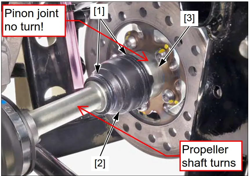

Our P520 has had a disconcerting rattle/clunking sounds at certain speeds coming from the rear final drive area since new. We never could find anything wrong looking/feeling/listening, but did not take anything apart. My kids walked home yesterday, and we definitely have a failed pinion joint. Drive shaft runs right up to the hub rear brake is mounted on, but that hub and brake disc don't move at all. In 2 wheel drive, there's no effort to move, and in 4x4 we get a 1 wheel spin up front (both until one slips). One wheel drive doesn't get far in winter!
1705984804554
Here shop manual shows what it'll look like with boot off (if nothing were mashed):
1705984858052

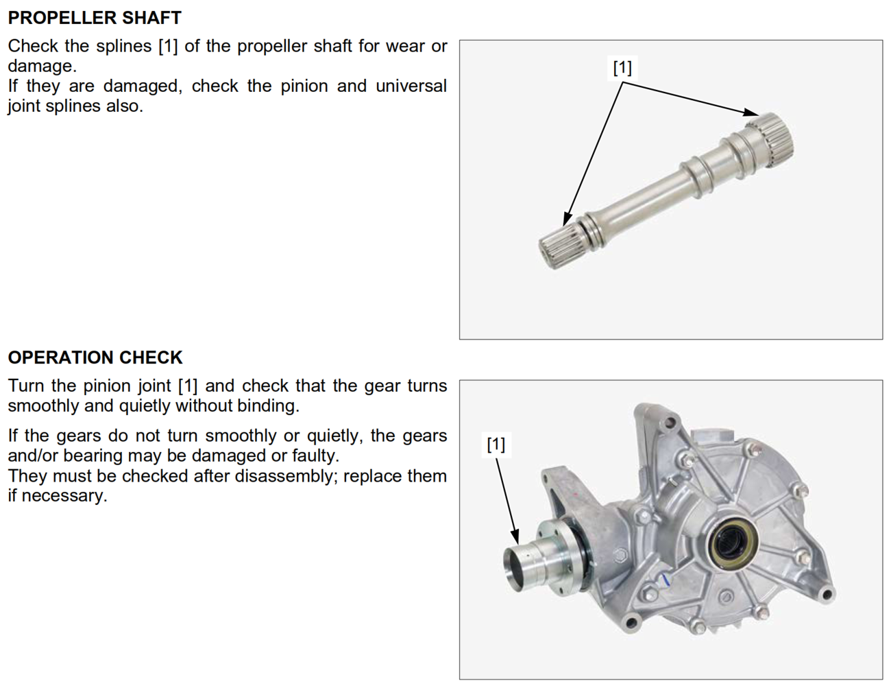

I found a couple threads where others had this failure:

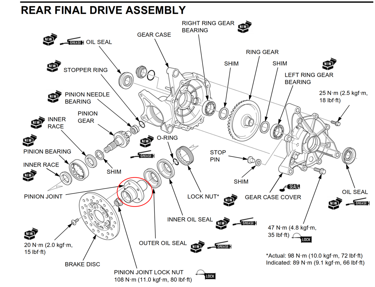

Looking at shop manual, it looks like this part is what we need to get to and replace. Anything else we should order to go with it?

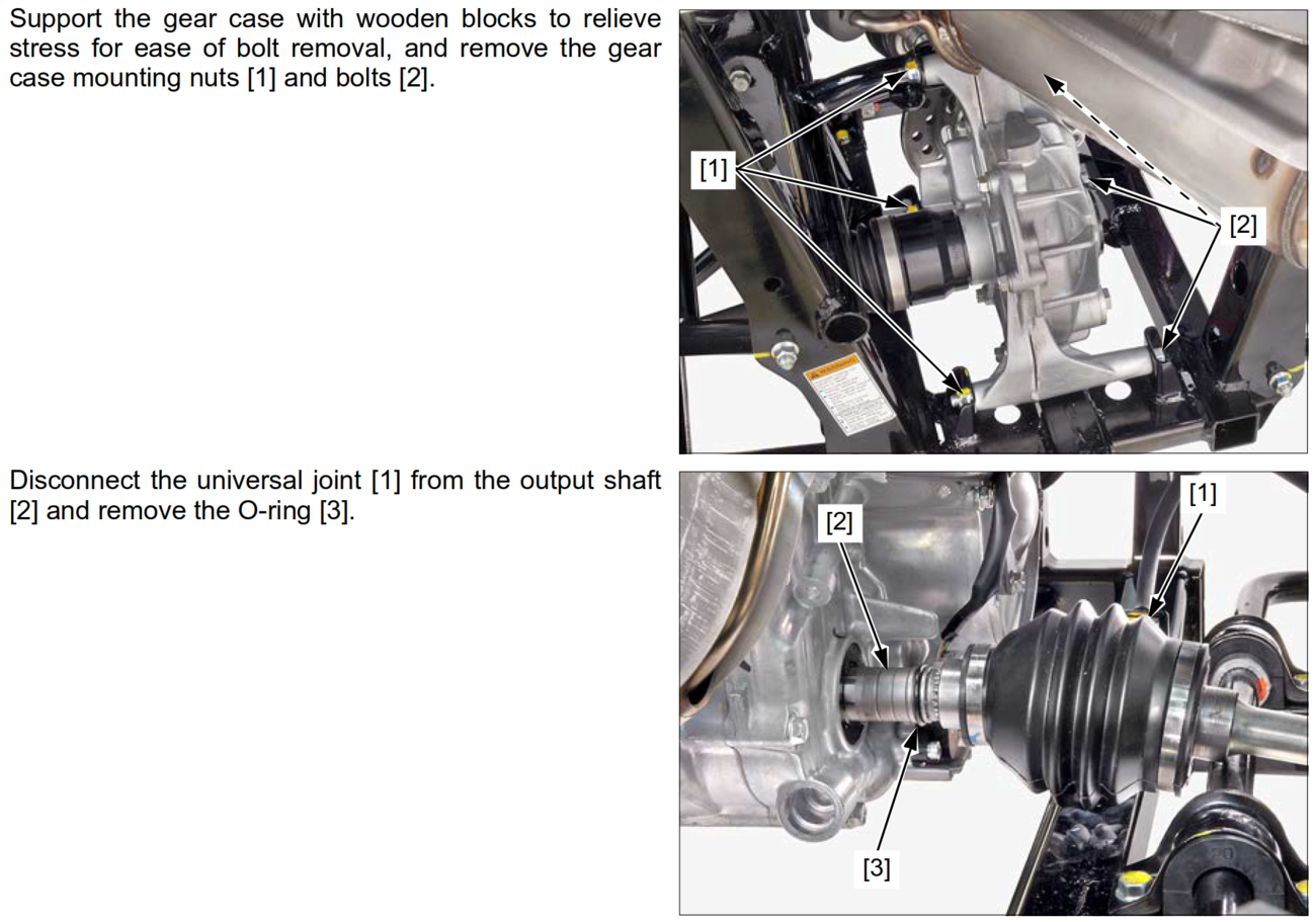

It looks like it may be possible to remove rear final drive mounting bolts and shift things enough to remove u-joint from transmission output connection and then pull it out of pinion joint.
1705985026467
1705985086356
I'm not sure if we can do this in place, or if we'll have to remove the rear drive shafts from final drive and take it right out.

You're on the right track on how to remove the rear drive shaft. I would recommend pulling the bolts on the front diff as well and sliding it forward about an inch before your start on the rear. If you don't the main output shaft in the engine will get pushed back from the spring pressure of the front driveshaft and roll the seal on the front cover of the engine......ask me how I know :rolleyes:

  12. Remove pinion joint from final drive, using pipe wrench to hold largest diameter of pinion joint and impact with 22 mm socket to remove pinion lock nut. Pull out carefully to avoid damaging dual oil seals (though Honda tech suggested replacing both after removing pinion joint).

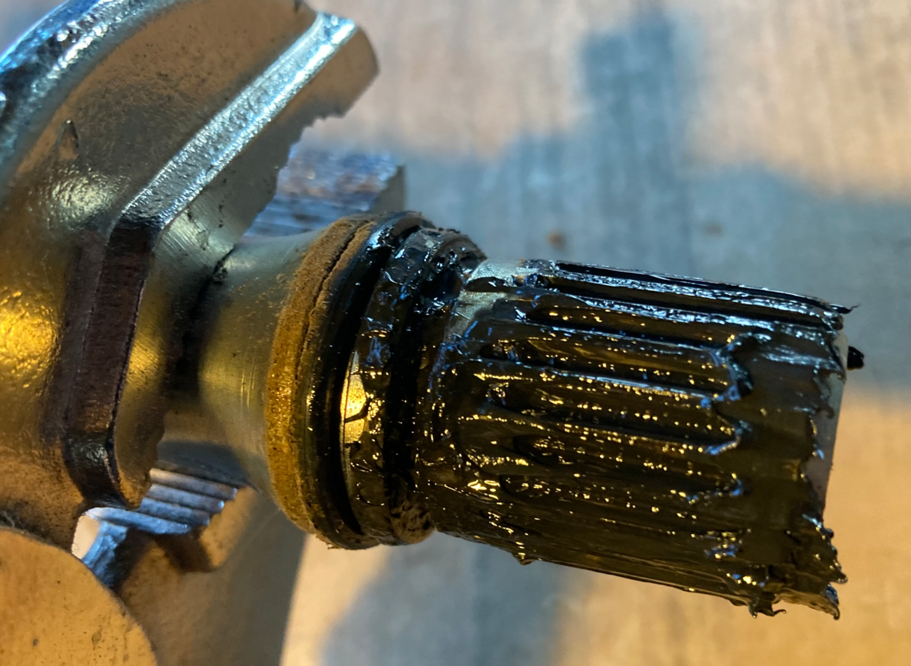

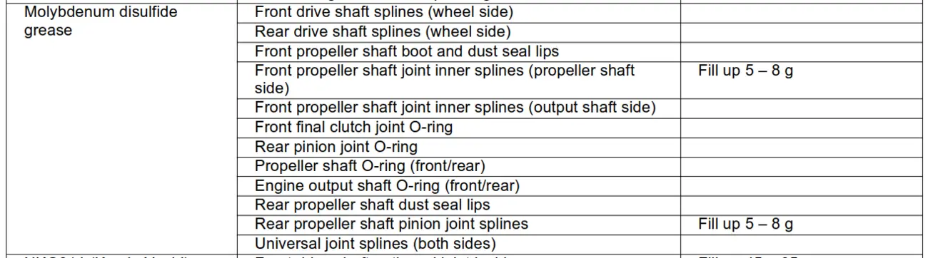

Is the pinion joint supposed to be packed with a moly grease (say 3-5% moly) or moly paste (~60%)? The failed one doesn't seem to have anything greasy--just powder. I'd guess there was some moly in the ground up metal, but no sign of grease.
Here you can see the greasy end of propeller shaft pulled out of u-joint vs. powdery end that was in pinion joint.
1707268154337
There was grease in the dust boot, between it and outside of pinion joint as well as between it and the dust seal that goes in groove in shaft at left side of dust seal in picture above. Dust seal is in installed position in picture above.
A closer look at worn propeller shaft end:
1707268225175
The shape of these teeth explains why the kids had better luck backing up than going forwards when it suddenly quit going:
1707268268349
Hard to get good pictures inside pinion joint--a bunch of this metal powder fell out when I took out the luck nut with impact.
1707268357434
The teeth in pinion joint were still full height at both ends, but chewed way down where they meshed with the splines on propeller shaft.
1707268478228
This doesn't seem like something that should fail at 3700 km / 450 h. The dust boot is original, was in place, was never touched before, and nothing looks dirty inside-aside from metal shavings. Could this have been assembled dry? Or did the grease just disappear in the metal powder? What could have caused this kind of carnage?

Neither Honda tech I talked to (two Canadian dealers) has seen one of these rear pinion joints fail. I asked what this should be packed with as service manual says "Apply 5 – 8 g of molybdenum disulfide grease to the pinion joint splines," and also uses the same terminology for the grease to go on o-rings, etc, while one tech suggested Honda's MH77 moly paste. After some back and forth, tech suggested packing the pinion joint with their MH77 moly paste and use grease with 3+% moly for lubricating shaft seal o-rings, etc. The lubrication section of manual shows this:
1707269327165
This seems to me to suggest a moly grease for all--more like what seemed to be on the splines at end of propeller shaft that was in u-joint:
1707269613517
What do you use on splines? Is MH77 the right stuff? Or should I use moly grease like the CAT Extreme Application Arctic (5% moly) I use on a CTL?

We ended up using the Honda Molly 77 Grease in the pinion joint. Given tube says it's 75 g and was half full of air, we probably used more than 5-8 g specified in shop manual, but I can't see that being a problem in this application.

We used the CAT Extreme Application Arctic (5% molybdenum) grease everywhere else that required grease (u-joint and drive shaft splines, o-rings, seals).
