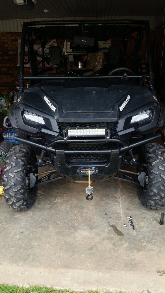

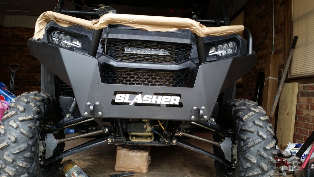

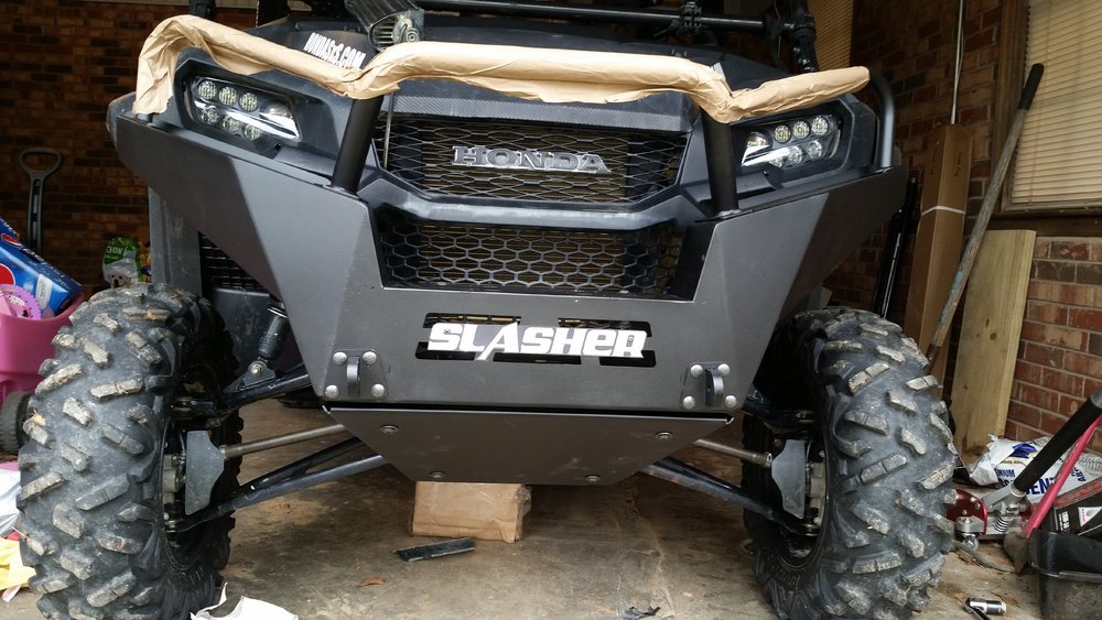

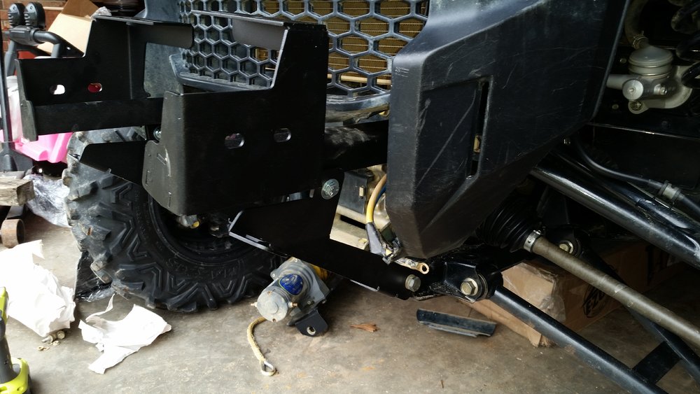

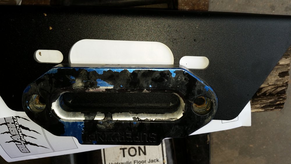

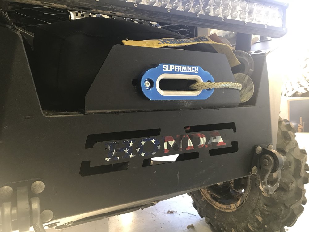

I fixed the one problem I had with the slasher bumper!
IMG 6316
Johnsee
Jul 3, 2017
40
Colorado

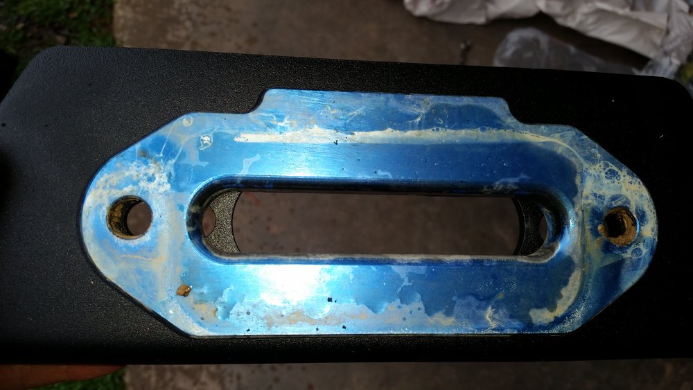

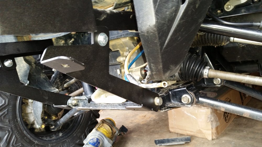

A few pics that make me scratch my head and WTF.
I emailed Slasher and said... you mean to tell me you make a failed that will accept wide spool but find it acceptable to have the plate cut the rope.
Do you have one made correctly?
Short answer - Nope! And no plans to make one.
One reason I have been slacking to post.
I suggest just using the mounting plate that comes with most winches. But I had already ordered this and kinda like it better than the other.
Also, I found bumper is not made for a super winch. Slasher says only Warn bolt patterns.
I ended up spending a few hours with the grinder getting it fitted up correctly. End result is nice but damn, a lot of work for something so stupid.

Looks good and I like the winch where you can see and get to the free spool knob. Brush bars could match the body lines better tho.
