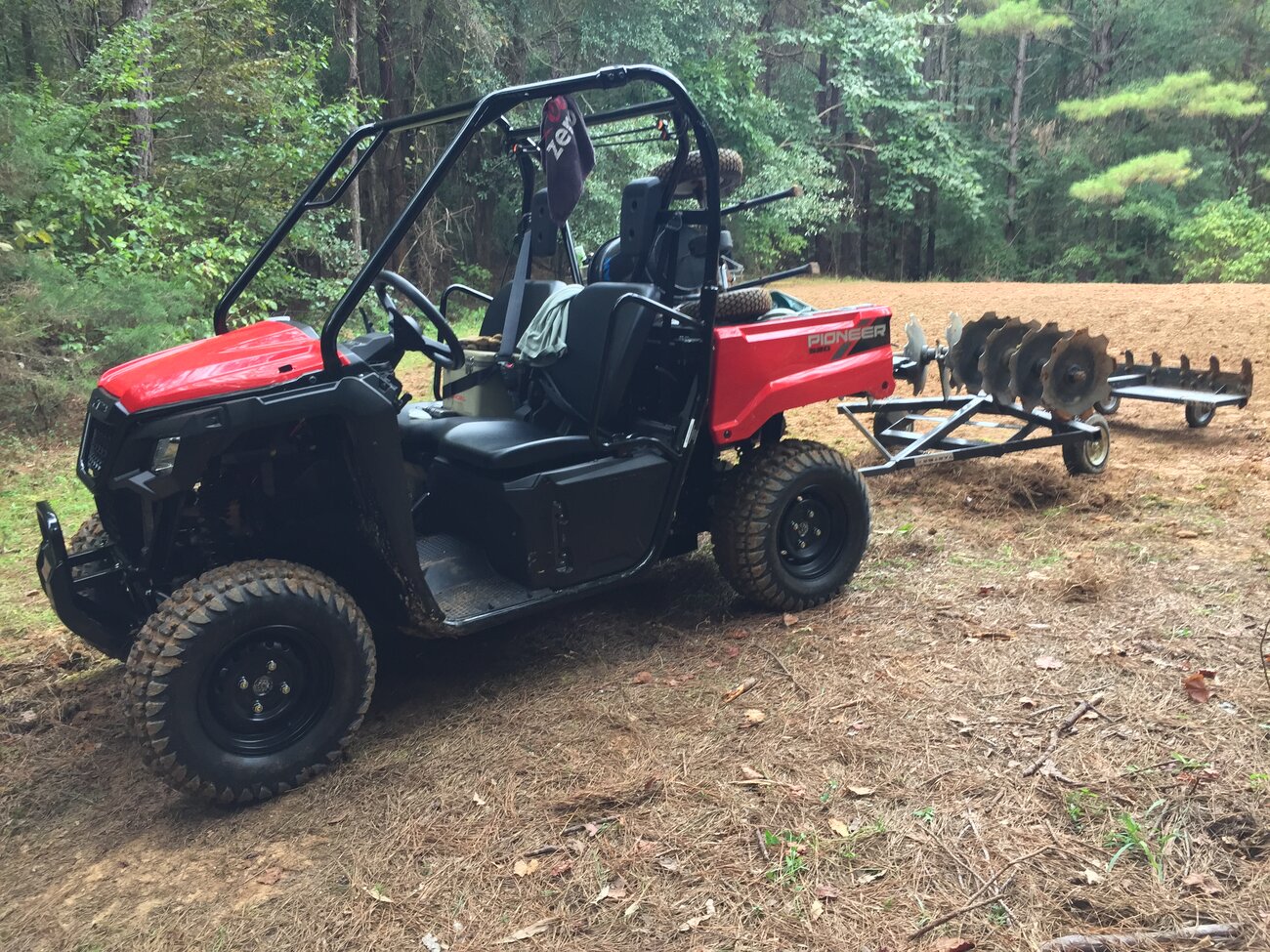

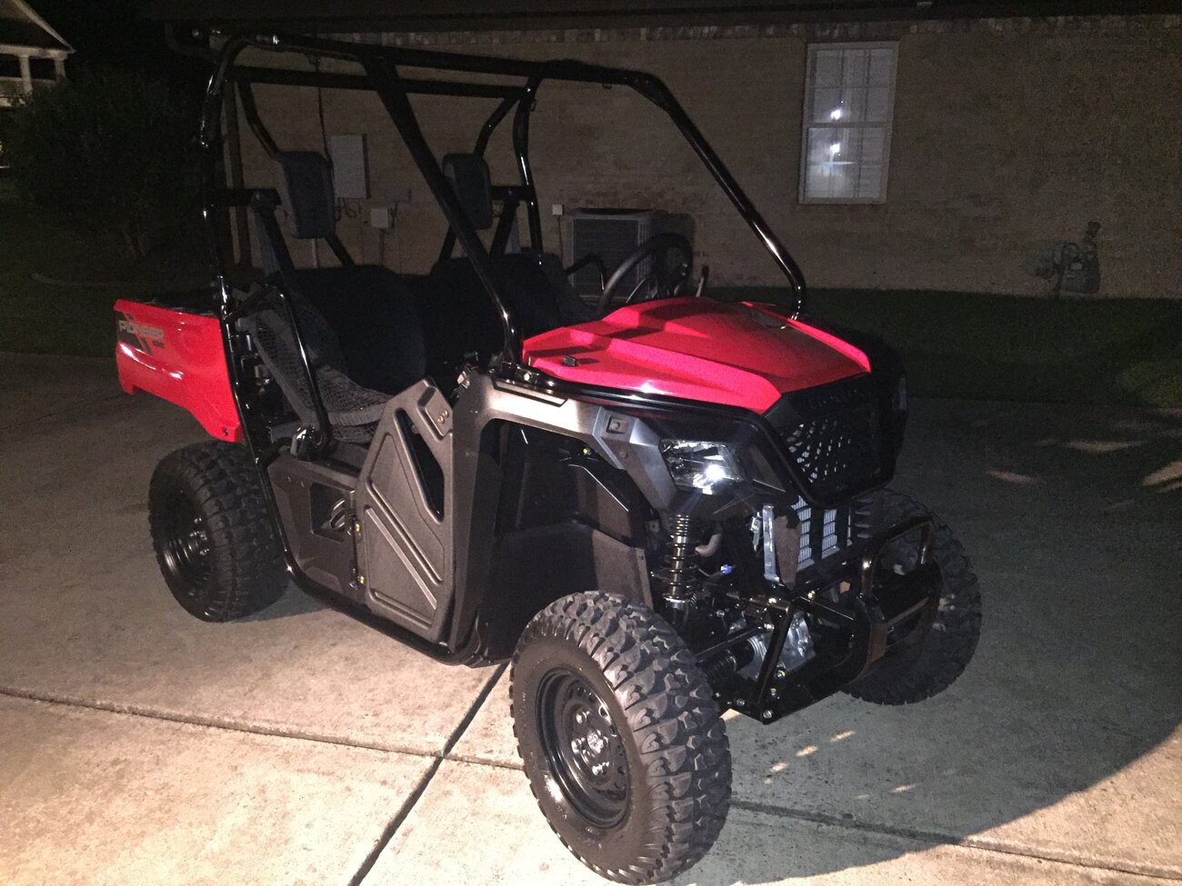

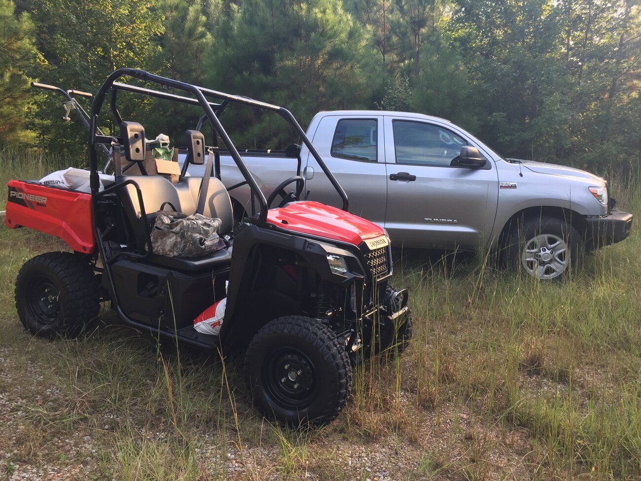

No special or interesting photos here, but since I understand they're mandatory on this site (it did actually happen) I've included a few. Strictly stock so far (door removal only change), since I just picked it up late last week and headed to the woods Saturday. Reluctantly forfeited some high-priority college football viewing (a big sacrifice for me!) since it was supposed to rain Sunday and I was already about 4 weeks overdue for food plot planting. Got a little done, a good bit more to do but weather isn't cooperating now, as usual.
Yesterday I researched and located a ramp I feel really good about so it's on the way. During next couple days I'll be ordering a glove box and roof, at a minimum, and likely an under-hood storage box and windshield soon. (Eventually the frame mounted 2" hitch receiver and a winch.) But most importantly and urgently I need to get some tires. Want to go ONLY TALLER, preferably 26s, not wider because I have to be able to load into my Tundra for hauling and wheelwell-to-wheelwell is 50 inches. I've found a modest selection in rear size 26x10-12 but nearly none in front size 26x8-12. So I may go 27s rather than only up to 25s.
Again, I'd really appreciate advice from all willing to offer on make-model of 25, 26, and 27 inch tires (8-12 and 10-12) particularly suitable for the 520, of course, and off-road/tractor-type use. I'll be in the 520 regularly but much more for basic transportation and work purposes than playing.
Thanks, I look forward to getting to know some of you guys, at least somewhat. Greg
View attachment 298584View attachment 298585View attachment 298586
The playing part will change!
