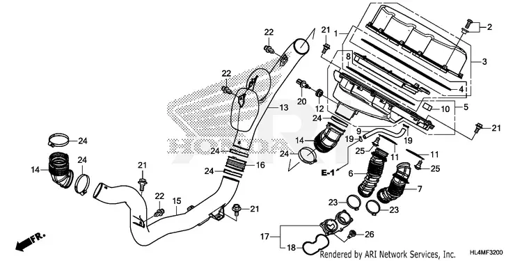

Sorry, The air element came with two o-rings.
one that fit and the other was oversized by at
least six inches.
Yes I already flipped the oil, oil filters and o-rings for them.

According to the parts diagram. 1 is for the case seal and 1 is the lid seal. Parts #4 and #8 in the diagram. This is a 2021 model.

When I removed the lid, there was no gasket but there was one under the filter.
Well, that explains it.
Thanks
That's what I thought first air filter service, the air box gasket was really compressed and I didn't see it. Don't see as well as I used to.

If you poke in the groove with something pointy, you'll find it's squishy, not hard like the plastic. The gasket is the same color as the plastic and hard to see that it's actually a gasket. You won't be the first to be fooled.
