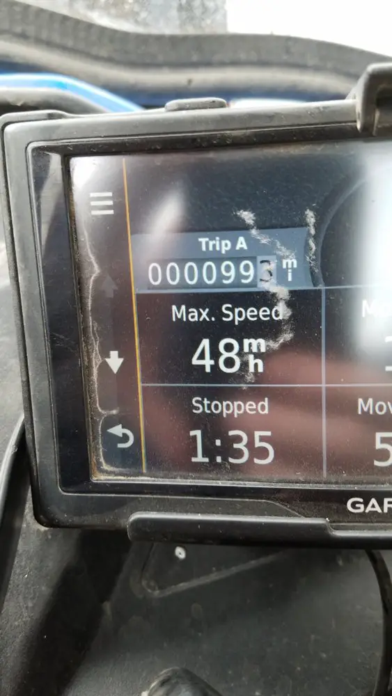

50 on the dash or 50 on gps?. the 700 is a speed limiter.
20180723 140423
This was from the 1st test run, I have seen 50 mph once or twice but that's as fast as I want to go in it. The purpose of the mod was never just to see how fast I could get it to go. It was about bringing trail rpms down, UP here the trails are abandoned logging roads, 2-tracks, etc. It's easy to run 25-35 mph all day long. With the OEM gearing that meant the P5 was running at it's limit most of the time. Now it can cruise along without sounding like it's about to blow. Top speed is just the easiest way to measure the difference with the new gears.

The mod involved swapping 2 gears in the transmission and since the P5 speed sensor pick up reads off one of these gears a SpeedoDRD(electronic gizmo) was connected inline between the senor & harness to adjust speed sensor signal to the ECU/dash otherwise the ECU get's confused because the gear teeth count is not stock. The speedo still reads 42mph at the limiter in 5th gear but actual ground speed is 50 mph. Here's the write up I did when I finally figured out the mod.

On the P5 it's not limiting on the speed sensor alone, it's a rev limit based on rpm & gear position but the ECU is monitoring speed. For example, in stock trim I would hit the limiter at 41-42mph dash indicated in 5th gear. As a test I put the SpeedoDRD on before I did the gear swap and tested a few different settings, I could "trick" the dash speedo into reading anywhere from 38 to 45 mph before I hit the limiter, if I went too far with the signal adjustment the ECU would go into limp mode and I would get the "--" on the dash and the trans wouldn't shift. The ECU is expecting a certain speed range (sensor signal) at a given rpm/gear. The original trans final drive gears were 1.875 to 1, the new set is 1.48 to 1 so the SpeedoDRD was used to make the speed sensor signal on the new gear match the signal of the old gear at a given rpm. The result is the final shaft output speed to the driveshafts is increased but the ECU sees it as matching the original programming.
I would imagine the P7 has similar programming. It may not be as simple as tricking the speed sensor alone.
