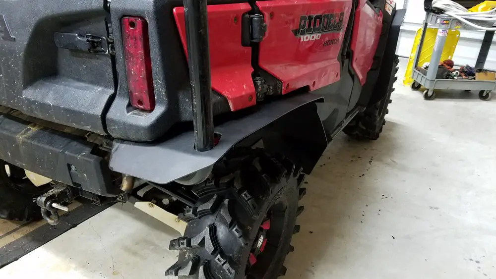

You’re going to need washers on your upper shock eyes between the spacers.

Yep,they came with the lift.

Note: Honda Pioneer LE models require 1" wheel spacers with stock and aftermarket wheels. Same would apply to non LE models if running their lift with fox shocks. I removed my lift last week and plan on fabing lower control arm lift brackets for this reason.
I ordered 1.5" spacers for the rear from RB3 and will install this weekend.

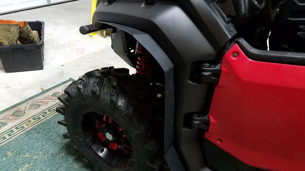

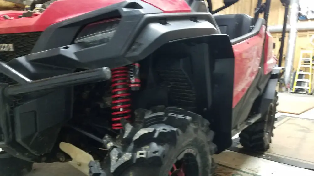

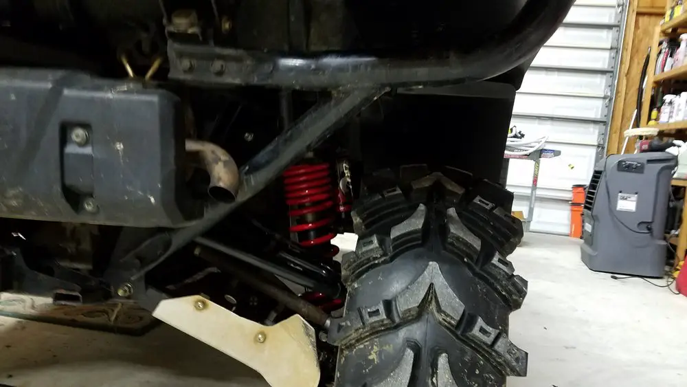

I ended up taking the rear lift brackets off mine as the rear tires set V and the shocks we're stiff. The front bracket I moved the shock mounting holes in about 1.5" cutting the excess off. So I have the modified lift brackets on the front and none on the rear. Looks good and rides even better.
