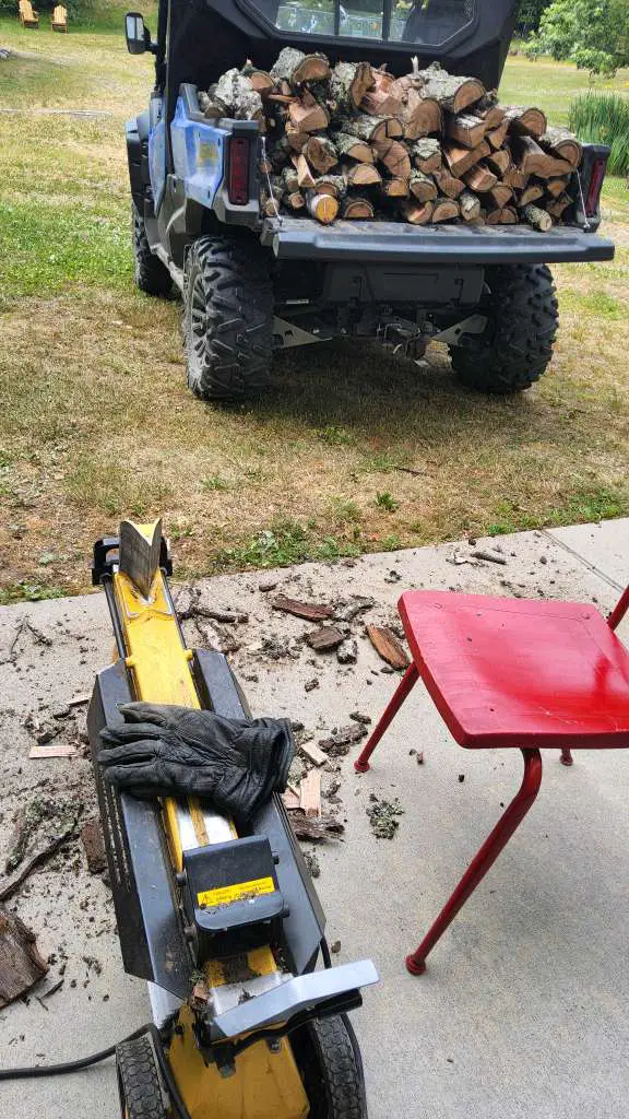

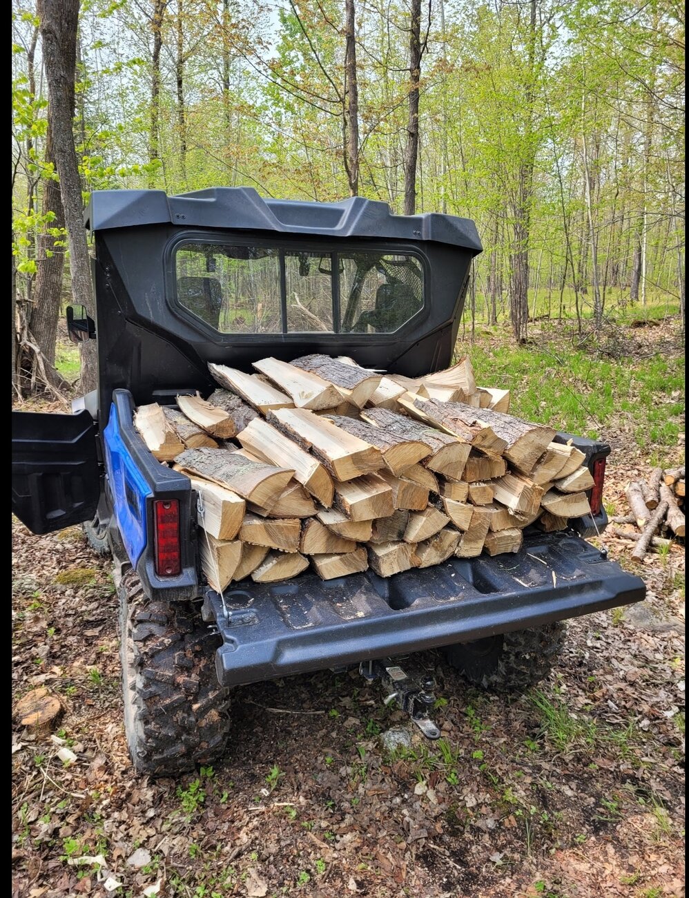

This load is probably a little closer to 1000 lbs.. green fresh cut maple.. I have used a trailer at times but it makes it a little more difficult to get it out of the woods where I go.
As long as you're not bottoming out and damaging anything, I wouldn't upgrade for this.
BUT ... I would (and did) consider upgrading (including stiffer springs) for the benefits you will enjoy both on the trail AND when working your machine hard like this.

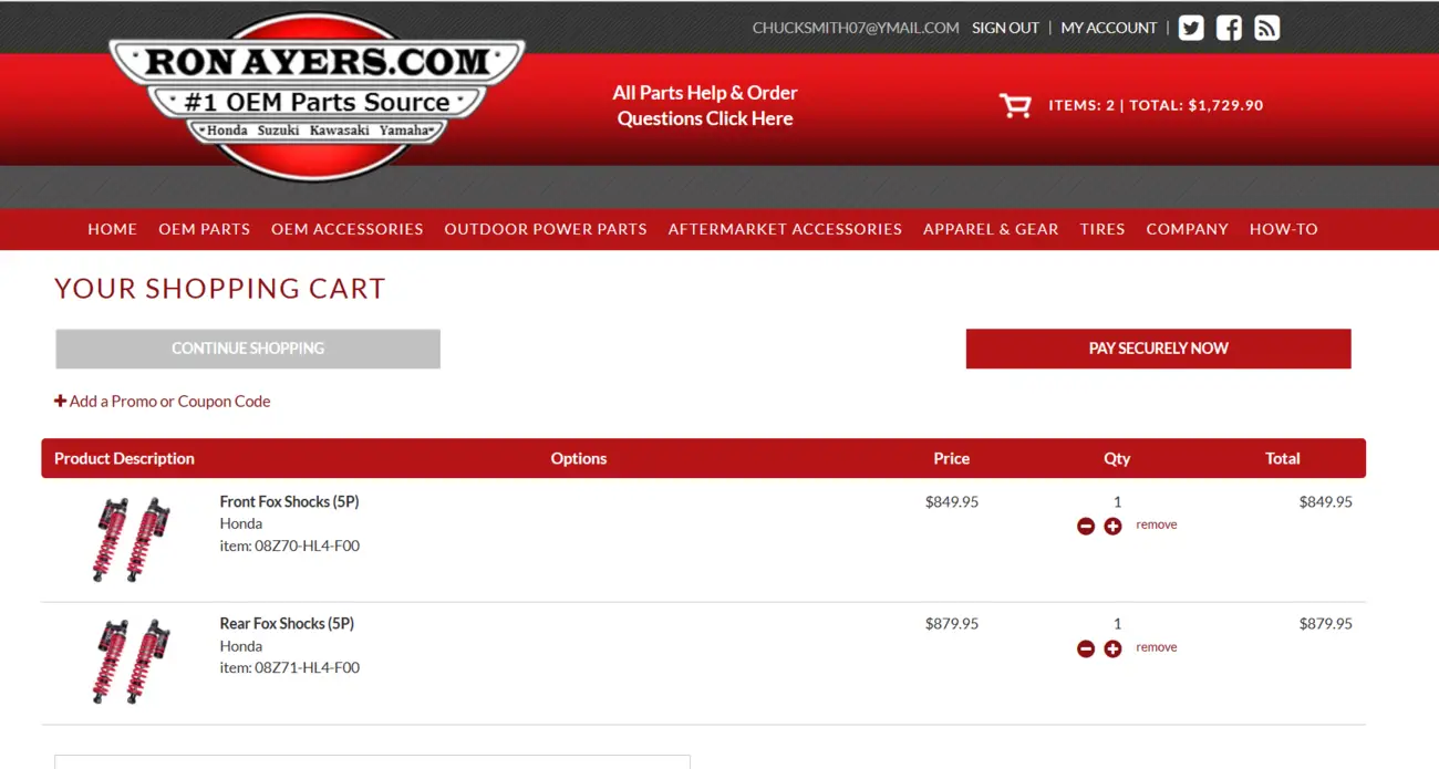

What am I missing? I even went to my laptop to see, I signed in and everything. I updated the shipping again and still no price change.
IDK. I've never signed in, on anything other than my phone. I would empty cart, sign out, sign back in, add shocks back to my cart and then go to view shopping cart. It worth a shot. If it doesn't work, I would call and order over the phone.
Call them. They actually give a forum discount that puts it at the $1460 range. They are really easy to work with.

I finally got it, created a new account and it worked. I called them they have 10 of each for the 1000-5. They had the best price also. Found another place they were 1500. That was the closest.
