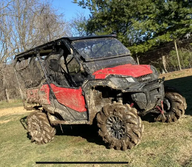

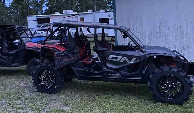

I only own one P1k5, 3” TTC, 30”OL2, IGR, All Cops tunes before IGR, FCP Tune-IGR & Talon Reverse, Bandit Shocks, TC snorkel, SATV Flip up, Dual bat, Warn Axon winch, Tusk Full Roof, roof fans for summer snow plow for winter in VA.
Dads toys-
2016 P1k5. IW with the 6" lift, Talon Revers. Yes clutch upgrade-recall, TC Snorkel- had 30” tires will put portals and 35” tires and FCP tune when completed. Honda Roof
Honda Big red 500. - All stock with a winch. " The yard Pig"
Honda P700-4 - FWD arms 28" tires TC snorkel,
P1k5 2022-- TTC 3" – 30’ boggers, 3” TC Snorkel
Talon 4seater 2020, offset FWD Arms, 35” tire, 3” TC Snorkel,
We mostly ride at River ranch. But I'm trying to get some to make it to one the events just get to busy with life.
