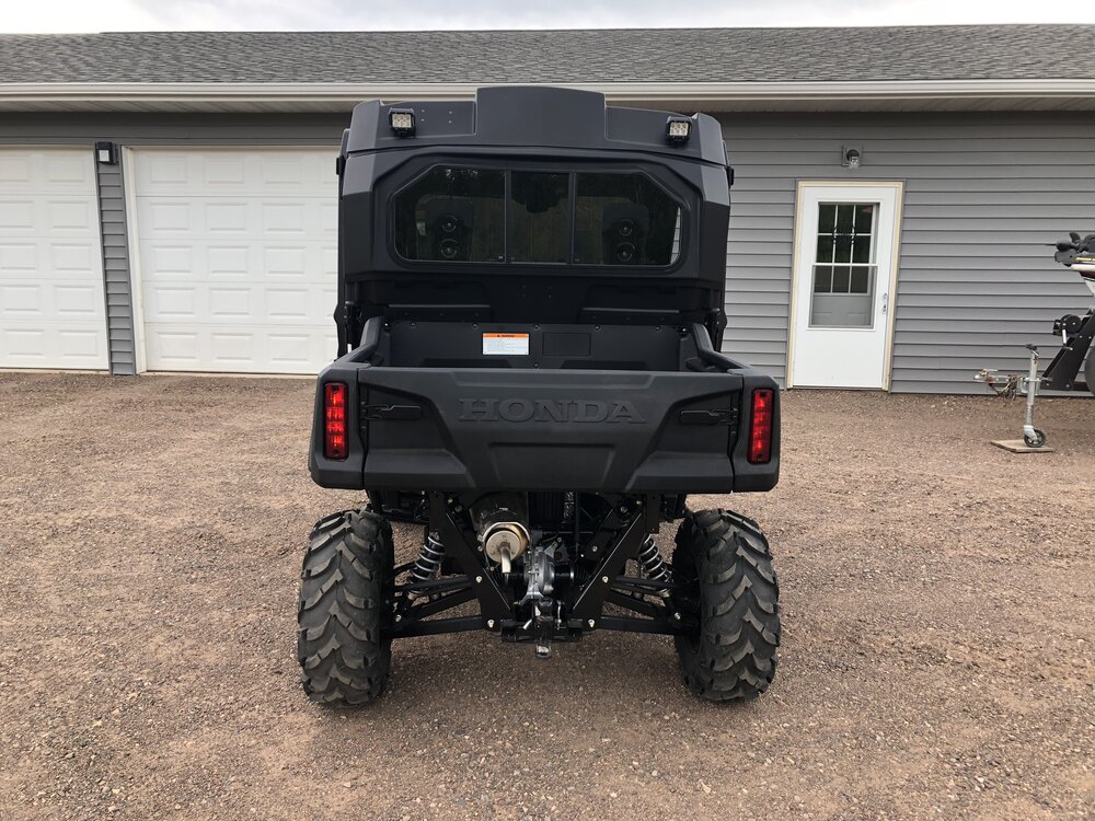

I have the OE hard cab enclosure and mounted a set of led pods on the back of the roof. I ran the wires along the roll cage to the dash and wired them to a two way switch, one side they are on when key is on and the other way they are wired through the back up alarm plug so they come on only in reverse using a harness from the SXS store.

I have the OE hard cab enclosure and mounted a set of led pods on the back of the roof. I ran the wires along the roll cage to the dash and wired them to a two way switch, one side they are on when key is on and the other way they are wired through the back up alarm plug so they come on only in reverse using a harness from the SXS store. View attachment 238355
That sounds ideal.
