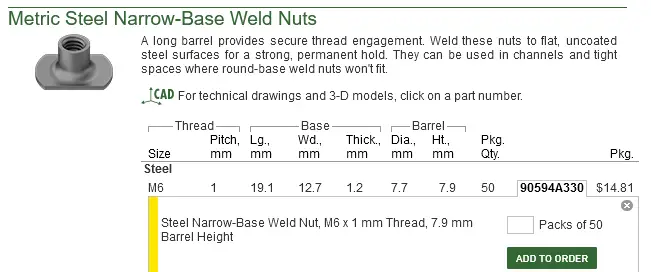

I have m6 weldnuts for my offseason repairs.
1660913703004

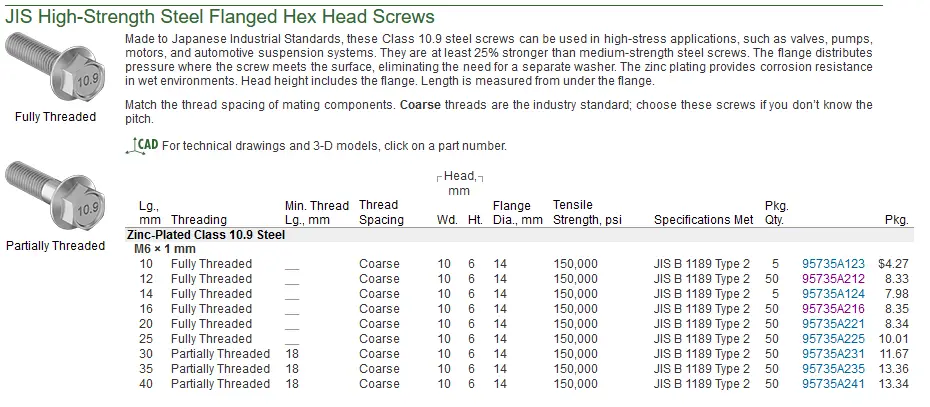

I plan to tack these in when I do my once over for the off season.
I am planing on use these bolts to attach to the above nuts.
Stainless hardware is softer, when ever I switch to it I usually upsize a bit to compensate, and I always use antisieze cuz stainless likes to gall.
McMaster is the place for ALL your needs, and anyone living in NeOhio can do willcall and pick it up shortly after.
