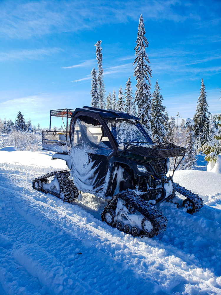

I had a 2015 with no issues so I picked up a 2018. Lately, its been bogging down on the top end randomly. Itll start out bogging and eventually clear up and run fine and then bog again. Even when I shift to a lower gear, full throttle will never rev the machine up. I added some injector cleaner and my last trip (10 miles or so) it seemed better but not completely. I keep reading about the exhaust problems but didnt know if itd been corrected in the 18s.

I dont have any mods or a snorkel. Its all stock other than the tracks I run during the winter. Id seen where guys had a problem with a baffle in the silencer breaking loose and plugging the exhaust.
