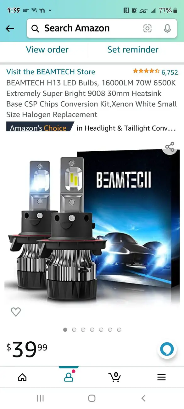

These are the ones i got. Not the most expensive but work well. Just make sure to follow directions and orientate the light the right way. Everything fits in the stock housing too.

So to be clear, H13’s work with the 22’s?
thats what the 16-21’s used.

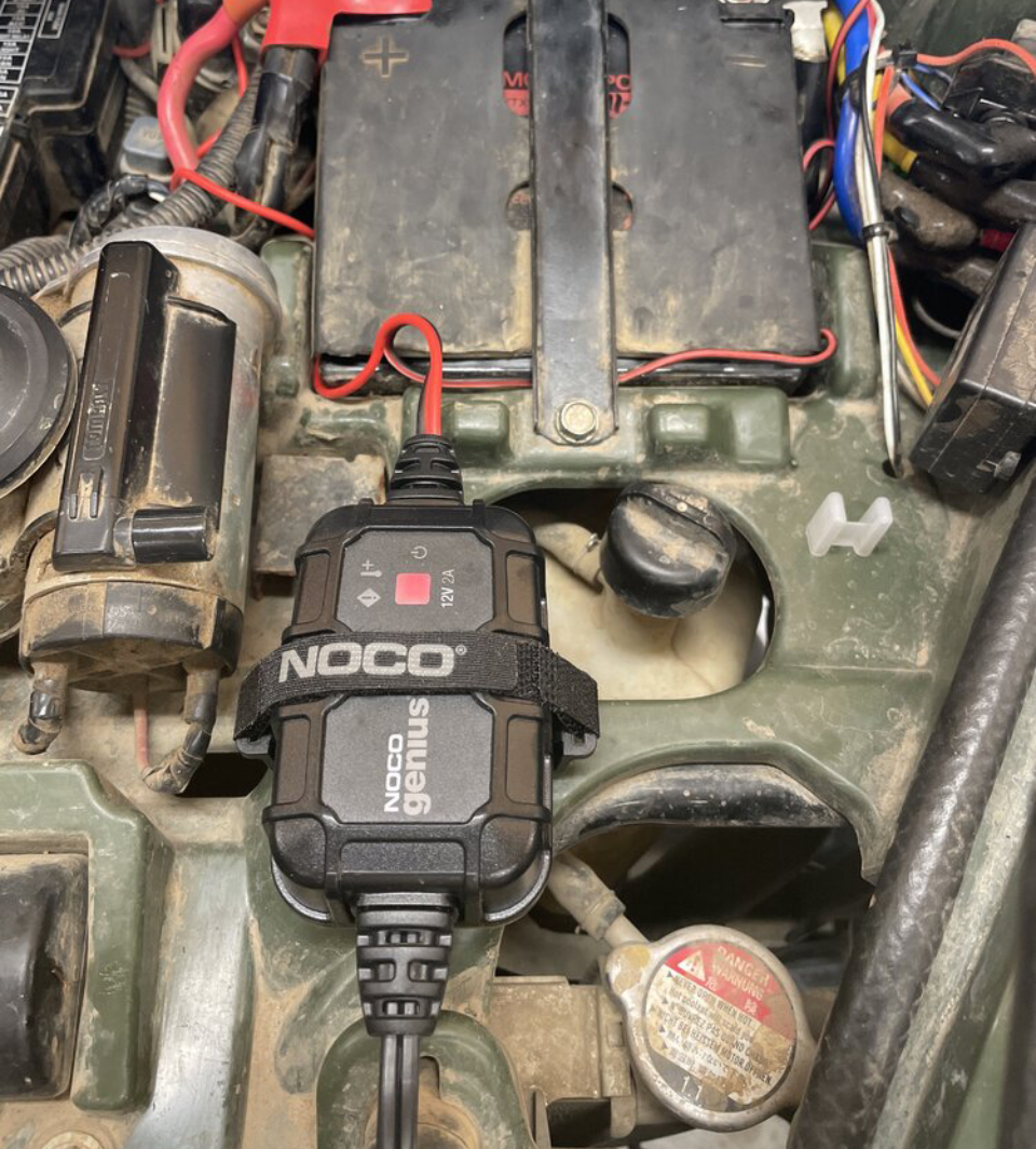

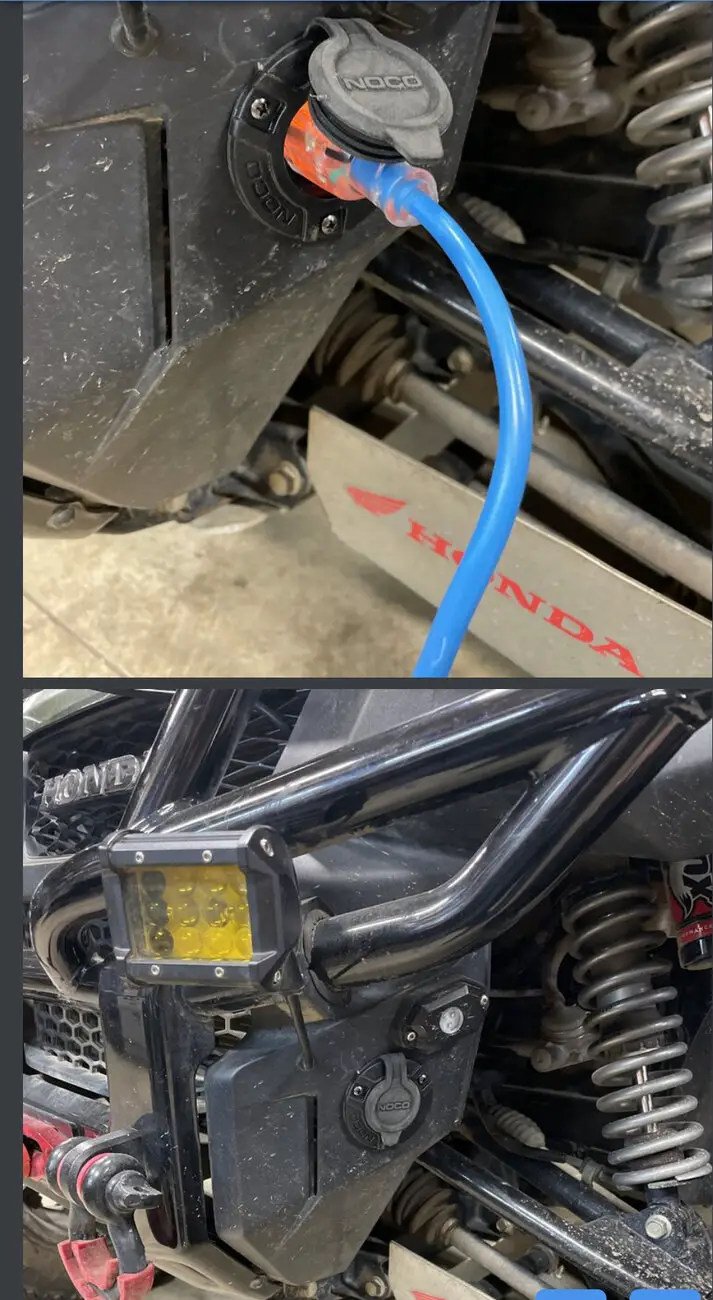

Hook up a permanent trickle/battery tender charger like mine. Will charge both or one when not in use and that battery will last a very long time past its expectancy.
my cabin in in Northern Mi where my P1 is most of the time now frigid temps in the winter. Hook it to that tender all the time No problems. 😉

What is the round can like thing with 2 wires coming out in the front?

There are 2 pics there. Im guessing your thinking next to the battery? Its my air horn the std horns sound like a fisher price horn. I wanted to be heard. Look up my build and you can see details on all of my mods For my P1

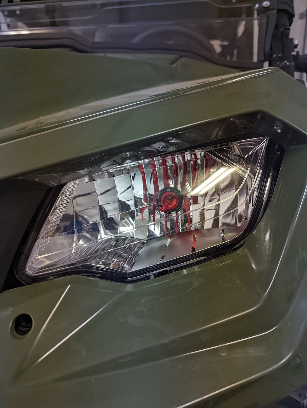

I can confirm that these work and work well. https://www.amazon.com/dp/B07SZMVNC7?tag=sxsweb24-20

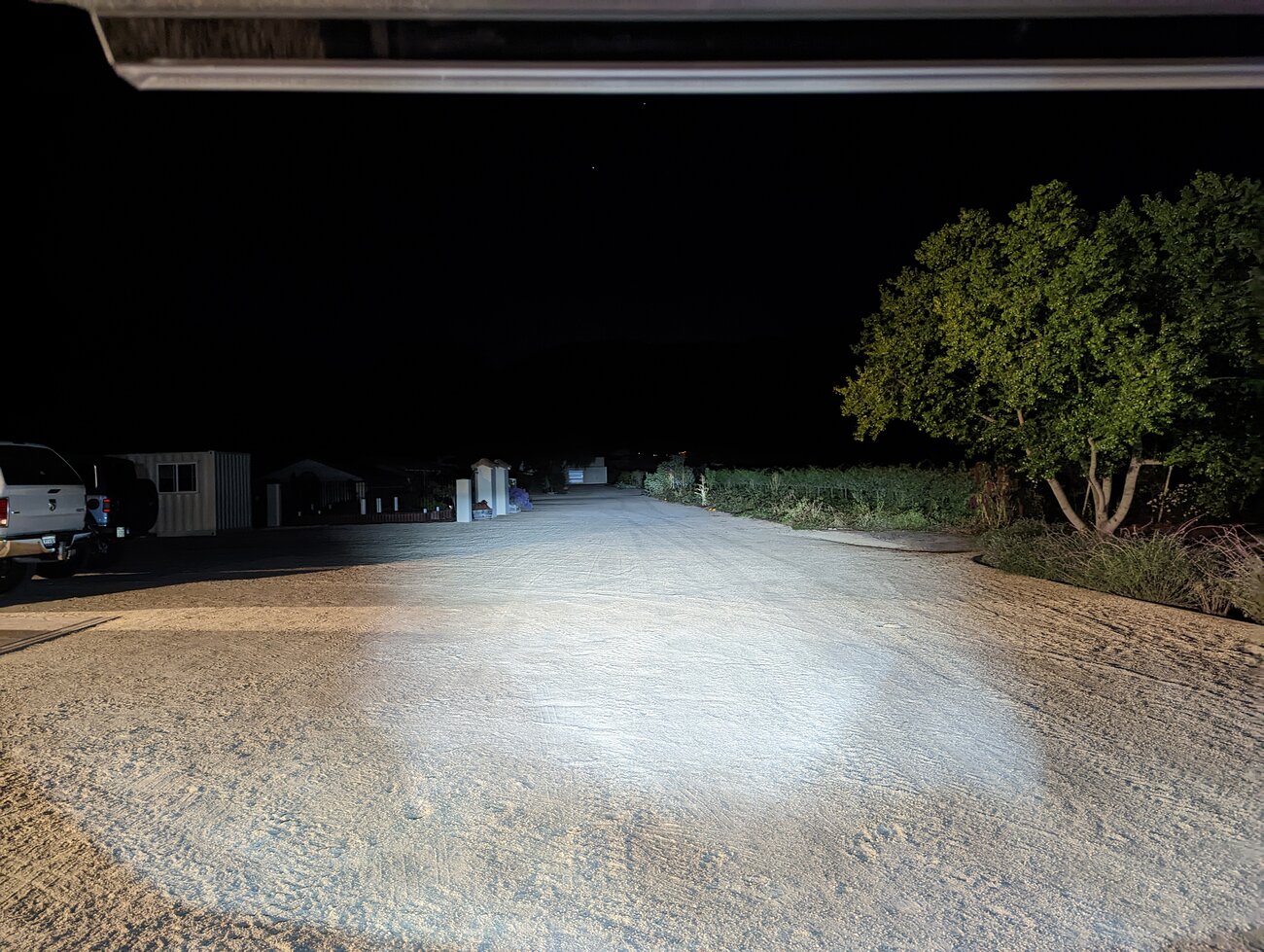

They very bright and carry much better than stock. They tell you to mount them with the LEDs at 9 and 3 o'clock, but, because one had the locking ring in the wrong position, I ended up with one at 10 and 4, and that one worked better so I removed a couple of screws and rotated the other one to be the opposite at like 2 and 8 (see picture), and now they work fantastic. Since they are made of red aluminum, they reflect a little red when you see them in day. The high beams are quite high, but if I remember correctly, the factory high beams were similar. They are much more powerful and provide a better light than the stock bulbs and for $40, they are well worth it. I would have paid the $400+ for the Honda LEDs if I didn't have to take the hole machine apart to install them. In the photo, that white roll-up door that you can see in the middle is 450 feet away. That is on low beam. I have huge LEDs shooting from the house on the left that is kind of washing out the headlights up close to the machine making it look under lit in front, but that isn't the case in the dark. The house leds are a warmer temp, soo the more white light is headlights.

They should have come with an allen key. There is a small allen bolt you can remove and orientate the way they are suppose to be. I wanna say mine was brights on top. If you put them at the right spot you will get a better throw out of them. Mine was 12 and 6, but i had to adjust them to get it there. Just my 2 cents

I agree, I if you have a bit of time, you could play with the orientation a bit and figure out what works best in your housing. These came apart using a Philips screwdriver.
