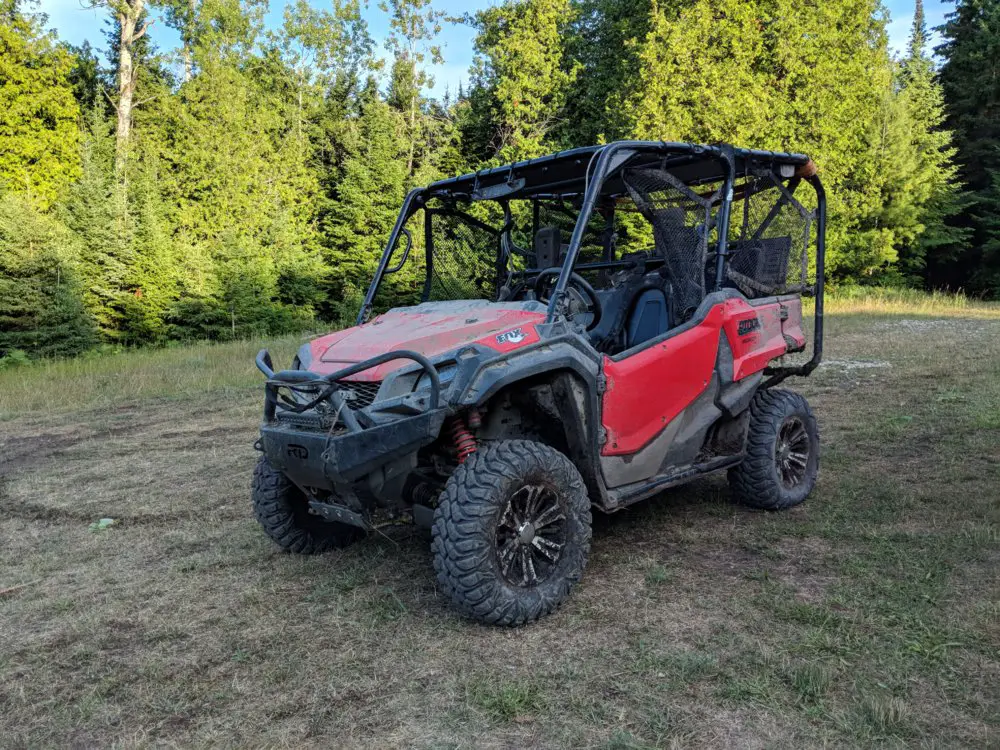

Todd - Do you have yours mounted on stock deluxe rims? If so, how are they for looks and handling with the 6.5" front wheels and 8" back wheels? Any side view pics of your machine? Thx

I had them on stock wheels. They are on 14x7s now. The stock front wheels are kind of a pain to mount being so narrow with such a square profile tire. The stock rear wheels are probably too wide for a 10" tire. I struggled with rocks and dirt in the tire beads on the back.
This is with stock wheels

Ahhh, kinda what I was concerned about... I want to immediately sell the the stock Bighorn 2's and don't really want to fork out the coin for new wheels. I will find myself in mud and rock but the majority of the miles will be on hard packed gravel roads. An 8 ply radial is what I'm after but there doesn't seem to be much width options in the 28" tires. I may have to reconsider the Blackwater EVO's in 28-9 & 28-11.
