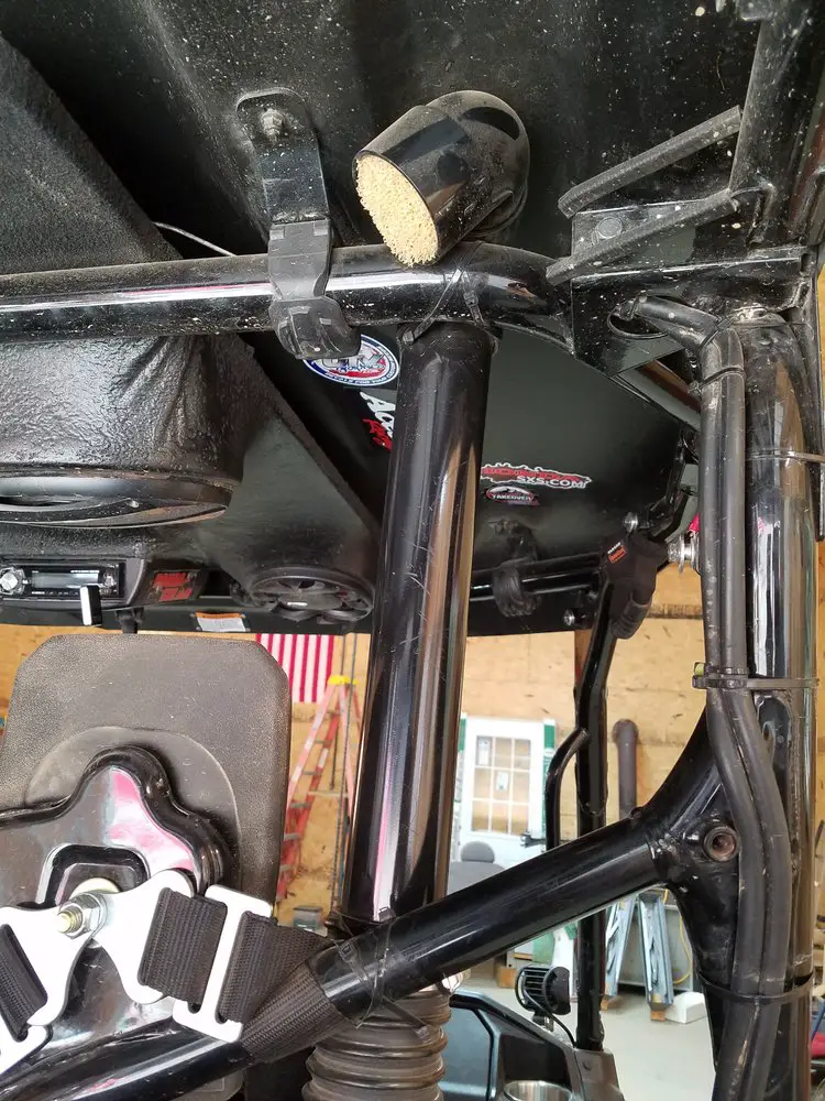

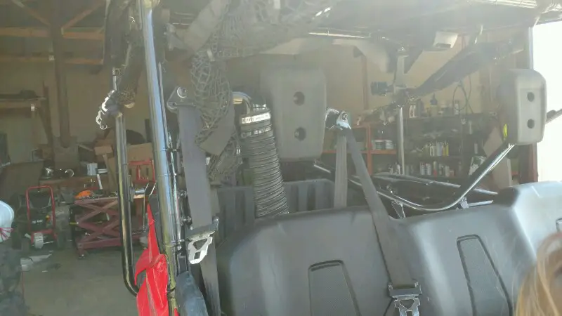

Found them. These are for the ebay snorkel kit. I pulled the seat back off on install..super easy that way. Then used a short piece of 2" and ran it to the roofline.

I made the same snorkel for mine just got some flex hose with metal wire so you could squeeze it down for the bed and it wouldn't pop back out and use PVC fittings had to use like them thin-walled schedule 30 and hose clamps it was a little aggravating but a lot cheaper I even painted my feelings black so they didn't stand out like that one is but I like it better because it don't interfere with if you have doors like the one that comes to the cup holder and it keeps it completely out of the weather underneath the roof

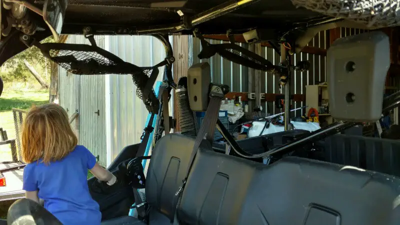

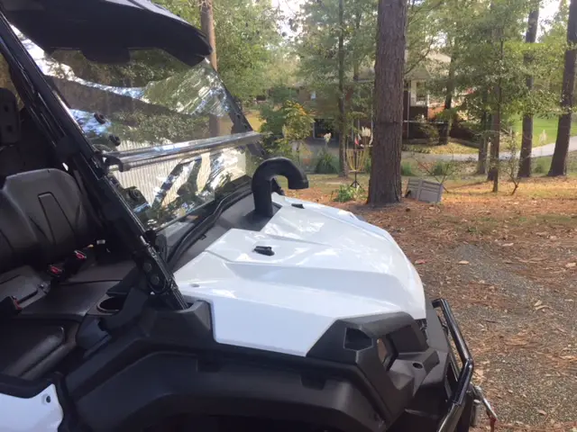

I didn't like it interfering with the seat belt. I must've cut a dozen cable ties moving it back and forth lol. Kinda happy with it where it is now, but will probably move it around some more before I'm done lol. Love the intake growl when engine's under a load. Got that cold air intake sound going on. Wife doesn't use the headrest anyways lol. Hose was a tight fit trying to get it behind the coils. Other than that it was a cake walk.

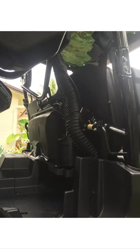

Were did you get the flexible piping setup that is in the cab?
Delton
Delton
Honda Fanboy
Jan 6, 2016
9,967
31,488
Middle TN

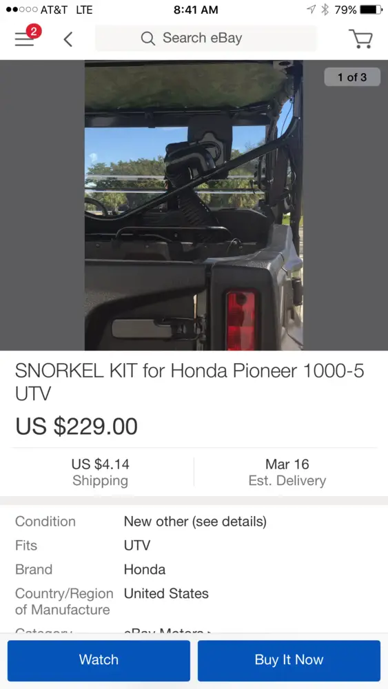

Flexible hose came with kit i got off ebay. It looks flimsy but is extremely tough. I stood on mine and it didnt budge (200lbs).

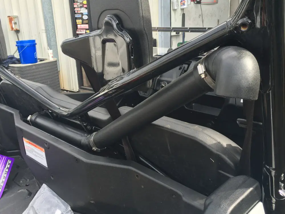

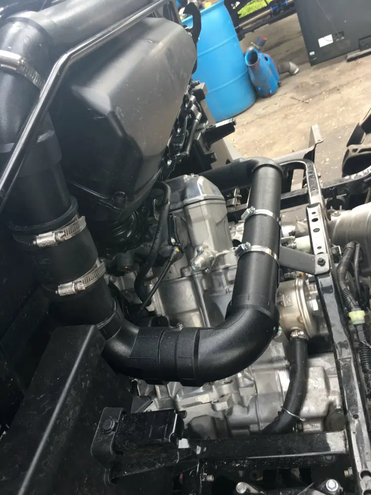

So I did this the other day.
Going to take that 180 off and add this.
SYA Warrior Riser Snorkel Kits
Parts needed I used part# 14 in link below. Took the one off the SXS to use to make it till the one I ordered came in.
2016 Honda Pioneer 1000-5 SXS1000M5D AIR CLEANER Parts - Best OEM AIR CLEANER Parts Diagram for 2016 Pioneer 1000-5 SXS1000M5D Motorcycles
Other items. a female to female 2in straight pipe connector Black, 2in black pipe, 2 hard 90s.
The female to female was needed to connect to the #14
Thought I would show some better and updated with the better snorkel pics
IMG 1504 IMG 1423
