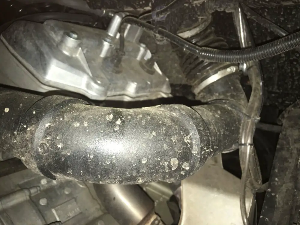

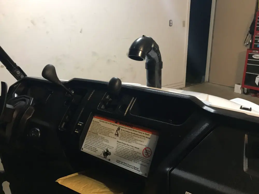

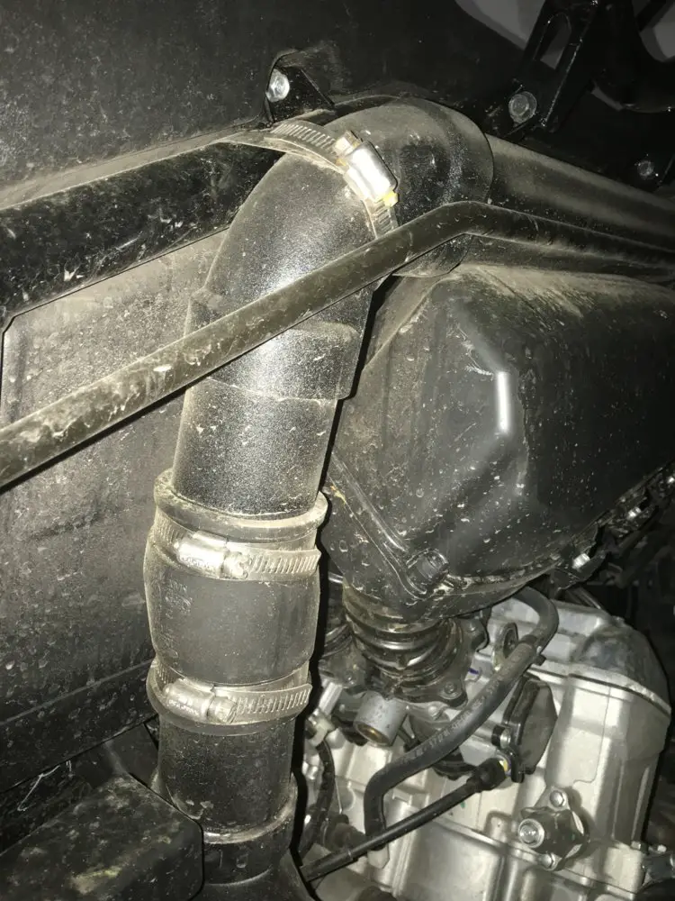

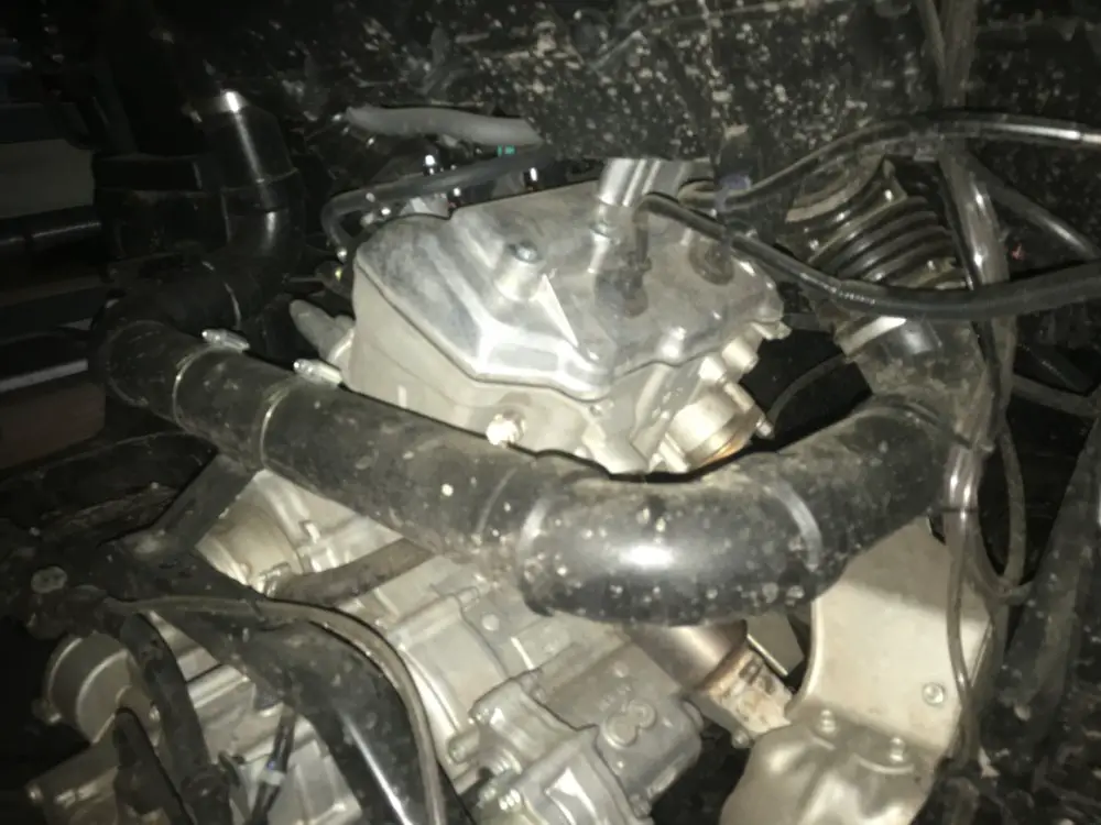

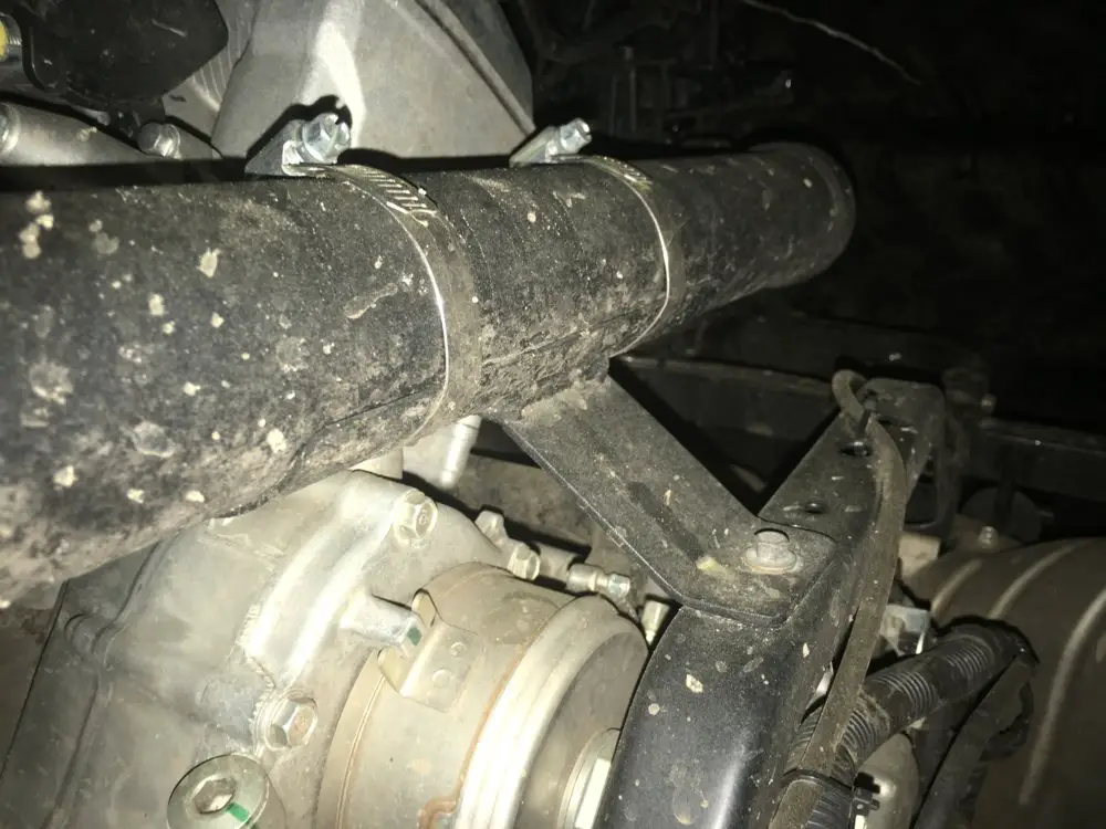

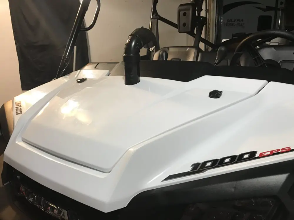

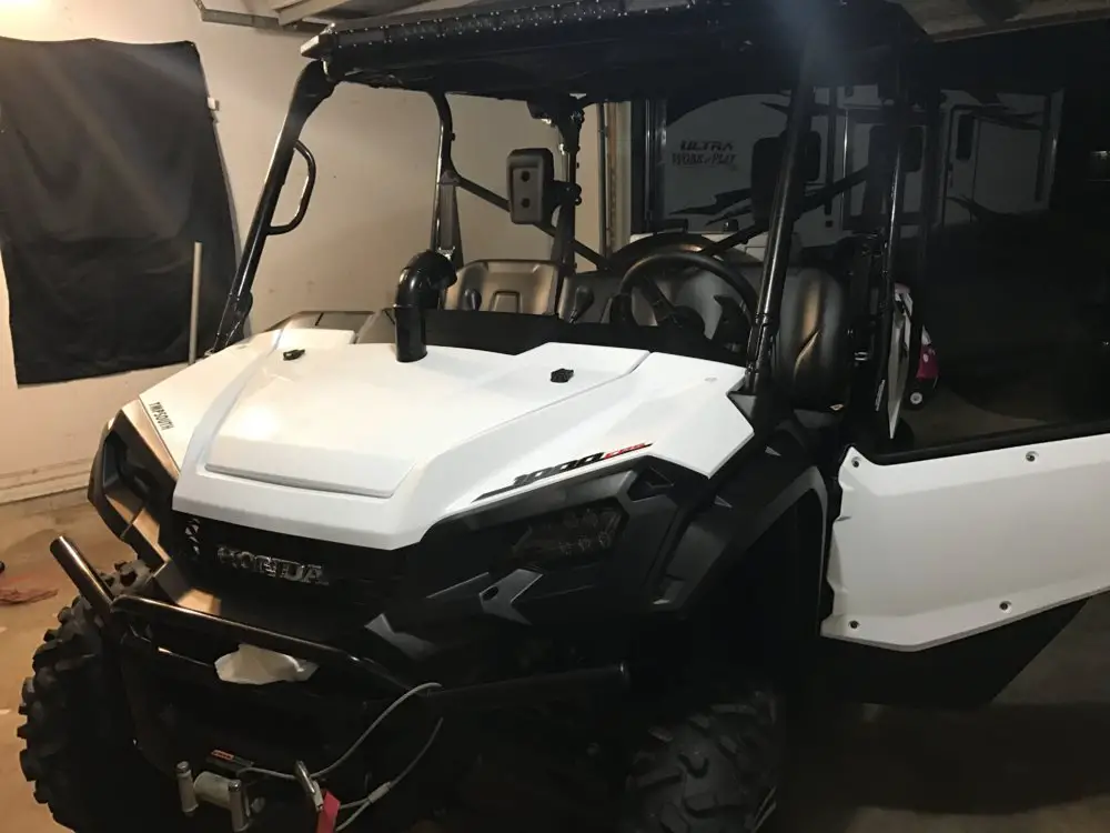

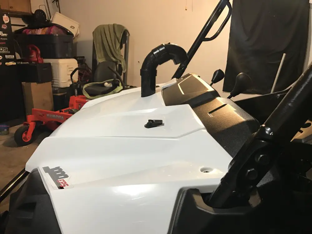

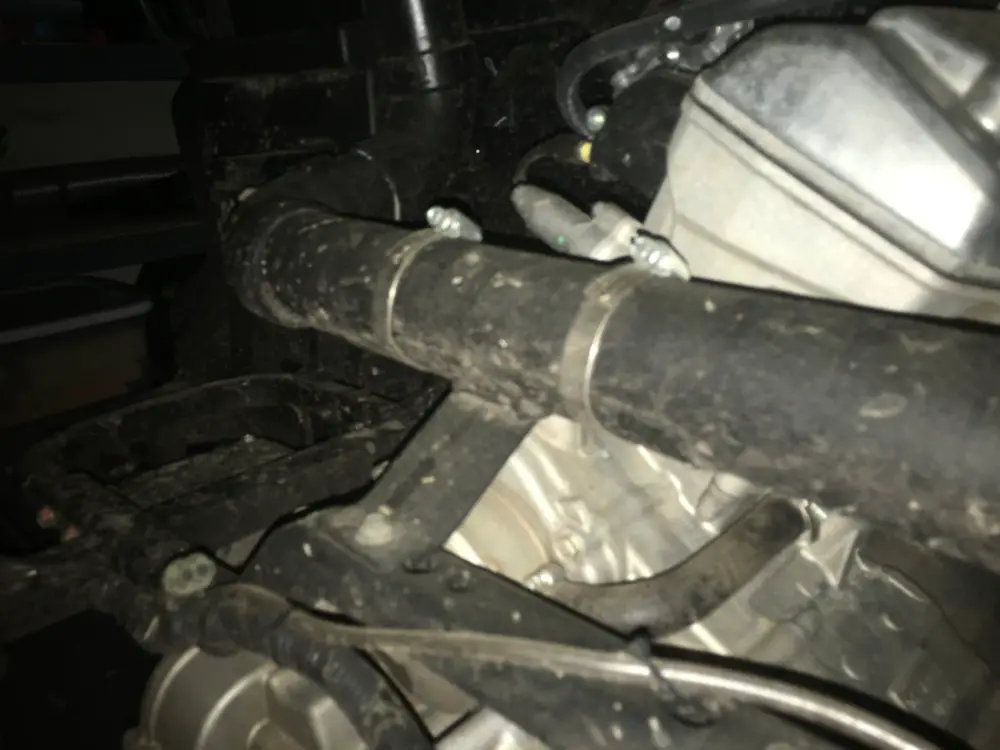

Here's a few pictures of what I come up with for a snorkel
IMG 0073 IMG 0075 IMG 0078 IMG 0072

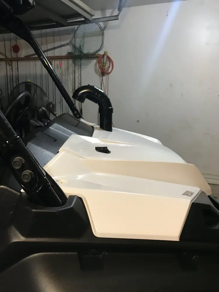

2016 Pioneer 1000-5. Used 2 in pipe. Cutting plastic was required. Bed works like normal. View attachment 18880 View attachment 18883
Is there any chance you have pics of what you had to cut? This is EXACTLY what I want to do to mine. Best I've seen in my opinion, no offense to anyone else. Only thing I wonder is if using the 2" pipe will make any difference compared to the 21/2 or 3 that some others are using.
Is there any chance you have a parts list on it? And any "if I had to do it again" advice? Thanks

Do you have any pics of what you cut on the bed for your snorkel? Weighing between your setup and one that M1MS has. I really like the look and fit of that and I think it will be more beneficial than the stealth under hood way I was leaning. I've read too much about the really hot air coming from the dash area, and that makes me wonder if it's a good idea to have the air intake up in there sucking in that hot air. Just realized the one M1MS has is on a 1000-5 and mine's a 1000-3 so I don't know if that will make a difference in fitment or routing.
Also, not sure if you have posted it anywhere already that I haven't seen, but do you have a parts list of what you used? And like I asked him, is there any "if I had to do it again" advice you would give? And finally, do you think the 2" pipe vs 2.5 or 3 that some others are using makes a difference?
Sorry for all the questions. I'm new and this is my first SXS so I'm just trying to get it all figured out. Dang thing is too expensive to let something stupid happen from a less than optimum design from the factory.
