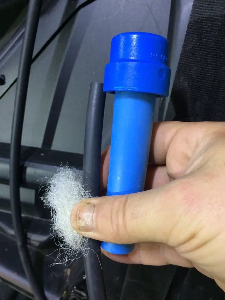

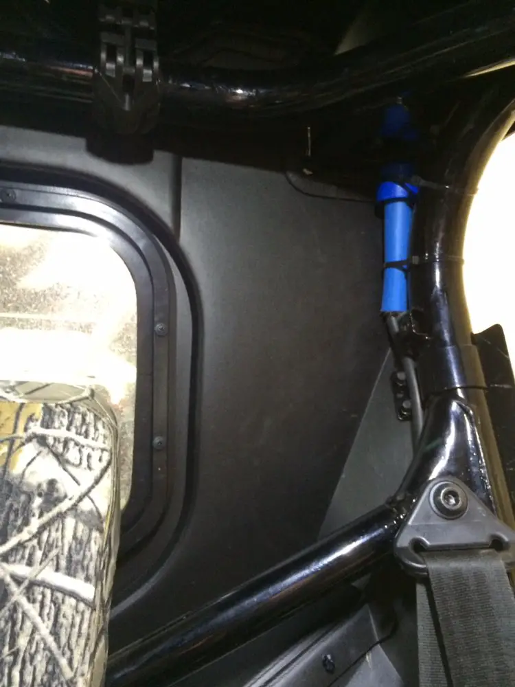

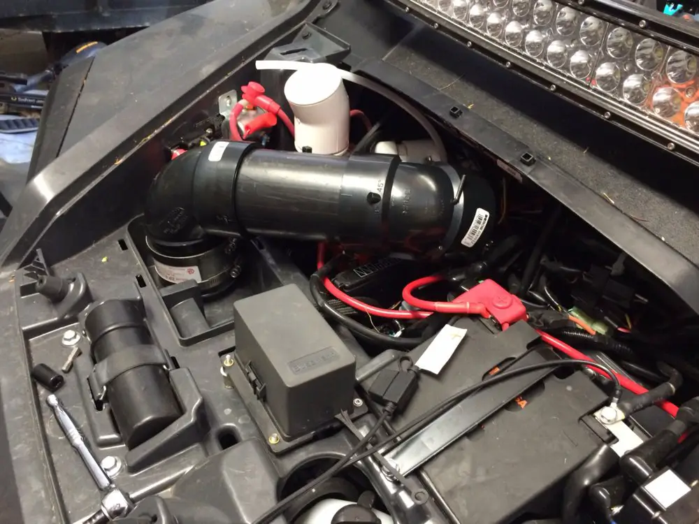

Not much of my own ideas here - just a frankendesign using other peoples ideas.
IMG 3109 IMG 3112 IMG 3120 IMG 3121
I tied all my vents together and ran a single hose up behind the drivers head. Terminates inside a capped irrigation pipe with some filter material to keep junk and bugs out.
Ran another one behind passenger's head for the gas tank vent.

Ghost....can you get that capped irrigation at Home Depot or somewhere similar? I purchased the tubing and splices, just need to figure out where I want to run them. Thanks,
ghost
ghost
Dec 4, 2015
993
1,874
BC
The only place I've seen the blue stuff is at my local irrigation store.
But 3/4 or 1 inch pvc with an end cap would work fine too.
FYI - if you're planning an irrigation project the Blu-Lock pipe and fittings are amazing. More durable and much easier to use than pvc or black poly.
Hydro-Rain :: Professional Irrigation Products :: Products
