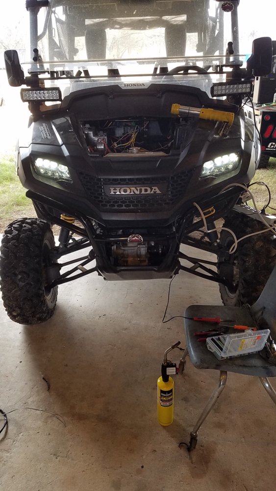

Thanks Tflynn, I wasnt real happy about the way the plastic turned out. But after reheating and a little work with a small hammer and I was able to smooth out the plastic. I used a wet terry cloth to cool after heating, dont use a rough cloth.
Sent from my GT-N5110 using Tapatalk
Yeah I know what you mean, even though no one else will ever see that plastic you'll know it's there! I actually thought it turned out pretty good and using the trailer ball to form it was very smart.
Thanks, a little dirt and they will be fine.

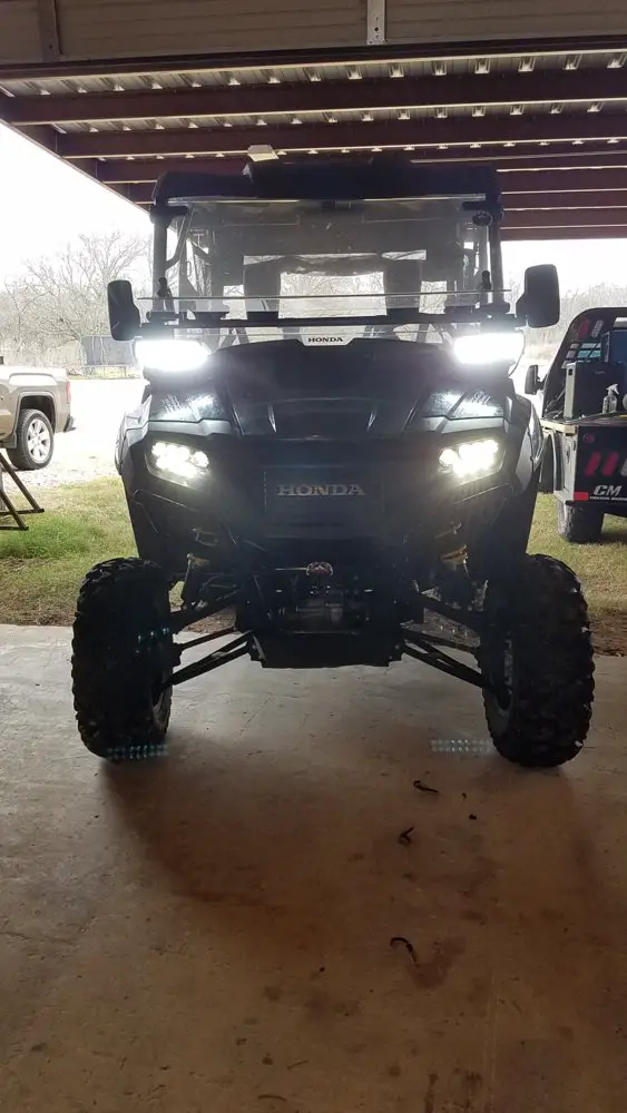

P.S. they work great! The light is even and spread out on low. On high they are focused high and to the center.

They sure turned out very well. Just ordered the flares, but these will be on my to do list. Like I said earlier, thanks for doing all the leg work.
